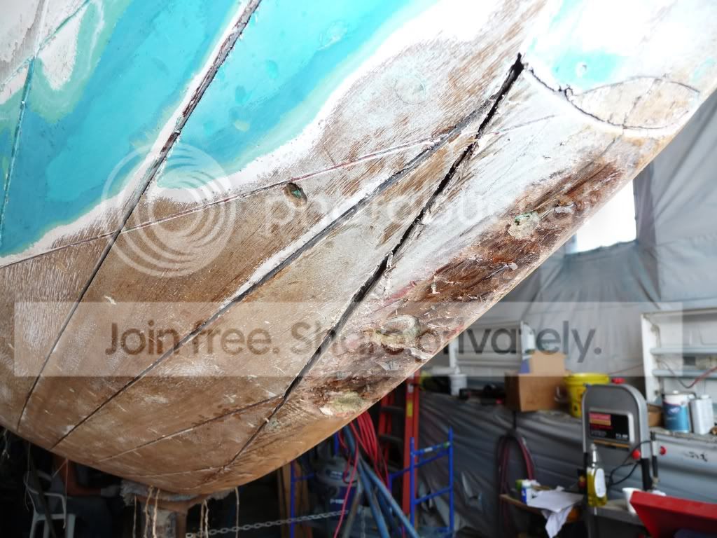

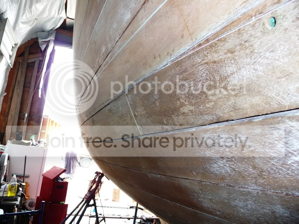

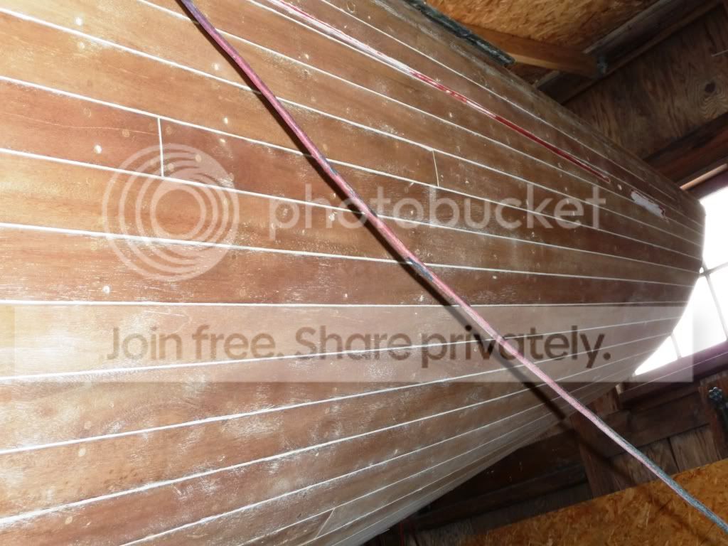

Time for the weekly update on Lady J. The Port side of the hull is paint free the old fashioned way, heat gun and scraper followed by long-boarding with 220 grit.
With her in the shop, it's impossible to get a side shot.
90% of the seams below the waterline are reefed and clean.

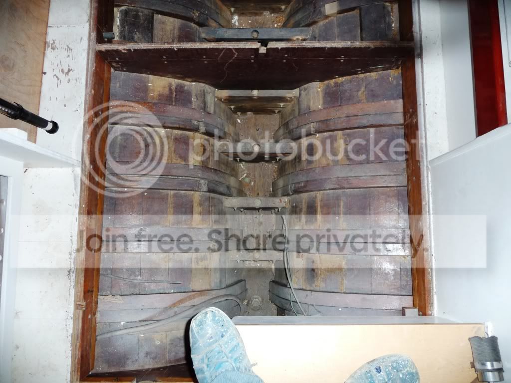

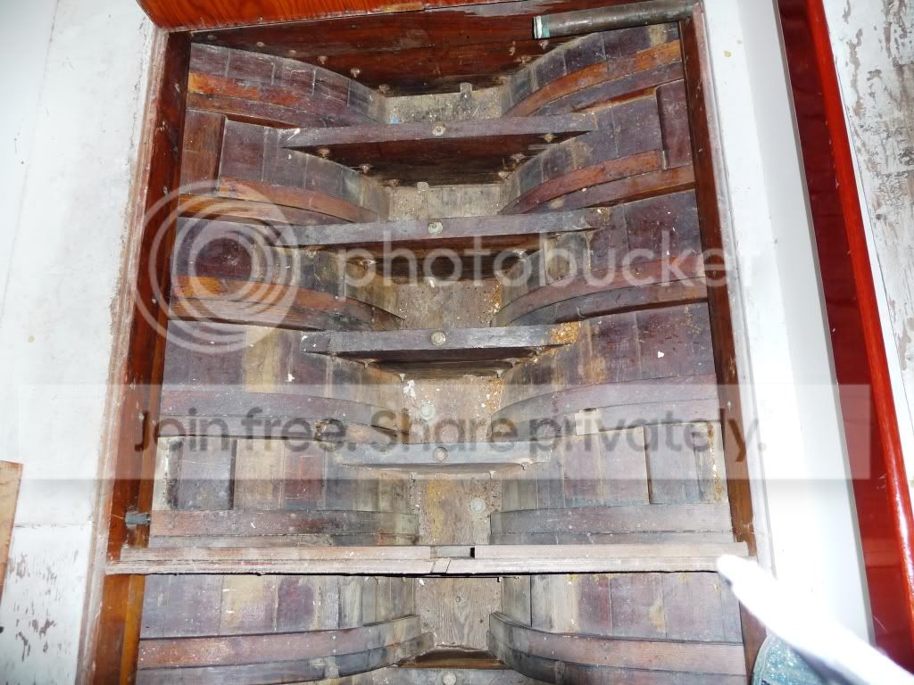

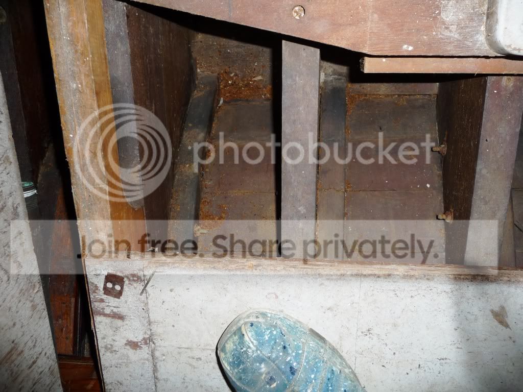

I did find freshly cracked ribs from the transport.
The other bilges are full of broken but sistered ribs. I haven't decided whether to fix these or leave them as they are. It's up to the customer.

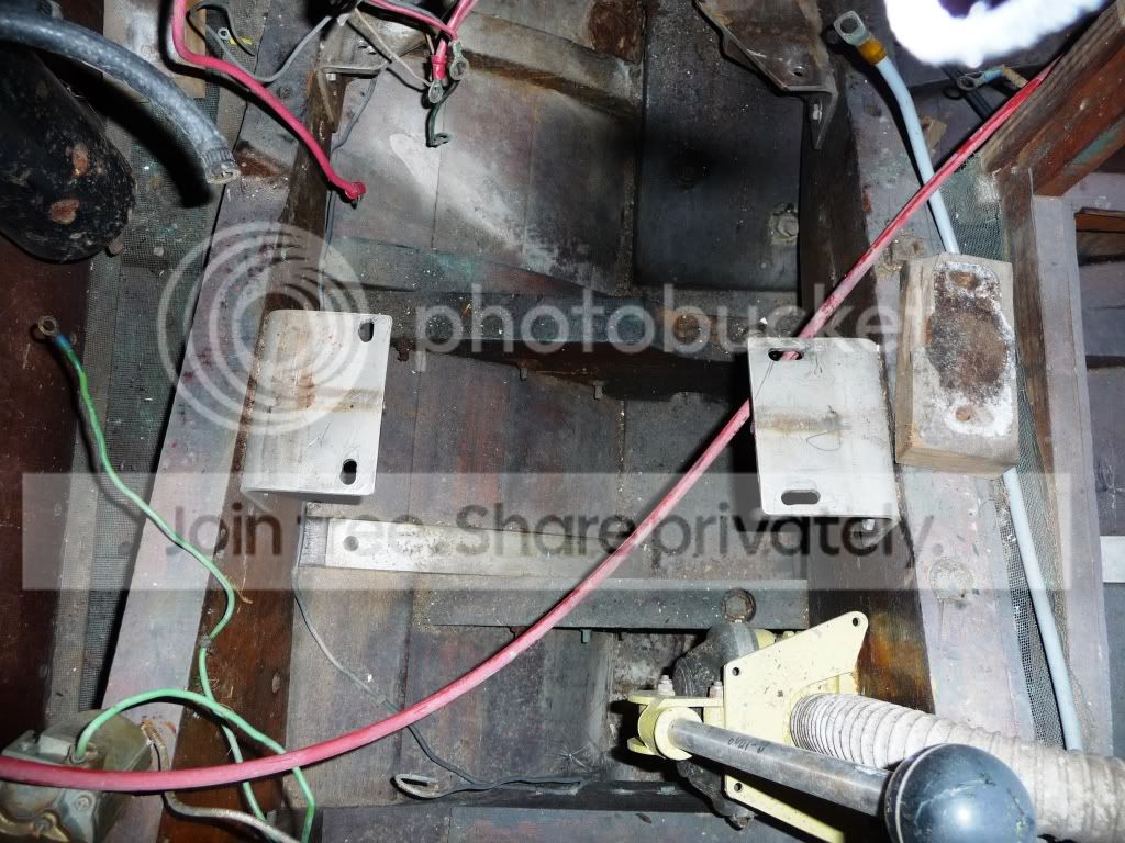

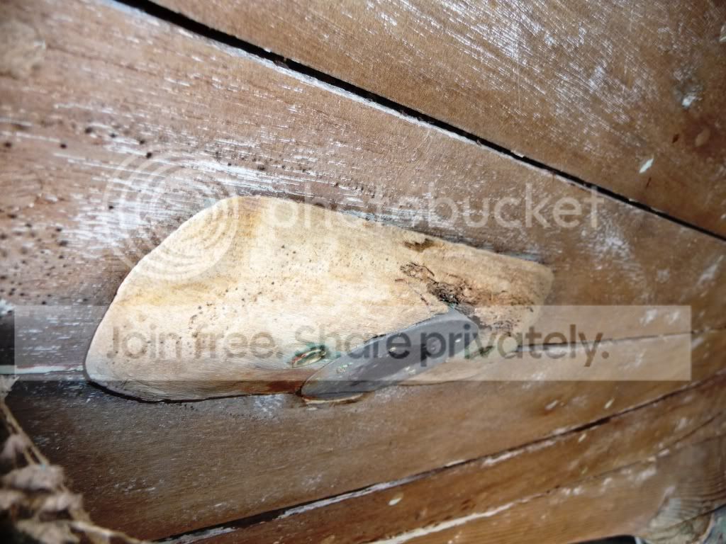

Now that the engine is out, I can see a couple in there too. Two have a strange fix already. Somebody took a SS band, bent it to fit on the broken rib and bolted/screwed it in place. The only issue I have with that is that they mixed SS and Bronze in the same piece and the floor bolt only a few inches away is galvanized.

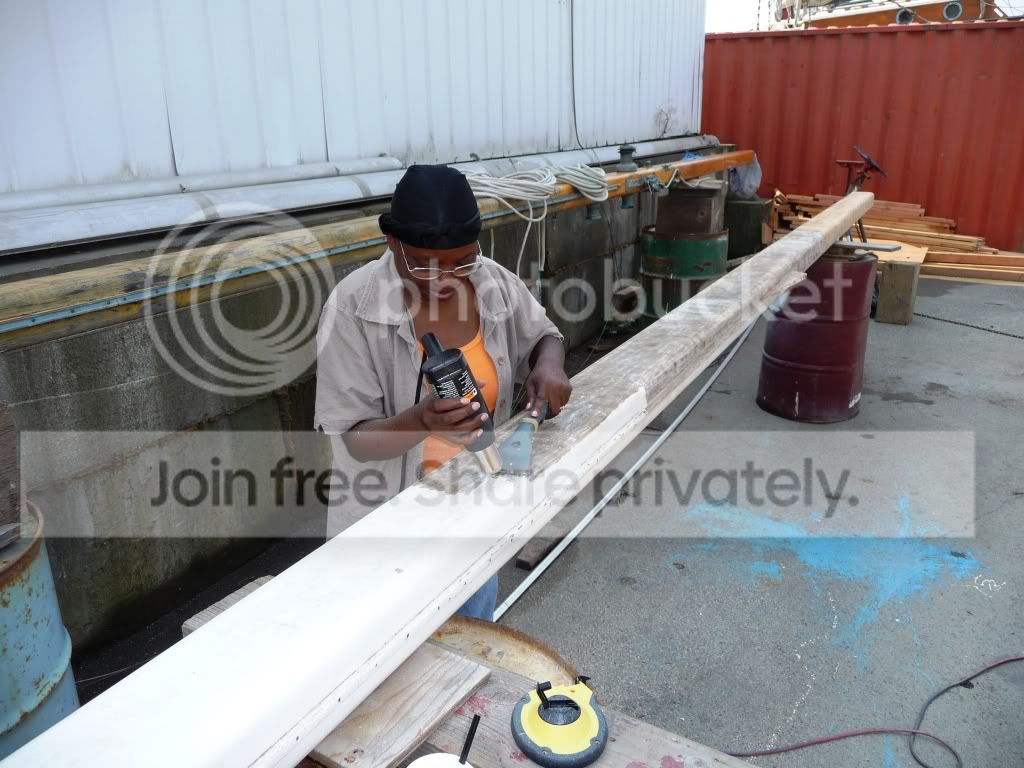

My wife Fredia came by to help this week. She was on the mast.

I am astonished at how thin the ribs are compared to the planking.
Ross
Jun 15, 2004
14,693
I guess that I was expecting them to be nearly square in cross section. I presume that they are stream bent in place?
May 5, 2006
1,140
Knutson K-35 Yawl Bellingham
Yes they are. I've got quite a bit of work to do on them. I may pull the sisters completely, depending on customer wishes.
