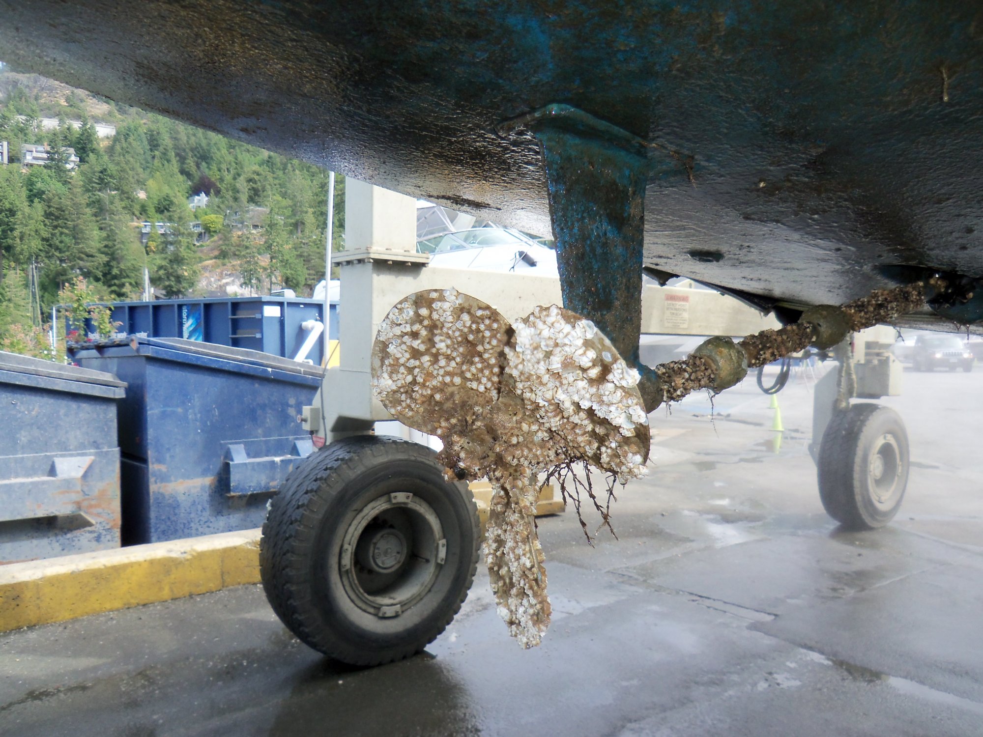

My bottom remains clear of marine growth throughout the season, but I did see a lot of barnacles on my prop, when the boat was pulled in November. There has not been a problem with the engine, nor with vibration. During the winter months when most boats are on the hard, I have noticed that most have three-blade props. Very few with two-blade. Also, I have read that speed does increase and handling, particularly when backing-up, is much more responsive. Part of the reason that I'm only getting 5 mph is that I'm afraid to run the engine

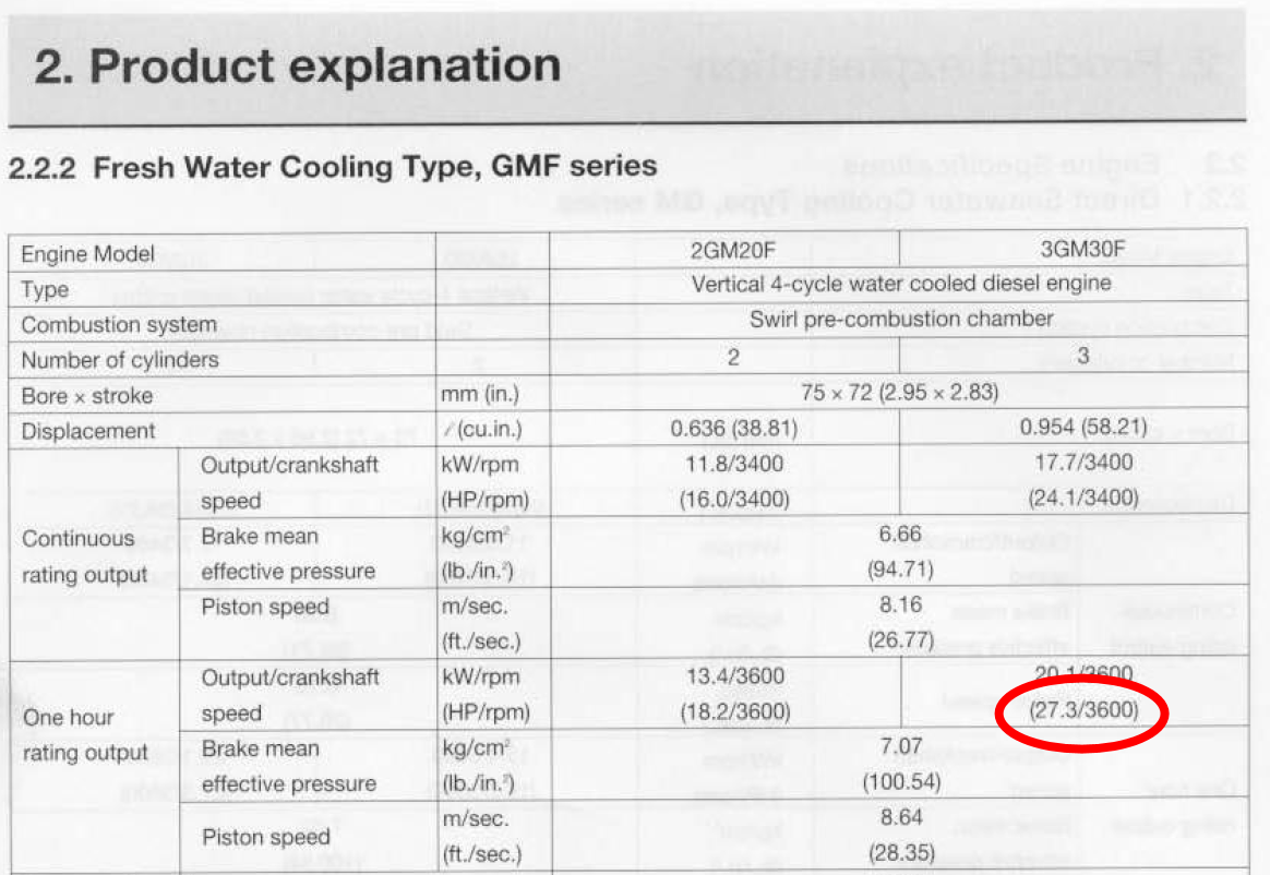

You should be cruising at a higher RPM like around 2800. But first you might want to purchase a cheapo laser Tach and check the accuracy of your tach. Diesels love to work not be babied.

"but I did see a lot of barnacles on my prop"
This will definitely inhibit your speed, the prop needs to be clean.
Jan 4, 2006
7,870
Found this one spring (but never again) and it almost stopped me from making the 1,000 yards to the lift for the annual haul out:
Barnacles will do that.
There is a problem with your boat. Keep digging and you'll find it.
