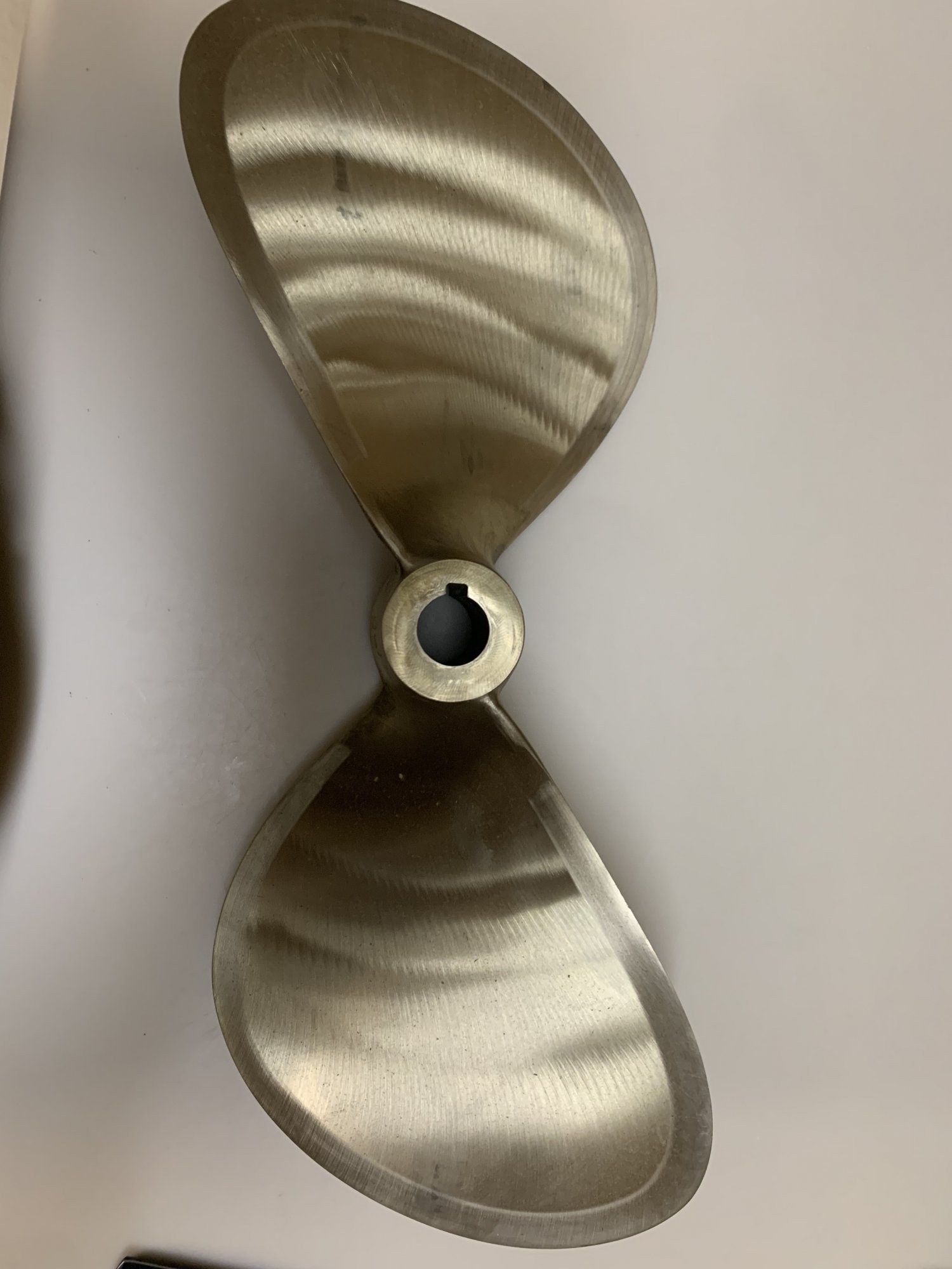

Guess what arrived yesterday from SBO?
It was re-pitched to 18x16 RH.

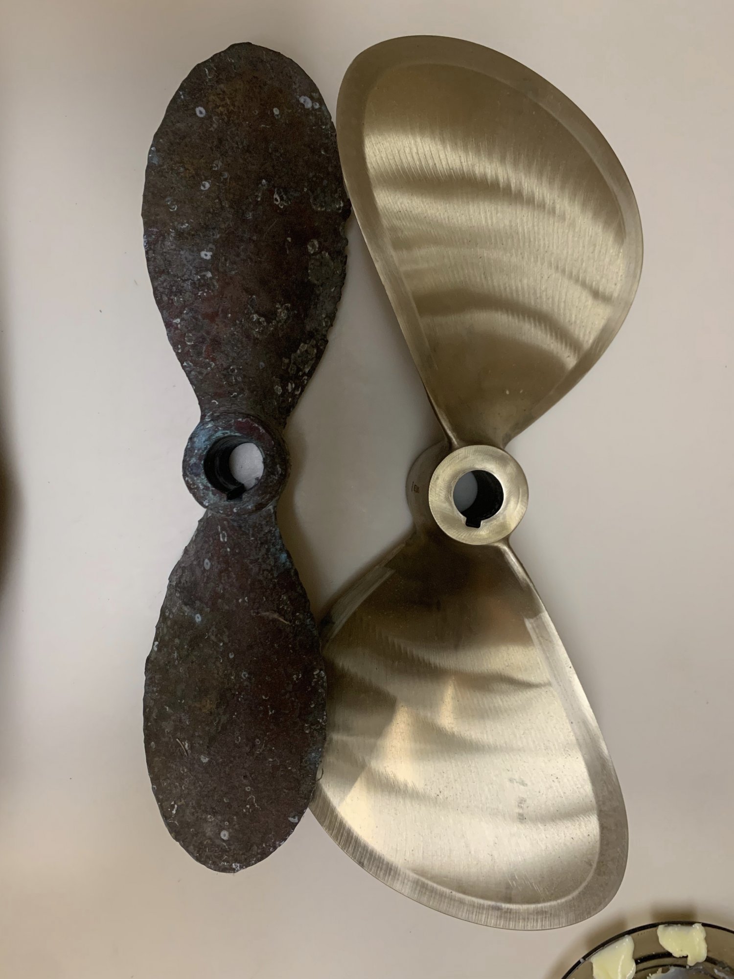

Boy how propellers have changed [1998 vs 2021]. Here is the OEM 18x17 comparison.
The butter on Bottom Right will not be used for barnacle prevention.:cowbell:

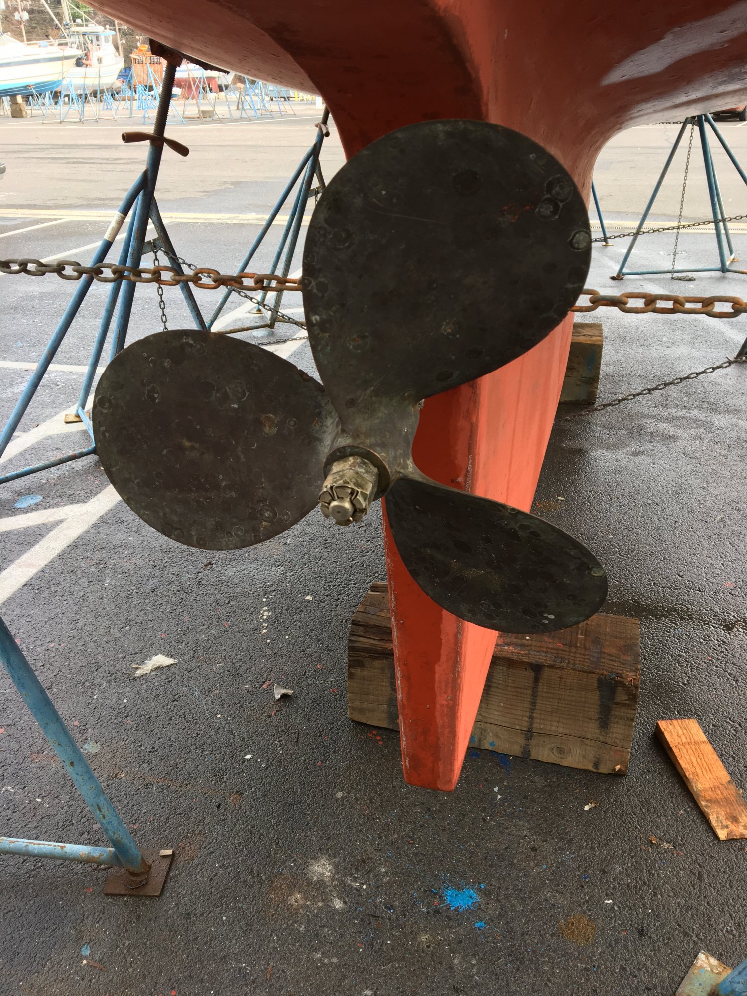

My boat came with this prop.
The boat had a lot of prop walk. It was manageable. I could spin the boat in it's own length. A lot of vibration and noise while sailing. When I opened the throttle the boat would suck down like a wake board boat. The exhaust hose normally about a foot or so above the water line, would suck down below the water. When I returned from a cruise there was always a diesel line of black across the transom.

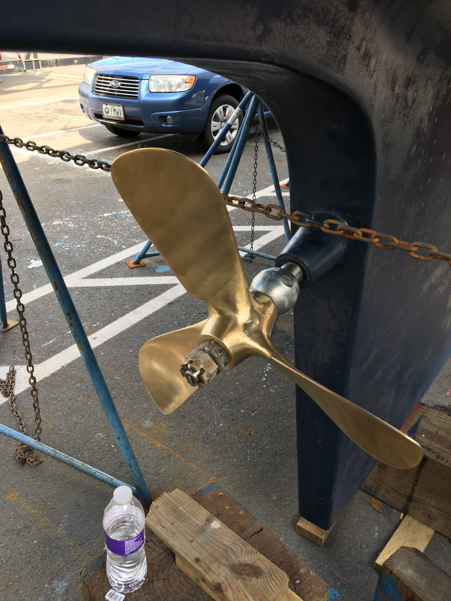

After a couple of years I decided to seek a better way of powering the boat. Research lead me to the CampbellSailor. I contacted Kelly at WestByNorth and he asked a ot of questions about my engine, transmission, spacing from the shaft to the hull bottom etc. 3 weeks later this beauty arrived.
Oh what a performance difference. Faster under power. No pull down of the stern. No more black soot line. Faster sailing speed, and no noise/vibration when surfing down wave fronts.
I am a believer. Having a good prop in waters that challenge you with tidal currents of plus 12 knots requires a good engine and matching prop when under auxiliary power.
