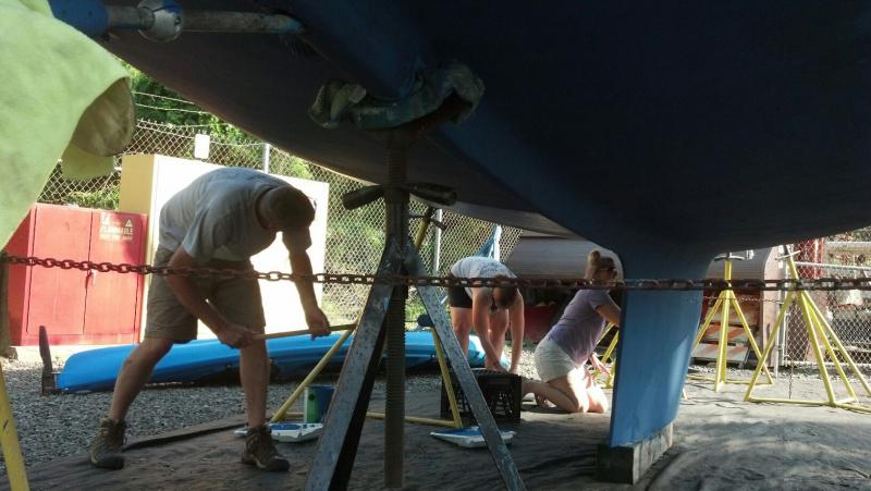

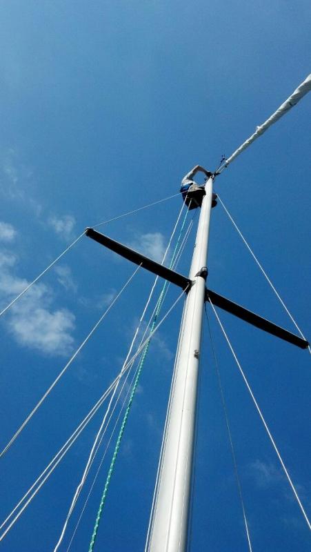

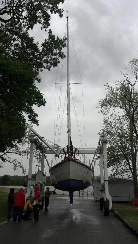

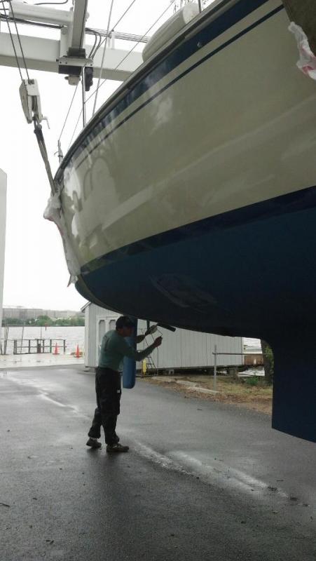

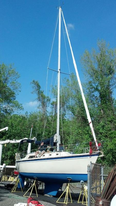

After some prep work, our haulout went without a hitch. :dance:
I had 6 volunteers over 3 days helping me with the effort. I can't thank them enough, though it is amazing what pizza and beer can accomplish.
I also need to thank MaineSail and Stu Jackson for their guidance and expertise. Gentlemen, I owe you a beer or two at least.
While there are a few little things left to work on (aren't there always?), it is now time to go sailing!
Work completed:
ü Bilge Pump Float Switch Installed
ü Bilge Pump Controller Installed
ü "Spot Hug" Installed, fused and wired to battery
ü Tank Monitor Installed
ü VHF relocated
ü GPS 3206 installed at nav table
ü GPS network hub installed
ü Sonar installed
ü GPS wiring updated
ü Fuse block for low amp electronics installed
ü Ammeter removed from Engine Panel
ü Fuel pump relocated
ü Starter/Alternator/Charger Engine Wiring harness replaced
ü New Alternator Installed
ü New Regulator Installed at Engine Panel
ü New Voltmeter Installed
ü Galvanic Isolator installed
ü New C/B for Air Conditioning
ü Cockpit 12V receptacle installed
ü Water Heater hoses
ü Water Heater Anode
ü Intake and Exhaust Fans
ü Cutless Bearing pulled
ü Shaft Zinc replaced
ü Prop pulled, balanced, cleaned
ü Stuffing box repacked
ü Topsides waxed
ü Bottom Painted
ü Life sling installed (new case)
ü Keel faired (minor chip repairs)
ü Mast wedge replacement installed (spartite)
ü Masthead lights replaced with LEDs
ü Rigging adjusted/tuned/pinned
ü Teak Stripped
ü Nonskid waxed/sealed
ü Cockpit waxed
ü Nicro Solar Fans installed (1in 1out)
