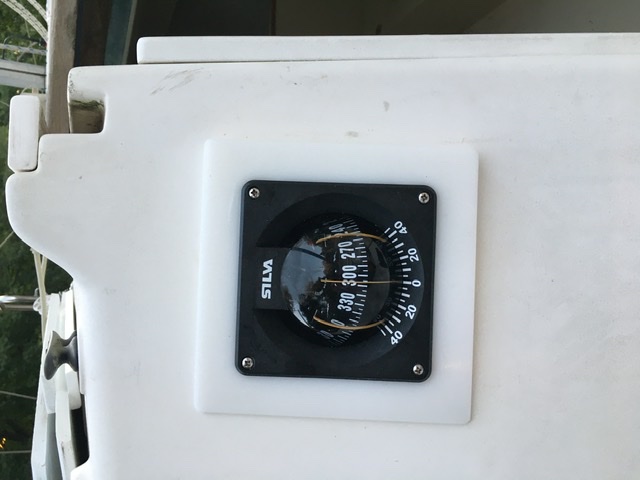

Today I finished installing a new compass and deck connector for the masthead light. The compass replaced the identical model, so I didn’t have to worry about recutting a hole. I was planning on bolting throughThe bulkhead, but went with an alternative method, taking a cue from Hunter. I used epoxy putty to secure pieces of aluminum between the cabin liner and the cockpit bulkhead, which I then drilled and tapped, to screw the compass to. I tapered a 3/4” thick piece of HDPE to put behind the compass to align it with the centerline of the boat.

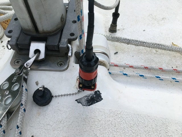

The deck plug was replaced with a more robust, solder on connector.
