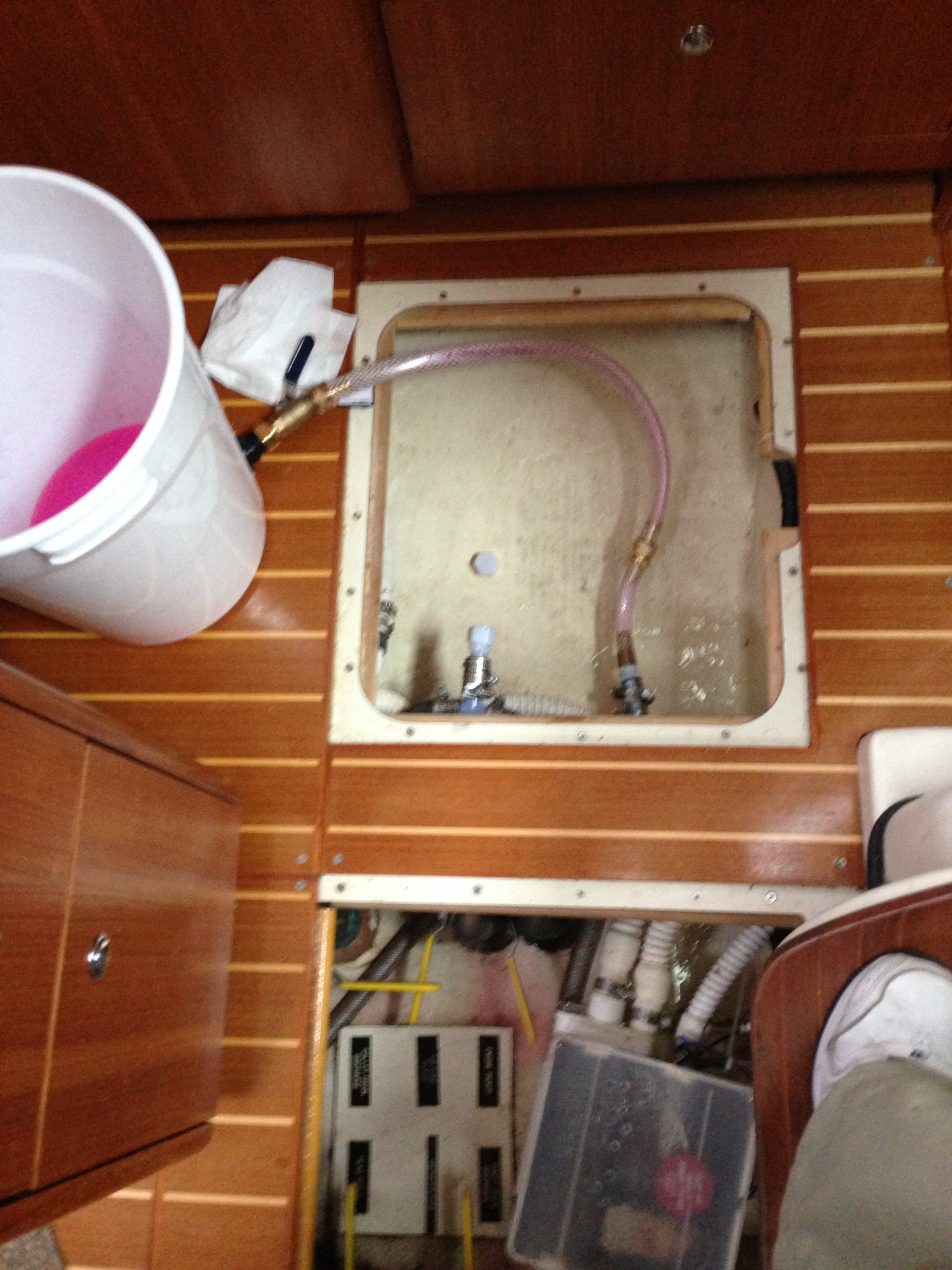

Groco makes a fitting for doing that. It's in various diameter and will take a garden hose fitting. We use it to charge several systems that are manifolded together (2 AC units, water maker, and refrig back-up condenser). IT's convenient. However, the fittings are bronze and Groco -- they're not cheap.
Mar 3, 2003
710
Hunter 356 Grand Rivers
Get a 5 gallon bucket, put a valve on the bottom, a swivel, and T your intakes to all thru hulls. Run the pump until it comes out discharge or about 1 gallon and you are done. One person, easy to do.
Likes: thinwater
Mar 26, 2011
4,016
Corsair F-24 MK I Deale, MD
^^ Exactly. I actually use a fridge bottle I had (came with a valve), but same idea. SO handy, so easy.
