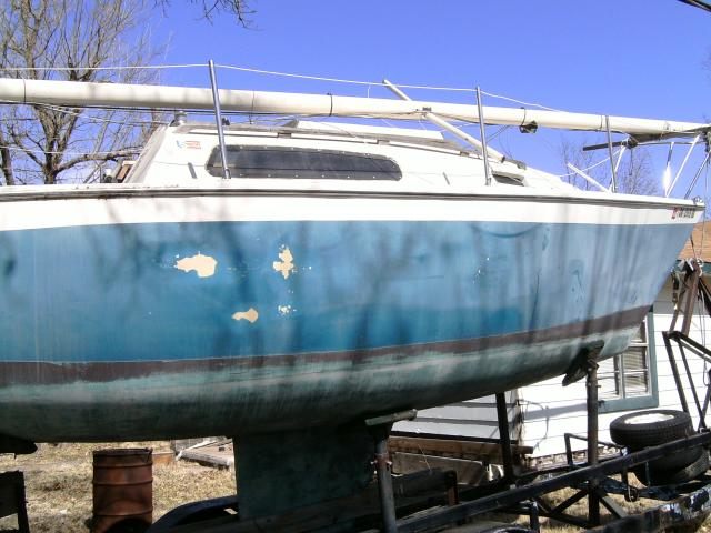

Here she is; The Latest Project (1982 US Yachts 25b - Name To Be Determined)
There's alot to do but I'm looking forward to it (Even the Admiral is excited).

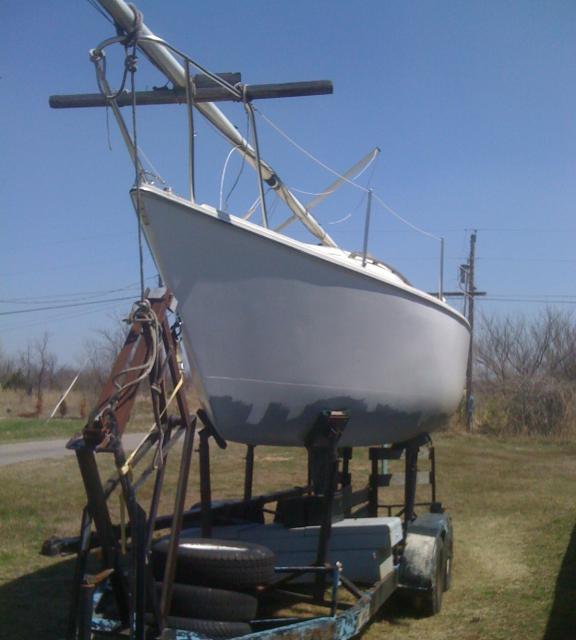

Well, after some arduous and annoying work, the hull is filled and faired. Gave everything time to cure and have it sanded down. Maybe this weekend (if the weather holds) I can sling paint. Everybody cross your fingers!

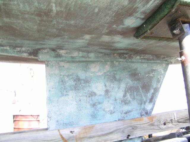

In another vein; I have discovered that the keel on this thing is bolted on but is not "hydrodynamically" (is that a word?) faired to the bottom of the hull. Seems to me I could cure some of the pointing problems associated with this model by glassing in the keel to create smoother waterflow. Anybody got a comment on that one?

The hull is barrier coated and primered. Thinking seriously about finishing of the new paint job on the hull and then making the rest of the repairs floating.

I wouldn't think glassing in the keel joint would have much benefit. Some maybe, but not sure it's worth the work involved, but it would look less clunky. Other than that the boat has good looking lines. Sure wish these had a saildrive or propshaft so you could get that OB off the back. For that matter all our smaller boats would look better without the OB.

Might a fairing compound be what you want for that keel joint?

As for the keel, I don't think it would take too much work to fare in a smooth joint, one or two evenings of work could probably finish it off, but you're going to go through $100+ in west systems products to do it. I don't know if you'll really gain much beyond a nicer view when she's out of the water. I doubt that costs you more than .1 kts, so unless you are racing, you'll never know the difference.

Thanks for the comments guys (no offense intended to anybody but special thanks to Phil). I'm not afraid of her it just seems to be hard to get credible information on 'em. Since you have owned and sailed one your opinion holds water (pun completely intended) a little more than others, again; no offense. And as far as that keel is concerned; I've made up my mind to leave it be and go sailing. I've got enough to pull off on this one without inventing work (seems to be a common theme of the responses that I'm not really gonna gain enough to justify the work and/or expense). So that's that. Now to get that shiny paintjob like Phil's...............................

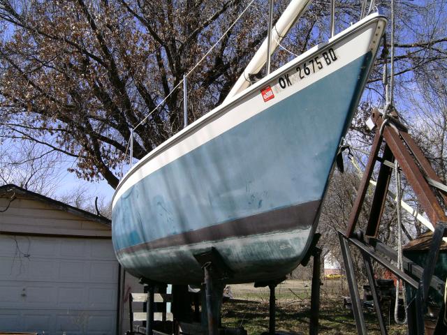

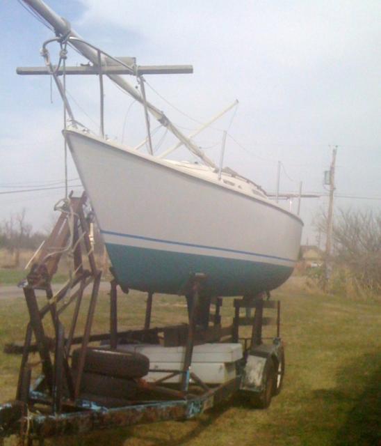

Thought I'd post a couple of pics to show the work as it goes;
The first is right after we got the topsides painted (many many thanks to the admiral as she worked like a trooper).
The second is after the hull paint went on and after we got the stupid blue tape to run in a something-resembling-a-straight-line so we can paint on the waterline stripe.
Just thought I'd mention here that I have (in the course of this project) become a fan of Trinidad SR Antifouling paint, stuff goes on pretty easy without alot of fuss or hassle (this does not include the mixing, remixing, and mixing some more to keep the stuff from settling and/or seperating).

Looks good!
I know it's not much help now, but after I did the bootstrip on my Gulfstar (kind of curved up midships) and long after the boat was back in the water I got my first laser level. I think a painter could mark a pretty good line at dusk with one of these!

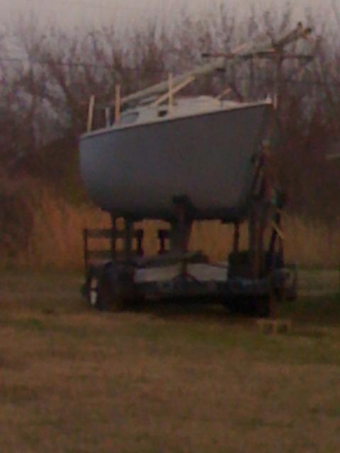

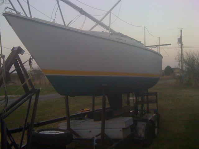

Here we go with another update:
A little more paint is on and we are getting close to launching.
