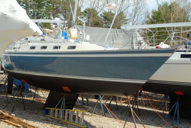

Hi All, I've not been around as much lately because it's "work on the boat time".. For my latest project I installed eight New Found Metals stainless steel portlights. The transformation from the old plastic Beckson portlights to the NFM portlights is even better than I expected. They are not cheap but when the price is compared against their plastic counterparts they actually become quite a bargain. The NFM portlights are very, very well built and made from solid cast & polished 316 stainless steel. These are not cheaply made stamped frames! The thing I really like about them is no visible fasteners on the exterior of the portlight.. The biggest benefit I had never counted on is the additional light in our cabin. It's like someone flipped the light switch. I guess there is a visible difference between real glass and tinted plastic.. If you're interested in how to do this install you can read my latest "how to" here: http://www.pbase.com/mainecruising/nfm_port_lights

What a great upgrade! I've seen the NFM products at the boat show, and they are really nice. Did you consider at all their Tri-matrix port? BTW - You have an out of place photo of your deck hatch on page 2. But I like that too, looks like you did some polishing on the plexiglass.

I did not want the tri-matrix ports and felt the solid stainless ones would be both better looking and longer lasting. I was not necessarily looking for a rock bottom price and was looking for an upgrade and bullet proof ports.. BTW the photo on page two is there to show the before and after between the port and starboard cabin sides after polishing them while the ports were out..
