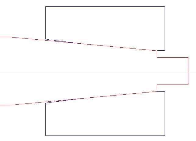

Well here's what I ended up with (very exaggerated):
I never had this prop off except the first winter when the yard pulled it to replace the cutlass and put it right back on. I had it reconditioned and balanced this winter.
When lapping it, I was only seeing honing marks on the rear third for a considerable number of turns. Pushed on hard with a dry fit, it would wiggle slightly when the blade tips were pushed on.
By the time I got the surface patina removed for 75% of the hub length, the step had developed at the rear end where the hub overhangs the shaft so no lapping compound can act on it. The fit is now OK but the step will prevent the prop from moving forward on the taper when the nut is taken up.
They are just going to ream enough to take off the step at the rear. A little additional lapping and is should be good to go.

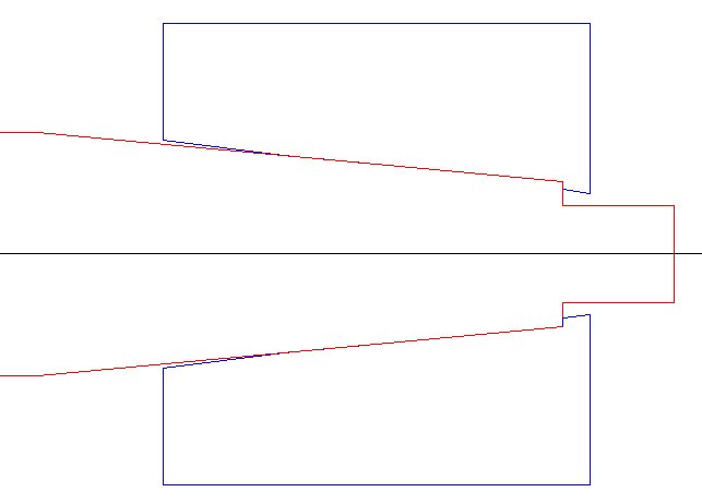

After some frantic thought, I came up with the idea that should have occurred to me when I was standing in the neighborhood machinist's shop two days ago with him explaining that he didn't have any prop tools. I suspect strongly that drawing the diagram for this thread clarified my thinking. Drawing things out always helps.
I called the machine shop as soon as they opened and told Steve I had an idea how to fix it faster and simpler than we had discussed and not risk screwing up the nice lapped section I already had. He said they had already figured out a way. They would machine a plain steel shaft into a dummy shaft taper and I could use that as a lapping tool to remove the step.
I said, "No, do it like this(long explanation since this was by cell phone)."
A straight, cylindrical bore of the diameter at the corner of the shoulder introduced by honing. It could be cut with a straight hone or in a lathe. Since this part of the hub overhangs the shaft, the taper is unnecessary. Making it straight means I could do extensive further lapping without a shoulder developing.
