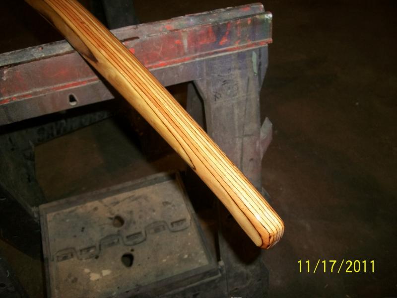

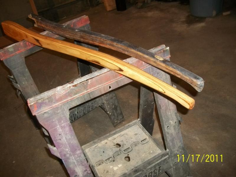

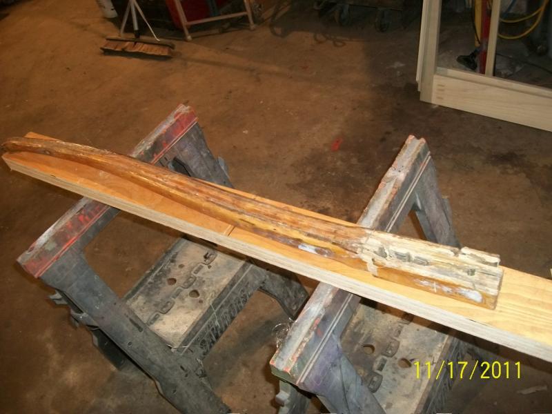

Needed a new tiller as the old one had delaminated and broke on my initial voyage (slight concernation being I was in unfamiliar waters)
I picked up a piece of "LVL" or "microlam" manufactured wood from the lumberyard..
Traced and cut the blank then routered and sanded to shape...
Just started coating with spar varnish...will sand between coats and end up with several on it by the time I'm done...
Only thing I question is the veneers are laid in verticly rather than horizontal...that shouldn't make a difference should it...?
