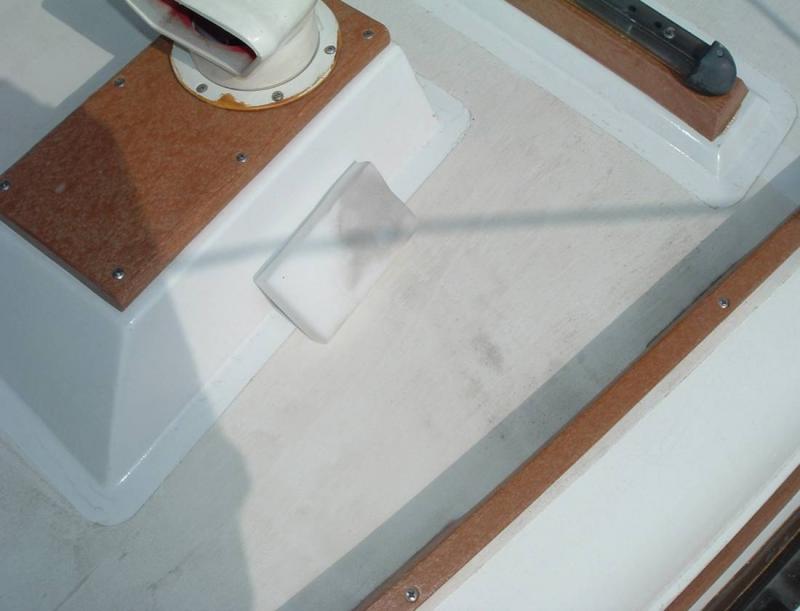

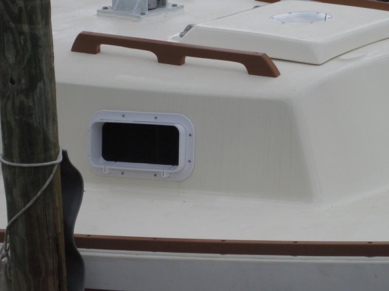

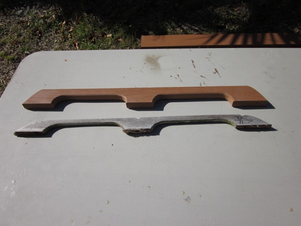

Here is a copy of an earlier post.
Please forgive lousy quality. The solution I used was some leftover Interlux 433.
