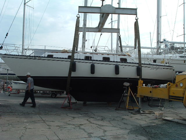

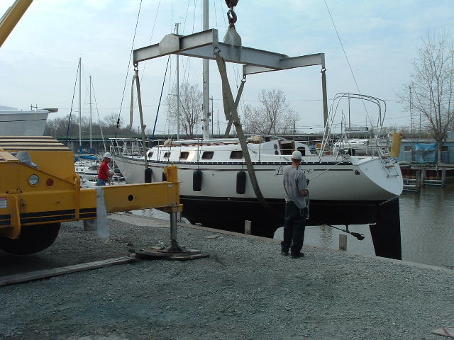

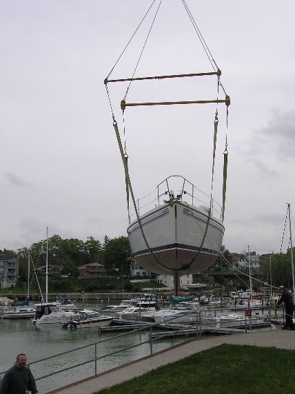

Why not make your TWO spreader bars and give or loan them to your friendly crane company. They probably have these anyway and then enquire if they have any longish strops.
Slinging is easy so long as one has a rope to connect the strops so neither can slip off the bow or stern. Also best to know where the bulkheads and the prop and shaft are - mark the gunwhale with stickers.
A chunk of foam taped round the crane's block helps avoid damage to the mast. Boat mags are full of photos showing boats in slings.

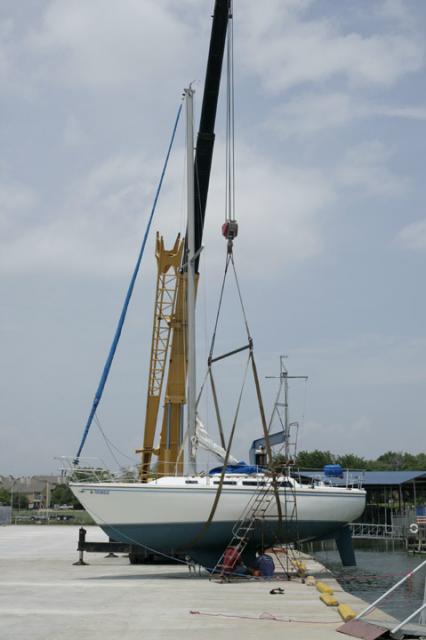

This is just the type of thing I had in mind. Yes, we have about 15-20 sailboats, and hopefully one or two of the other guys would be willing to go snacks on the expenses.
The biggest concern is my design and layout of a spreader bar. I was thinking about one long bar, with straps on both ends. The bar would be in the way of the mast, so I was under the impression the mast would need to come down?

Thanks for the pics, that is just the design I was looking for. Looks like I need to plan on the width a bit wider than the normal boat, and the straps need to be at least 16-20' long at least.

The spreader bars are a must to prevent loading on the hull at the deck level. also plan where the straps go so you dont life it and bend the prop shaft. straps should be put as close to bulkheads as possible.

Google "boat sling" - there are a number of suppliers that make properly-constructed and rated slings with padding and quick-links. At our yacht-club, when we are launching 350 boats with two cranes in a day, the ability to break and reconnect the slings from the ground is important, to keep the speed up.
