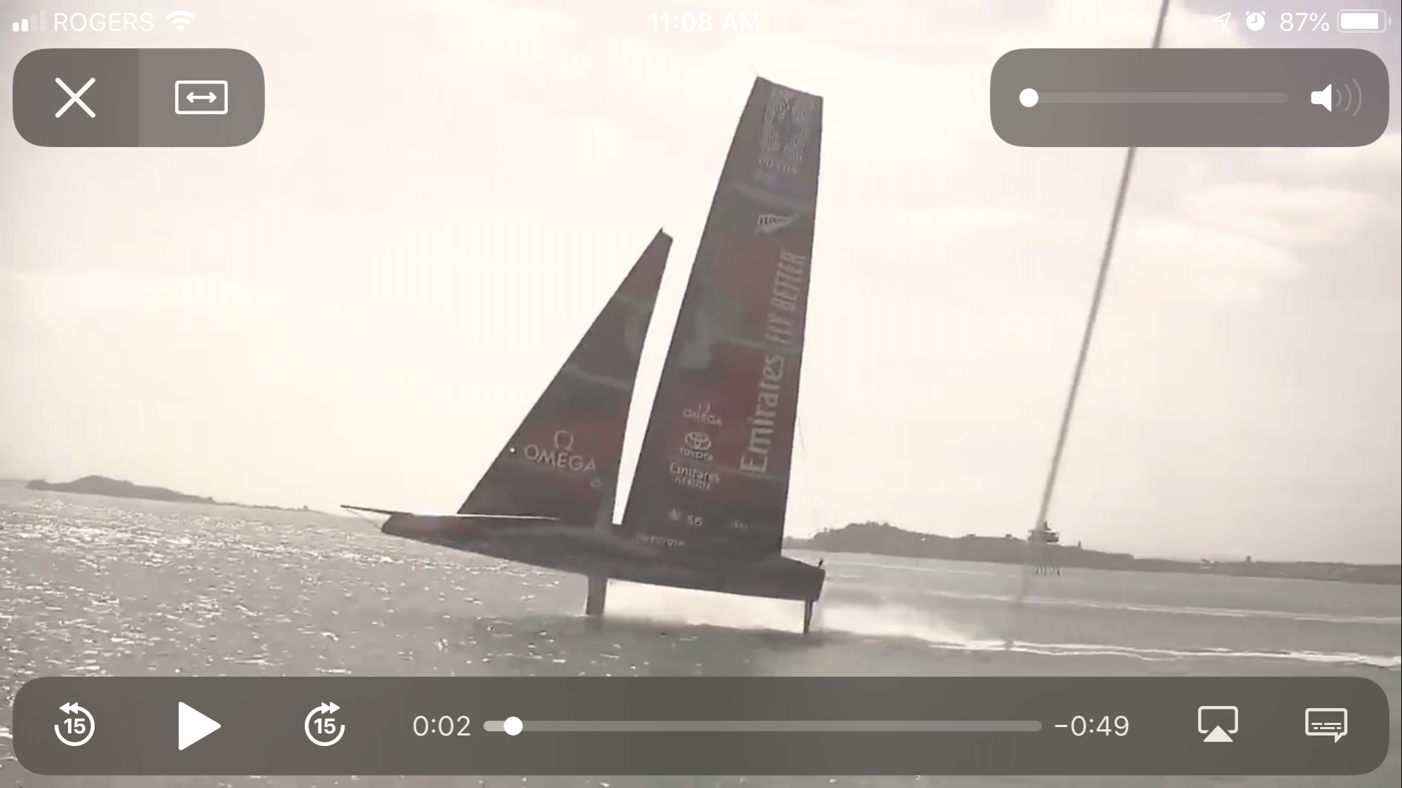

I wouldn't call it instability. They had a situation that caused a slow capsize. If they were all unstable, they all would be doing it. These are new boats and they are figuring out the limits and adjusting to them. Just like anything else that is new.
Oct 19, 2017
8,160
Of course, not being there, we can't actually know, but it looks like she became slightly bow down which caused a downward tilt in the foil angle. The foil slowly dove and lost headway with the increase in drag, pulling the boat over. Does the foil have trim tabs?
-Will (Dragonfly)
Nov 8, 2010
11,386
These boats have limited ballast. They use foils for Righting Motion. That requires water moving over the foil to work. Stop moving abeam to the wind and they have issues. Notice to get it up they didn't pull it sideways (Like you would a dinghy), they pulled it FORWARD, and the leeward foil lifted the boat. They absolutely are not traditional monohull/keelboats... think 'catamaran' and you will be a lot closer. Without a weighted keel, when a bigger cat goes on its side its game over. At least here you can pull it forward!

I don’t have much foiling experience other than recent learning on my windsurfer. At least one of my crashes was the result of a fast rate of climb that caused the foil to either breach the surface or “cavitate” I was too busy trying not to get hurt to really know. I was in a level controlled flight and weighted my back foot a bit more and boom. VERY fine line once your flying.
It looks like that happened very early in the video, no control surface then a whole bunch in a very short time frame.
I hadn’t noticed about the forward pull recovery.
-Will (Dragonfly)
The rules allow flaps on the main foils which most feel are used to get the boat up on the foils. The rudder foil has to be fixed with no flaps or aircraft style elevator. The rake of the rudder is controllable which adjust the angle of attack of the rudder foil and the stern moving up and down adjust the angle of attack of the main foils. I haven't read anything (probably big secret) on how automated this is. The boat in the video main foil goes up and out of the water due to too angle of attack being to high then stalls due to no water flow. Then the foil goes back into the water at a negative angle of attack that was creating massive drag slowing the boat down and broaching. May have been a test that went wrong.

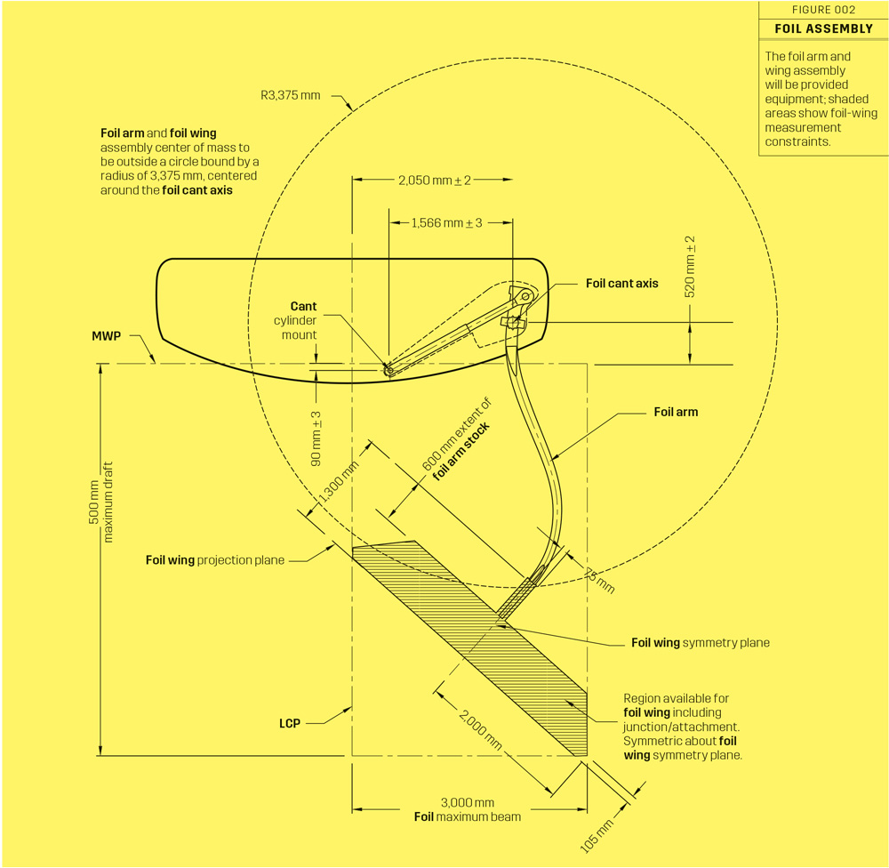

Nov 8, 2010
11,386
To save the teams millions in design and engineering, the AC75 tech committee has designed and will supply the wing arms and the cant actuators as One Design parts. The teams get to play in the gray box shown. The T foils. That is where the race will be won or lost.

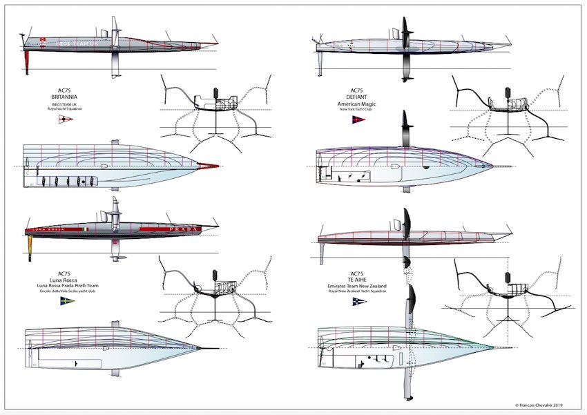

Nov 8, 2010
11,386
The four main players. Note the differences in wing geometry. Less is known about the trim tabs of each team. The hull lines are markedly different as well, but due to how much time these things stay out of the water, its not clear if that will have any effect at all.
Maxdraft is typo (says 500 mm)
