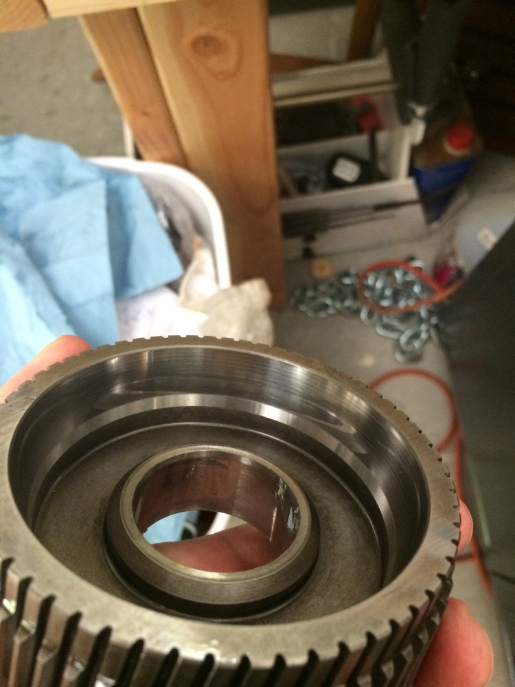

IMG_1123.JPG View attachment 154495 Awhile back I posted about how my crewman had thrown the tranny into gear while the engine was revved up which immediately resulted in a heavy thumping vibration in the driveline. Since then I have replaced the prop shaft, cutlass bearing, damper plate, engine mounts and rebalanced the prop. I have also had the whole thing aligned more than once. This is a Yanmar 3gm30F with a Kanzaki KM3-A (1983) tranny. The situation is much improved but not completely gone. I still get the heavy vibration but only when in forward gear and only when the boat is under way. AND only when there is not too much resistance to the boat's headway, i.e. not too much headwind. Research has led me to a slipping drive cone in the tranny. The question is: Can a slipping drive cone cause this type of vibration? Anyone have any experience with this? I have disassembled the KM3-A transmission and all looks to be in very good condition with the exception of a mirror smooth drive gear surface and the oil was the color of a nice stout beer.

“Mirror smooth drive gear surface”
Do you mean the concave conical surface - the one into which the shifter cone moves? Or something else? How about the shifter cone itself?
You should compare all your measurements with those published in the manual for gear lash, cone dimensions, slot width, etc.
Also the A and C model shifter needs careful attention. Yanmar changed the shifter design in the P model.
The cone surface should have little ridges flat topped ones. Also these cannot be smooth any glaze needs to go but do not reverse the cone orientation.
Consider a consult with a good transmission shop maybe.
It is still possible the vibrations source lies elsewhere something might have been overlooked.

What things did you do when the transmission was disassembled? Did you scuff the cone engagement surfaces of the gears thus to elimanate mirror finish? Did the cone still show concentric flat topped rings? Did you align the shaft at transmission reinstall? If so what adjustments were necessary? And - an important one - how did you determine the shaft was dead center in the stern tube and held centered during the last alignment session?

I have just reassembled the transmission. I have not installed it yet so I don’t know if it will work. I lapped the drive cone against the forward and reverse gears, replaced the bearings and seals. All gears and bearings appear in excellent condition with no sign of wear. No leaks. Prop shaft was aligned and rechecked several times at yard and by me with a depth gauge to within 2/1000 at the flange. She runs smooth as silk when tied to the dock.
