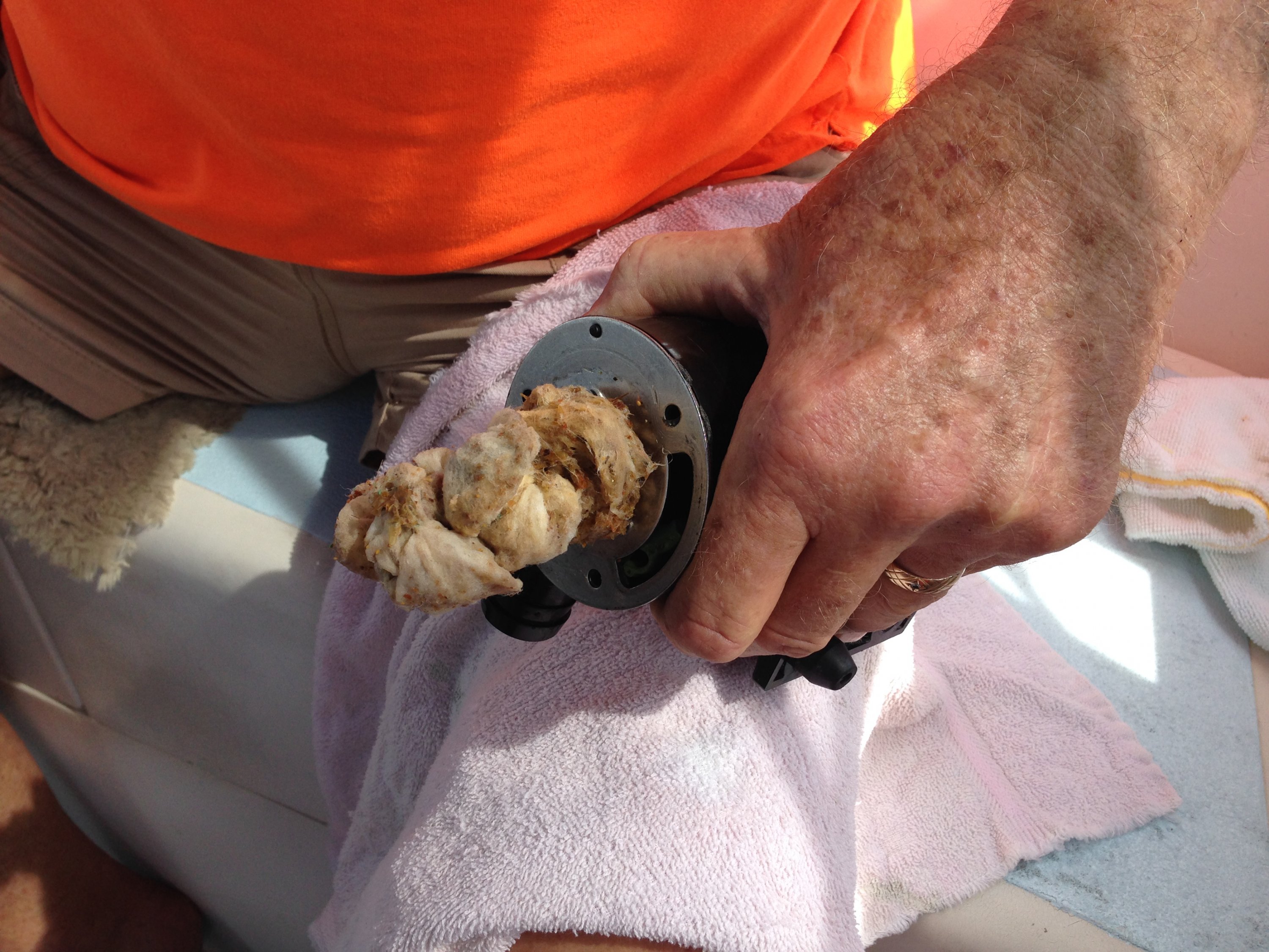

My point is: you CAN flush TP, but not all TP. Premium TP is a bad choice because it's loaded with creams for softness and fibers for extra strength...it'll never break down. Some of the high end all china "thrones" have macerator pumps that can chew it up, but those fragments won't ever dissolve. And I think it goes without saying that wet-wipes are definitely a no-no. I've attached a photo that illustrates what they did to a macerator pump and will also do to a toilet. But there are plenty of TPs that are ok to flush...and you can easily find out which ones are: Tear off a sheet or two and put it in mason jar or even a large glas of water. Come back in an hour and shake the jar or stir the glass. If the TP is still an intact, or mostly intact sheet, it's NOT suitable for use in most marine toilets. But if the water is milky and all you see is "snow," it's the same thing as "marine/rv" TP (for a lot lower price!) and can safely be flushed through any marine toilet.

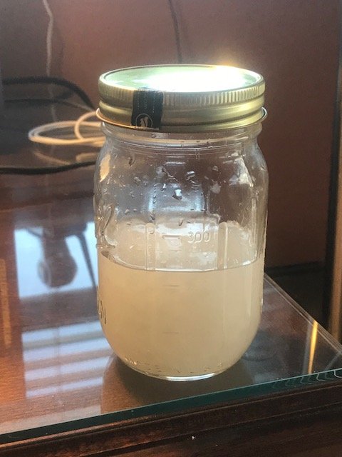

Now Peggie this was an awesome post! I had been told and have used Cottonelle TP for years in my RVs and Boats but never had a means to "confirm" that belief. So I took your post and put Cottonelle to the test and indeed it passed! Here are the results! Thanks

I would never have guessed that Cottonelle would even come close to passing. All the folks whose bums are too delicate and tender for institutional grade TP will be glad to know that.
