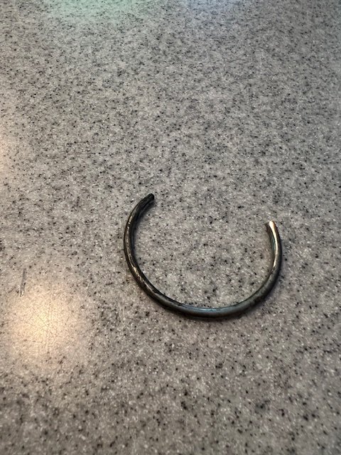

I'm up on the deck this morning fitting a new block for the furler line (yes, after 39 years, a Schaeffer block's wheel will seize, chip etc.) and I see something on the deck that looks like a broken part. Silver dollar sized and C shaped, but I figured iot must be an o-ring that broke and fell on the deck. Aftert some head scratching, it looks like it is an intact C clip (one of 2) that popped off the goose neck (Mine is the French made rig O'Day used in the 80's). So how did it fall out over the winter and should I just slip it on or maybe give it just small pinch in my bench vice first? Anybody had this happen? (I guess I am very lucky it landed where it did!)

I think finding a replacement form a 1985 Isomat system might be a challenge and frankly I don't see much wrong with it. I think I will try pinching it just a tad and stick it back in. Not much to lose I am thinking. It had some grease on it which may have been the problem. The goosenecks on these can creak in the night so to speak and keep one awake so I shot it with some lube. That may have reduced its friction so it could pop out in one of our awful winds this winter. I did not have the sail up of course, but the boom would have been whipped back and forth I am thinking. Just speculation of course.

I agree with that. Turns out this thing popped out several years ago and I just stuck it back in, so will just try that again. Pulling the whole thing apart and putting a bunch of new parts is one answer but not my favorite. I do appreciate all the info from all of you, however. Will see what happens and report any "newsworthy" developments.
