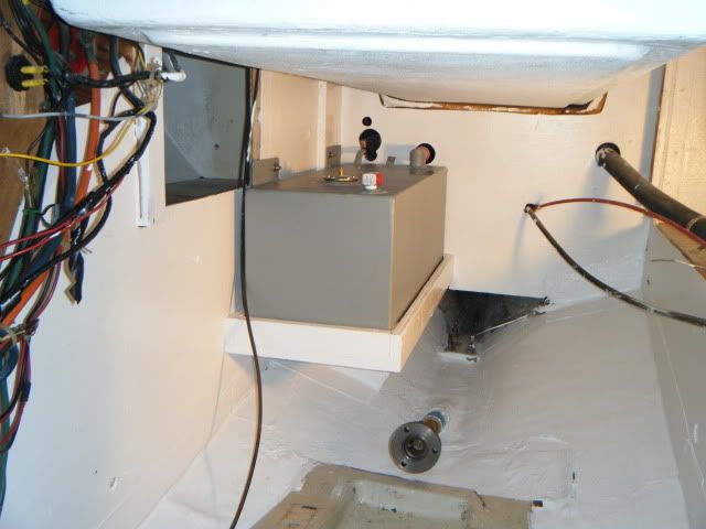

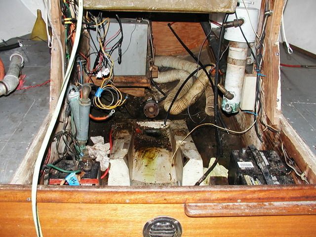

When I bought my boat the small engine bilge was full of oil,water and all sorts of other crap and the first thing I did before moving the boat on a 18 hr journey was to get a heavy plastic bag and a roll of paper towels and cleaned the mess up so any thing that was going to leak could be identified then when at my home port I bought a can of engine cleaner at the local auto parts store sprayed down the hot engine and then let it sit for awhile before I washed it with clean water, after drying off a can of Westerbeke red spray paint made it look like new and I just wipe it down with a rag when I'm changing the oil or messing around down there.....I'll admit its not as clean as MS but he does set a fine example for all of us

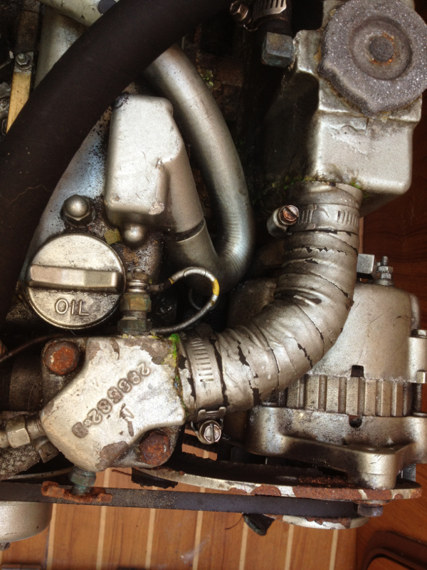

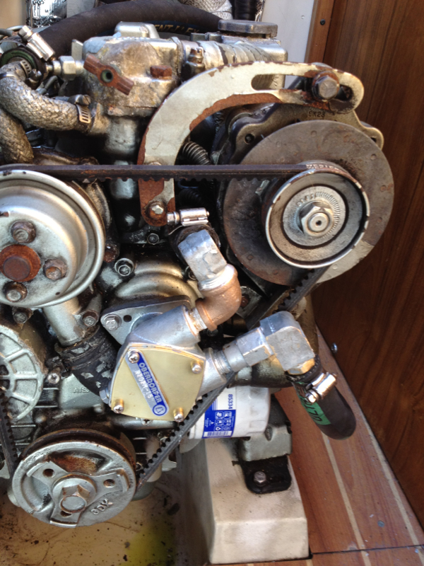

When my wet exhaust elbow went last year it covered my whole engine in soot. I asked Mainesail what to use and he told me Gunk engine degreaser on a microfiber cloth. It works really well but be sure to ventilate the area.
I used it a bit last season right after the incident and then again over the winter. For tight spaces I used the microfiber over a small wooded wedge. There are still some spots I have to get but it is better.
I ordered paint from my local westerbeak rep but he sent the wrong color. You can see the new water pump is a different color. I will reorder the right color and touch up the paint. I will probably use PUR15 or something similar as a primer for the rusted areas.
