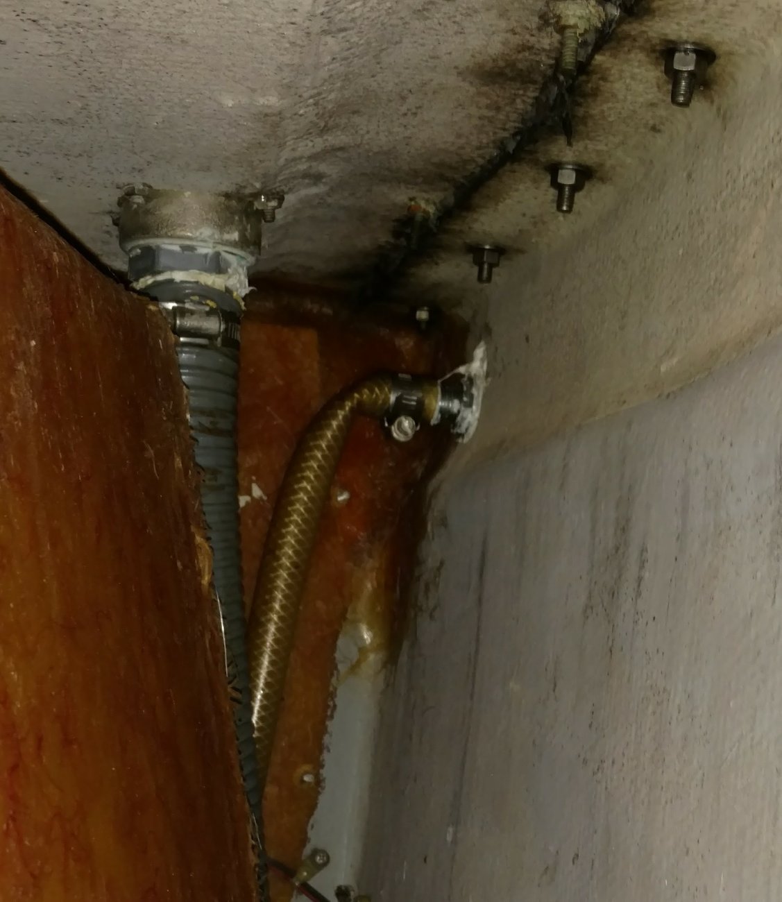

Ever since I bought my Express 30, the head never would flush very well. One day when I was replacing the stereo speakers, looking behind the liner, I was able to discover the problem. A kinked vent line in the most inaccessible location.

You don't say how you corrected the problem, but for the benefit of everyone following this thread... The water hose used as the vent line should be replaced with sanitation hose (Shields or Trident flex PVC #148 is fine for vent lines and toilet intake lines) and a 90 degree fitting used at the vent thru-hull.
I see a black corrugated hose in your photo...it hasn't been recommended for use in sanitation systems for at least 40 years because the corrugations trap bits of waste, TP, salt and other seawater minerals. So if that black hose is toilet or other sanitation hose, it needs to be replaced with sanitation hose. In fact, judging from its appearance it's so old that it should be replaced whether it's part of the sanitation system anyway.

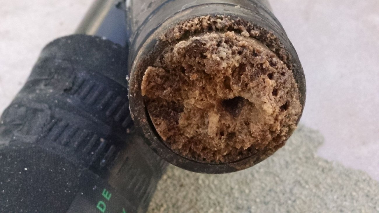

I own a 1997 Hunter 376, and the drain hose between the Y valve and holding tank has stopped up several times and is currently stopped up. I was reading about the "NOFLEX" product and was wondering if this might unclog my hose, otherwise i was considering replacing the hose completely. Any help will be appreciated.

Thanks for the response, I think I will try to unclog the hose with a SS cable then use some NOFLEX DIGESTER to finish the job. I'm sure it is calcified material that has been in the hose for many years. If that doesn't work then I will replace the hose. Not a fun job no matter what option I choose.

Noflex is not a magic hose cleaner. Just replace it..

Flush a a 12-15% solution of muriatic (hydrochloric) acid--available from any hardwrare store--through the system...follow it with about a quart of clean FRESH water after about 45 minutes. Repeat if necessary. Mineral
Or...if your hoses are original, they're way overdue for replacement. 10 years is the average working life of any hose 'cuz plastic and rubber dry out, becoming hard, brittle and prone to crack. Sanitation hoses are not the place to "go cheap" if you only want to have to do this once every 10 years instead of every 2-3 years, which is when cheap hoses start to stink. Raritan Sani-Flex is the top rated hose...it's proven to be 100% odor permeation proof --Raritan recently increased the warranty against it to 10 years--and has the added advantage of being so flexible that it can be bent almost as tight as a hairpin without kinking...which makes most re-hosing jobs a LOT easier. Defender has 1" and 1.5" for <$10/ft and they sell it by the foot.
