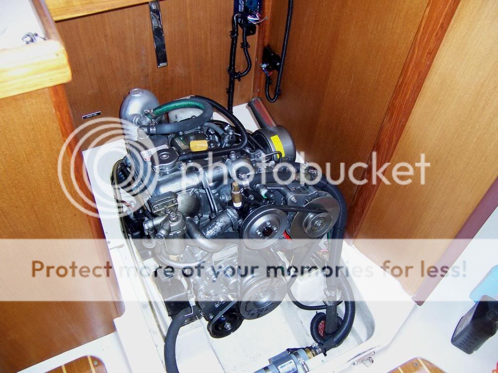

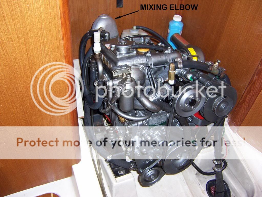

The below picture shows how the elbow sits above the engine.
This next picture shows a new mixing elbow attached to the riser piece which is in turn attached to the exhaust manifold. You can see how a pin hole perforation could allow sea water to dribble down through the riser and into the exhaust manifold and then ........................ well, you just don't want to go there :cry:.
For that reason, I remove the elbow every two years to inspect and clean and every four years, replace it . Perhaps a tad expensive at $382.35 (with taxes) for the last one, but better than the alternatives.

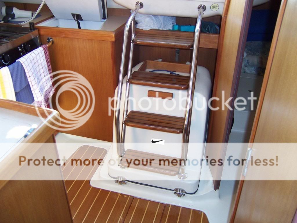

The one thing I do know for sure, the carbon has got to be due to the 138 F air inlet to the engine. It's the result of storing the engine in a shoe box as shown below.

Stu - The first photo in this post was taken a little over two years ago. Two years ago the vacuum breaker on the stbrd side of the engine decided it was going to leak. Salt water dribbled down the side of the engine. Stripped everything off that side of the engine, cleaned with Q-tips, and repainted. Needless to say, I ripped the damn thing out of there and have been looking at the situation on an ongoing basis ever since. As shown below in this more recent photo, the vacuum breaker is gone and the discharge hose form the HEX goes directly to the mixing elbow.
If you'll notice, the black lamacoid tag behind the engine is the water level when fully loaded. It is 4-1/2" below the mixing elbow which is not bad, but not the recommended 6" as per ABYC. So far, I've not seen any rise in water level when under sail (using plastic tubing as a sensor from the cooling water inlet line). The level actually seems to drop at higher speeds. Venturi effect I imagine. The thru hull is always closed when finished with the engine. Not the best arangement but I'm still contemplating.
