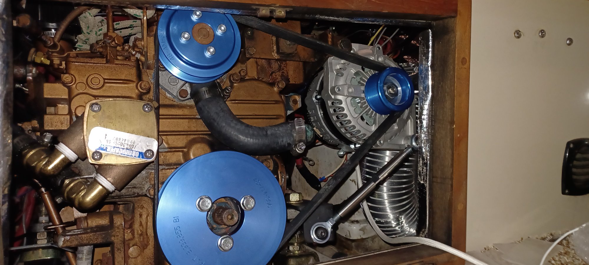

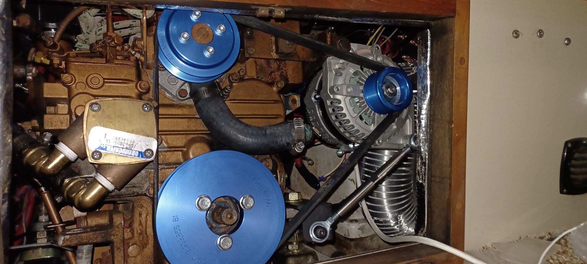

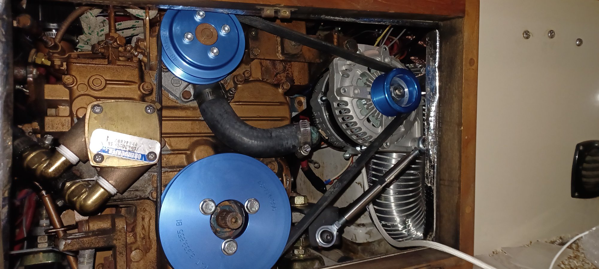

My system is a 250A large frame alternator driven by my 23-hp diesel with a Zeus. I can recharge from 5%SOC to 100% in just over 3-hours. This did require installing a serpentine belt and modifying the belt tensioner.
