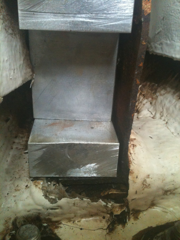

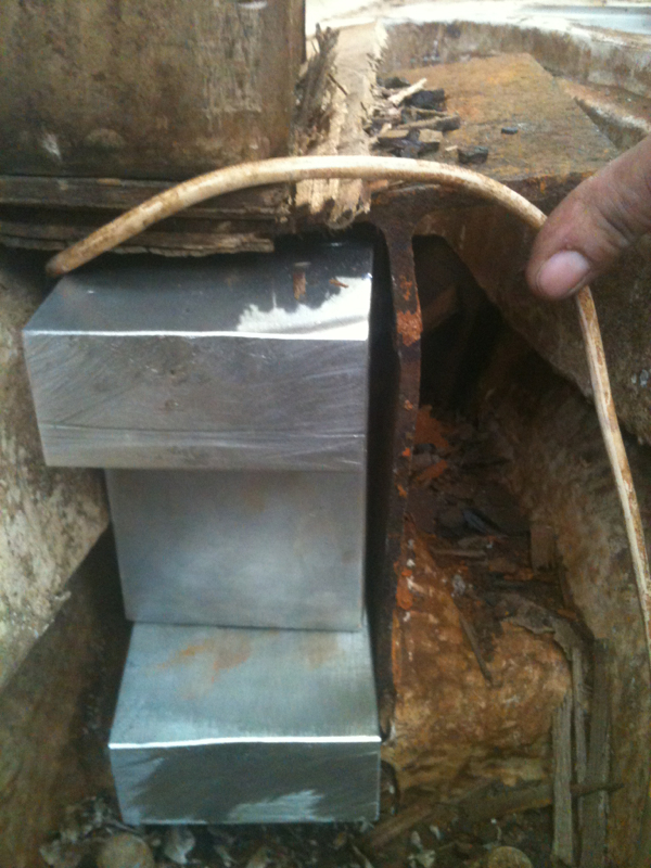

The day started with him coming by and getting a measurement for what was to be a compression base made of solid aluminum! A couple days later he sent me pics of my new compression base.( will post pics at end).
The day came to put base in, he said he can do it in an hr! For giggles I started my timer.
1st he loosened all shrouds
Then went below deck

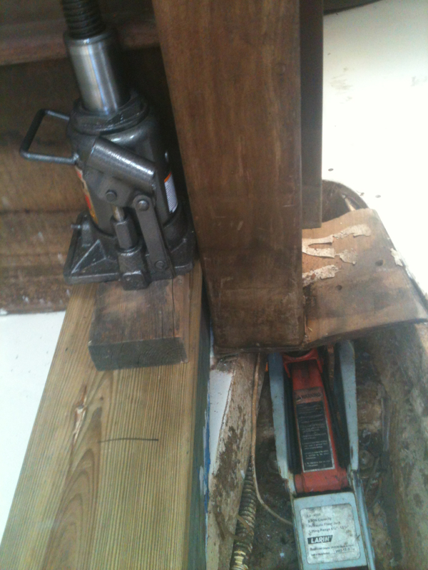

Using a block of wood ,a 2x4 and a 1x6, a bottle jack and a small car floor jack he went to work!
Jacked up the ceiling and then used car jack to straighten out bent I beam in bilge. Instead of cutting out I beam he shaved out access fiberglass used on Ibeam and a few hammer taps later my new post compression base was in place, some 5200 to hold it in place and the rest is history and he literally had it completed in about 55 minutes!

My I beam was rust out too. The bottom flange was encapsulated in epoxy and was in good shape. Just the Ibeam web was bad. My mast is down so mine was easier. I just knocked out the bad piece and ground the remaining steel web down to about 1/2". I chipped out all the epoxy so my new base would sit on the bottom steel flange. I made my base from 2 pieces of 6" structural aluminum channel, bolted together like an I beam. I also placed a piece of epoxy coated oak sandwiched between them so there is a gap to slide my new base over the remaining steel ibeam web. I will built a dam around the bottom flange and fill with resin to hold it in place and keep protected from moisture.
