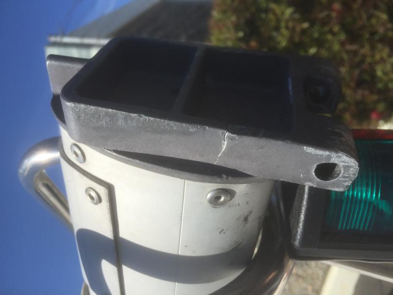

My new mast raising pole arrived yesterday, so we were excited to give it another bash. That's good. Got everything in place and went to set the pole, only to find the guys at Hunter cut it wrong. They drilled the holes east/west rather than north/south. The bad. Incredibly, we found a rigging shop down the street that drilled new holes in the pole and rigged new eyelets for $40. That's good. Got the mast up and furler attached. More good. Noticed though, probably residual damage from the pole bending, a crack in the mast foot or base. Looks bad. Am sure it happened when we bent the pole over. Mast was pulled quite a ways to the side.
So the question is, how bad? You can see the crack in this pic. I noticed when I bought the boat that some rivets at the bottom of the mast were bad, so the area needs work anyway. How dangerous tho is this? Note, I am a timid sailer, especially with a new boat. So am I okay setting sail in under 10kts?

It is always safer to get it done right. Especially critical equipment like the mast. With that crack you can never predict when it fails and how bad the failure will be.

If it was my boat, I would replace the damaged piece. It is a critical piece of equipment. From the picture (it is hard to tell), it looks like the piece will not sit flat once it is welded. You have to replace the rivets if they look bad.

As long as the mast is UP and the rig is tensioned, you are pretty much fine. the shrouds hold it in place and any contribution of the foot is spread over a lot of area. You can see lots of horizontal and vertical surfaces that take the load in all directions.
I would be very worried about lowering it backward. I'd try and find a mast crane to do the job.

New foot costs $44, a new mast is closer to $1500, plus the injury risk involved, I think I would opt for the new foot.

I did a dumb thing and forgot to put on the baby stays while raising the mast. Fortunately, the only damage was to the mast foot, which I had to replace. I got a new one from the Sailboat Owners store. They got It to me in three days. I replaced the rivets with 1/4 X 1/2 inch screws. I wouldn't even think of using your old mast foot when a new one isn't expensive ( for my Hunter 26) was only $56.00. It only took around an hour to drill out the rivets, remove the old foot, insert the new foot, drill and tap the new holes, put lock tight on the screws, and screw them in. Done deal and I know it's safe. Just my opinion.

Hunter was nice enough to send me the new mast foot gratis to compensate for the pole problem. I am really excited but also really worried about lowering the mast now. Have images of the plate blowing apart while bringing the mast down. All sorts of expensive and painful chaos would ensue. I think I am going to take it to the rigging shop to repair.

The mast foot is basically what I call pot metal and cannot be welded so a new one which you got was the way to go. When putting up any mast always point the boat into the wind and the same going down. I believe that is an old Z Spar mast foot and now U. S. Spars which is basically selling Z Spar but under a different name. Once it is cracked, the best thing to do is replace the mast foot. Not as much stress coming down vs. going up.
