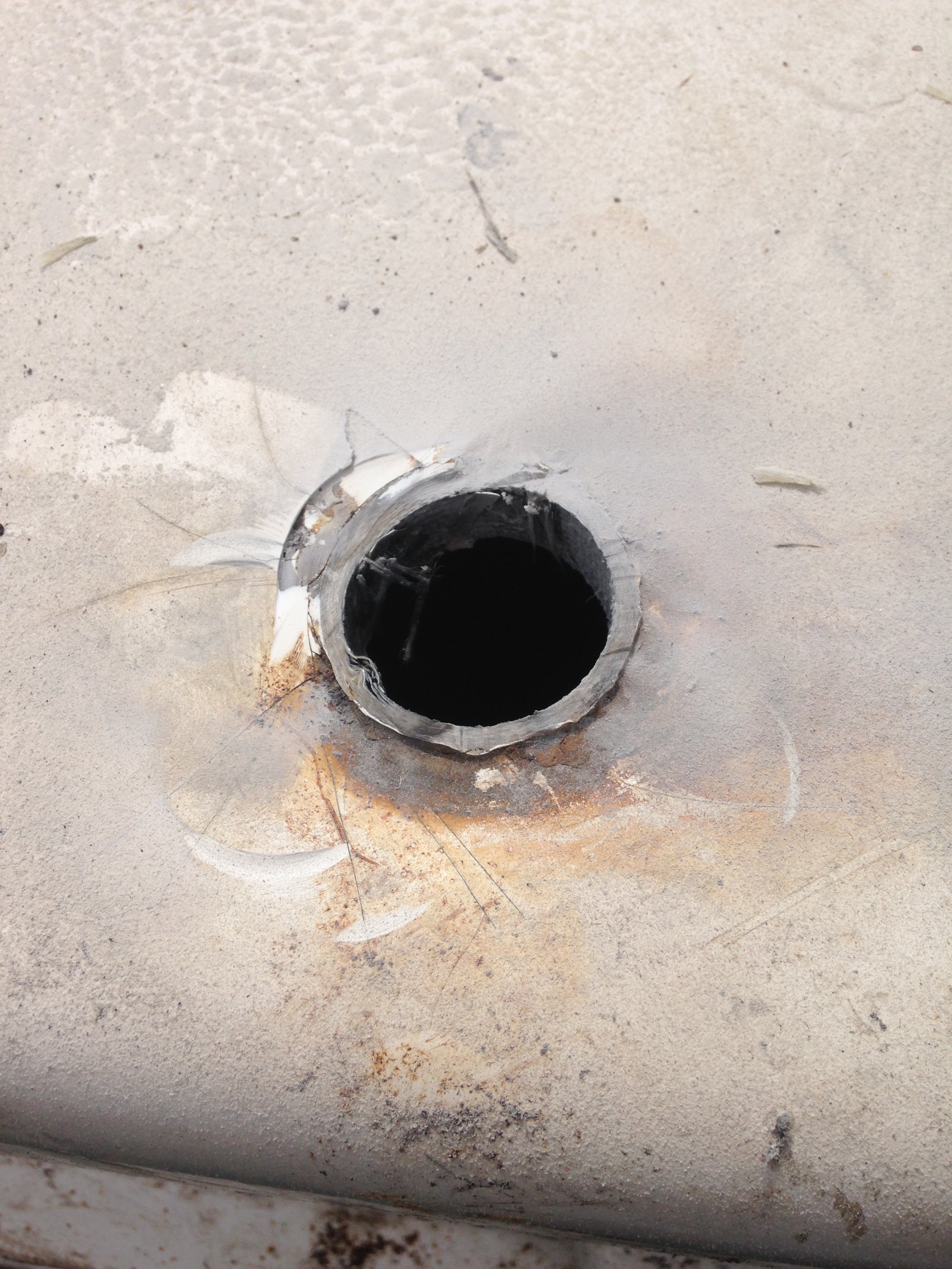

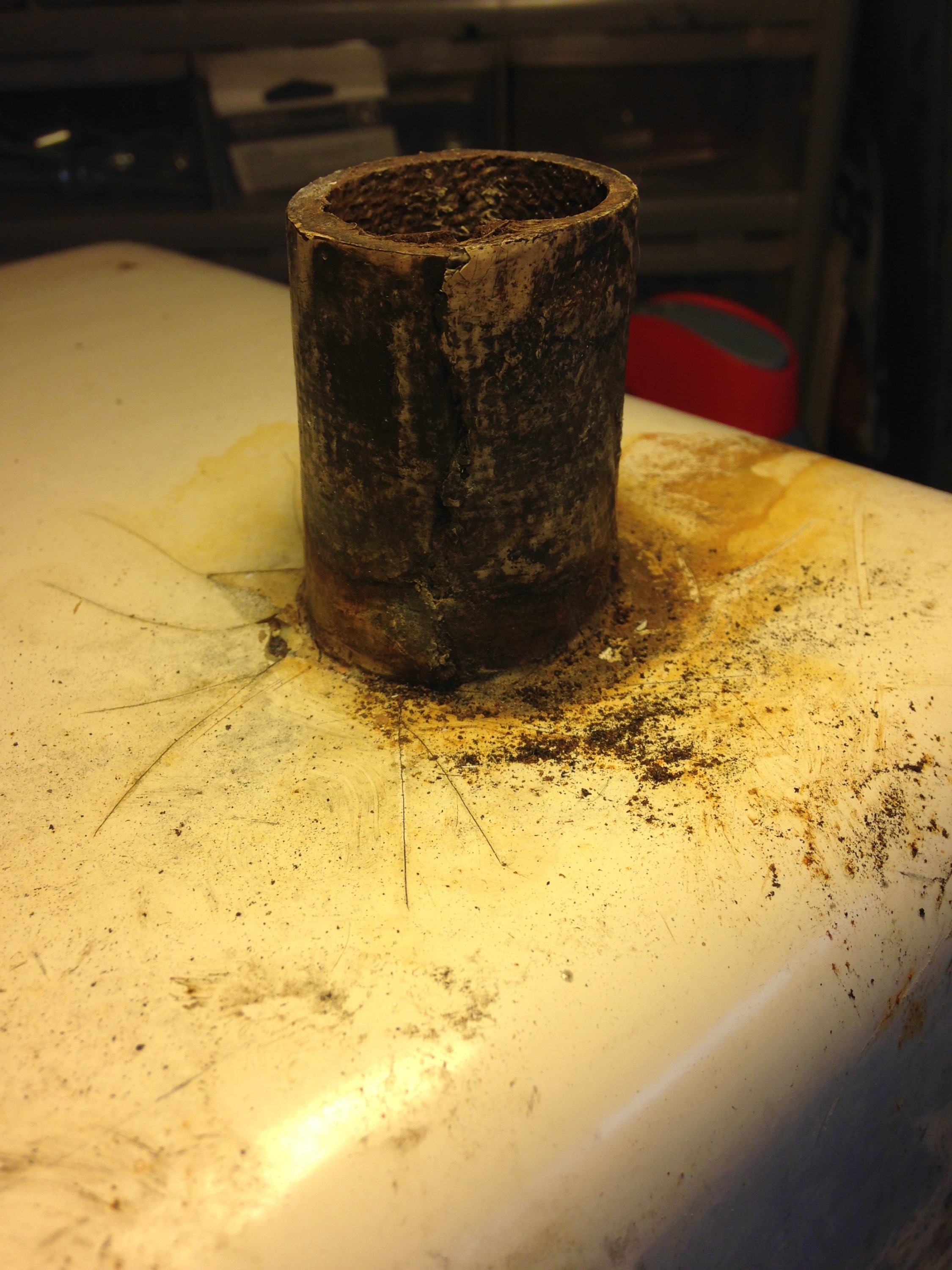

Why oh why would someone epoxy the aqua lift to the hull??????? I thought I had a good plan going to repair the thing. I was going to try Mark Hamilton's nicely detailed repair on the Cat 30 owners site. Well that's out the window, next weekend I guess I bring the sawzall and try not to sink the boat cutting the POS out. :banghead:
Nov 14, 2013
238
Catalina 30 MkI 1983 TRBS Westbrook, CT
Oh, it's leaking the typical leak at the inlet. Already cut, dismantled, disassembled and are at a point of no return. It's got to come out. I read somewhere on the web that a large crow bar works well. It's going to be a very interesting Memorial Day Weekend.

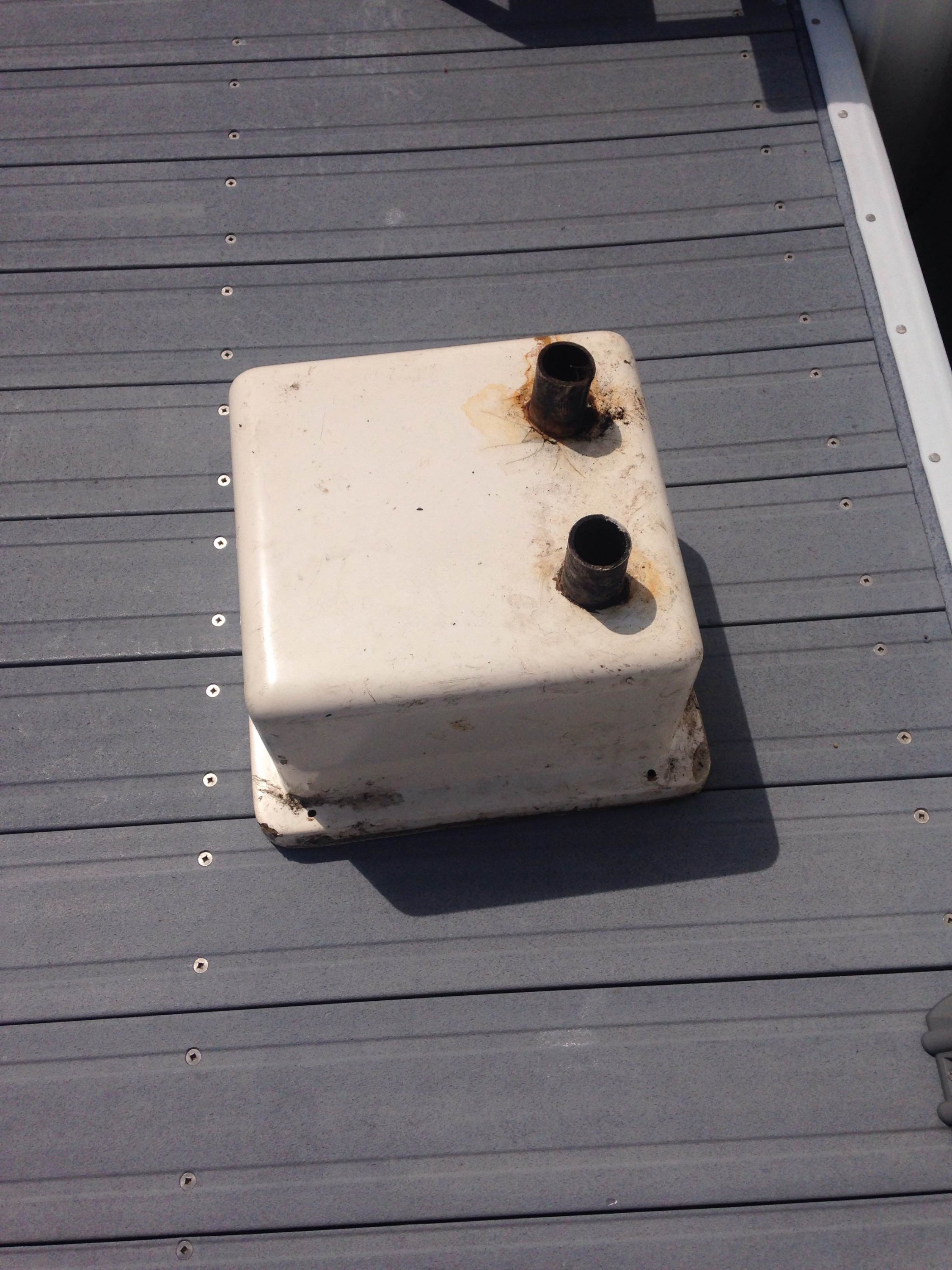

Okay, update. The aqua lift was NOT epoxied in, it was just really hard to get loose. After some time, and 4 different pry bars, it popped loose. Now to get it out without having to remove the kitchen sink.
Nov 14, 2013
238
Update #2. Feeling pretty good today. Notes for others, disconnect your batteries lots of live wires in the engine compartment that get moved around while muscling this thing out (don't ask how I know). The alternator has to be removed, once it is there is just enough room, and I mean JUST enough, to pull the muffler out threw the large top hatch in the main saloon (salon?) but it can be done. Now to the work bench at home and start the rebuilding process.

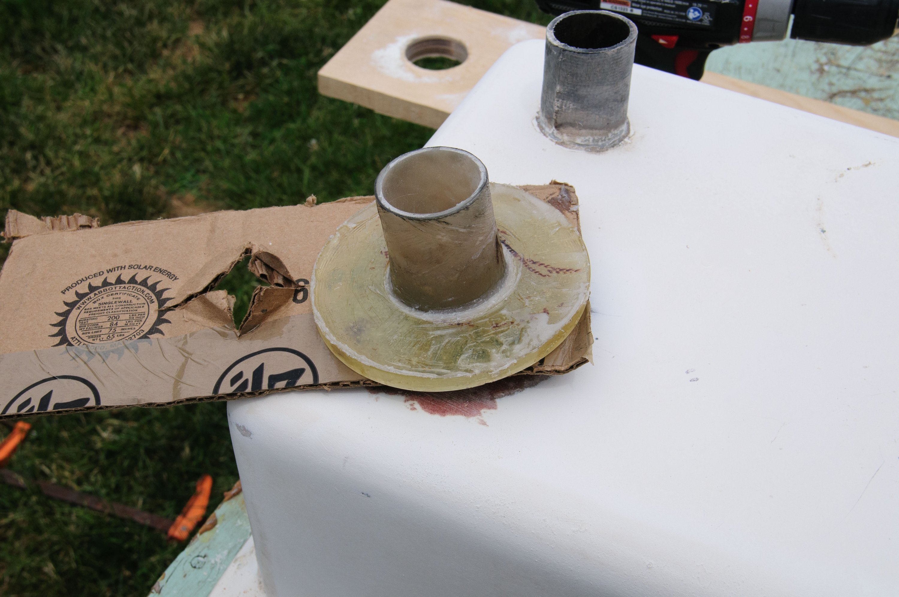

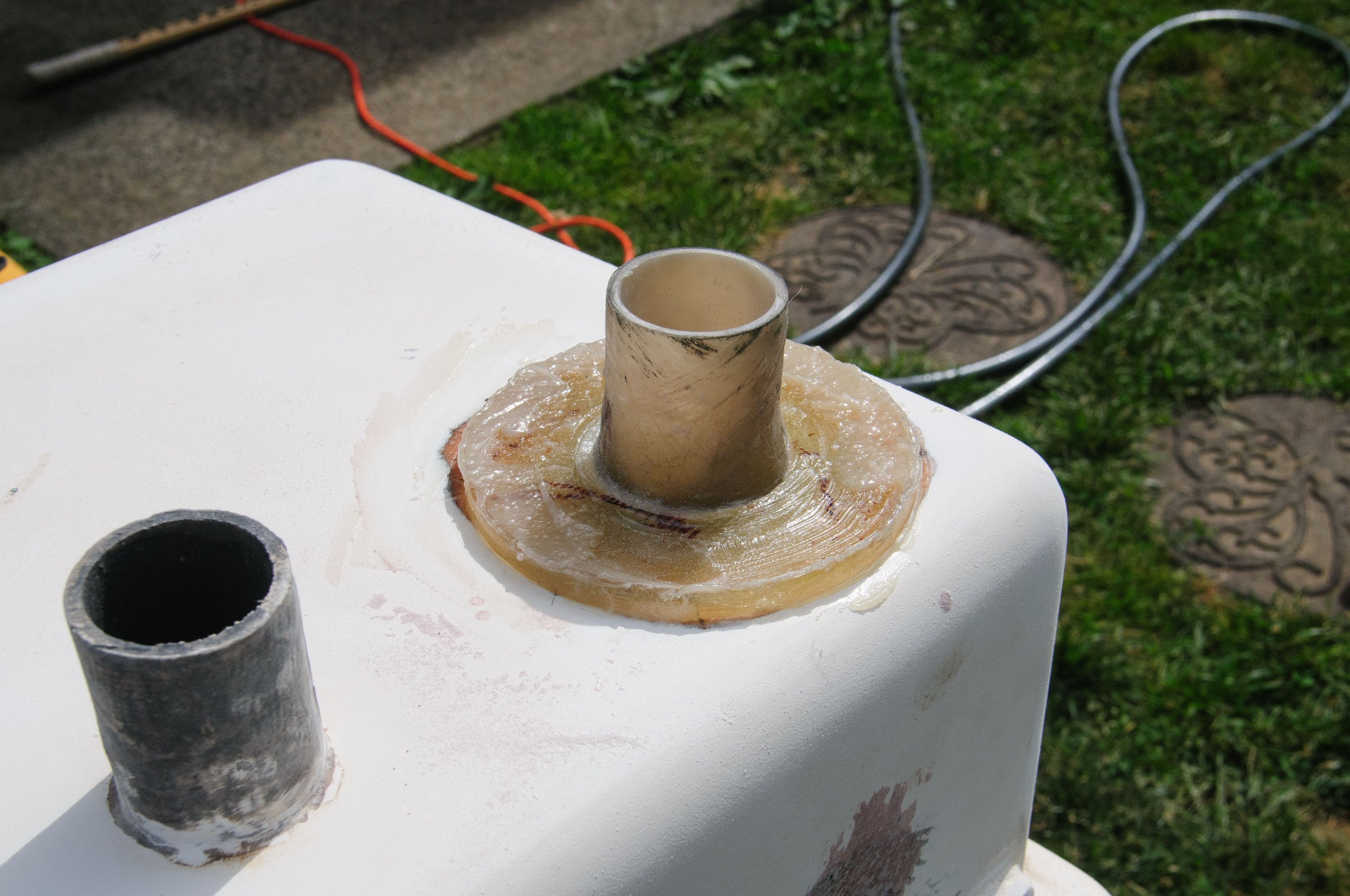

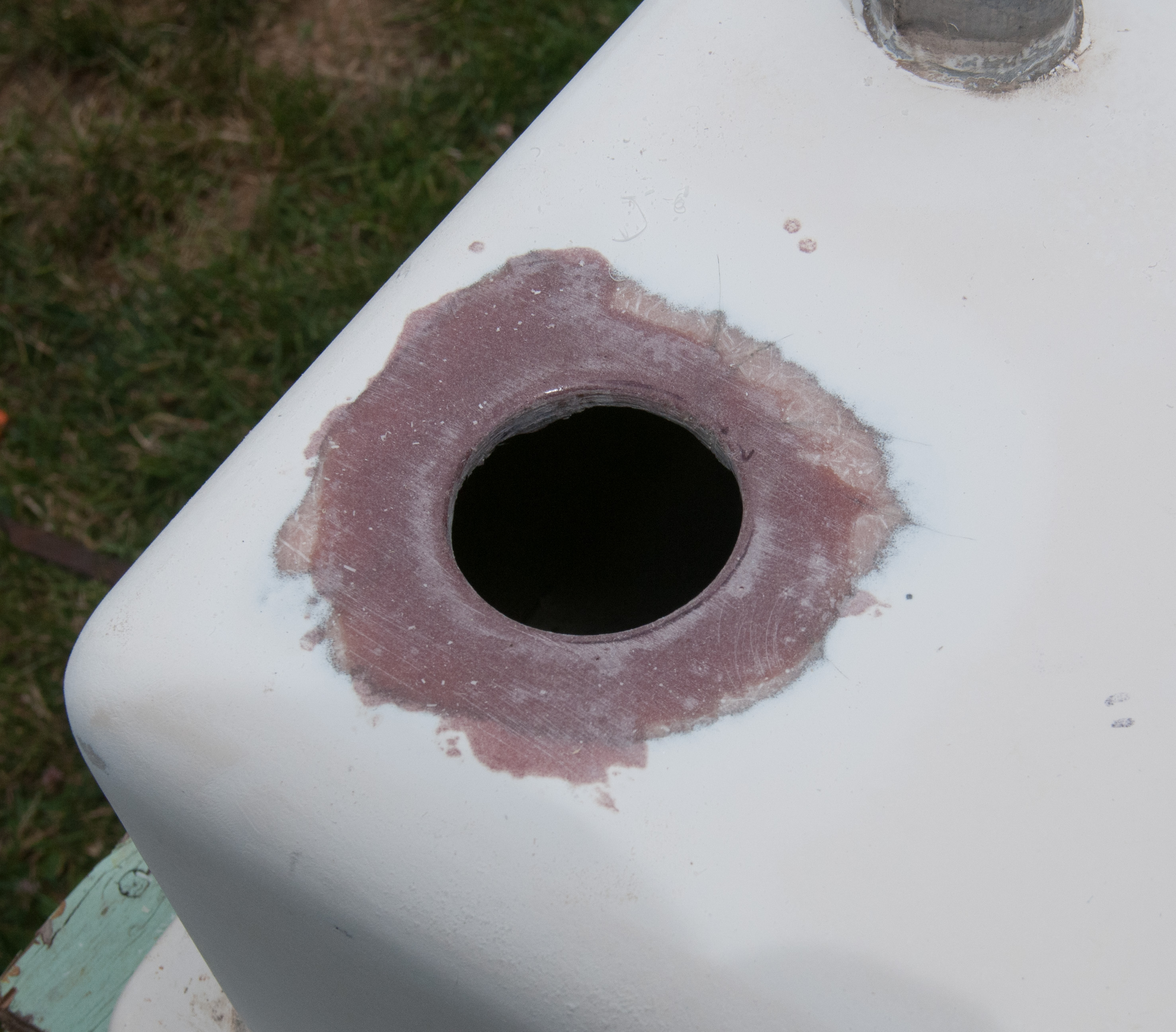

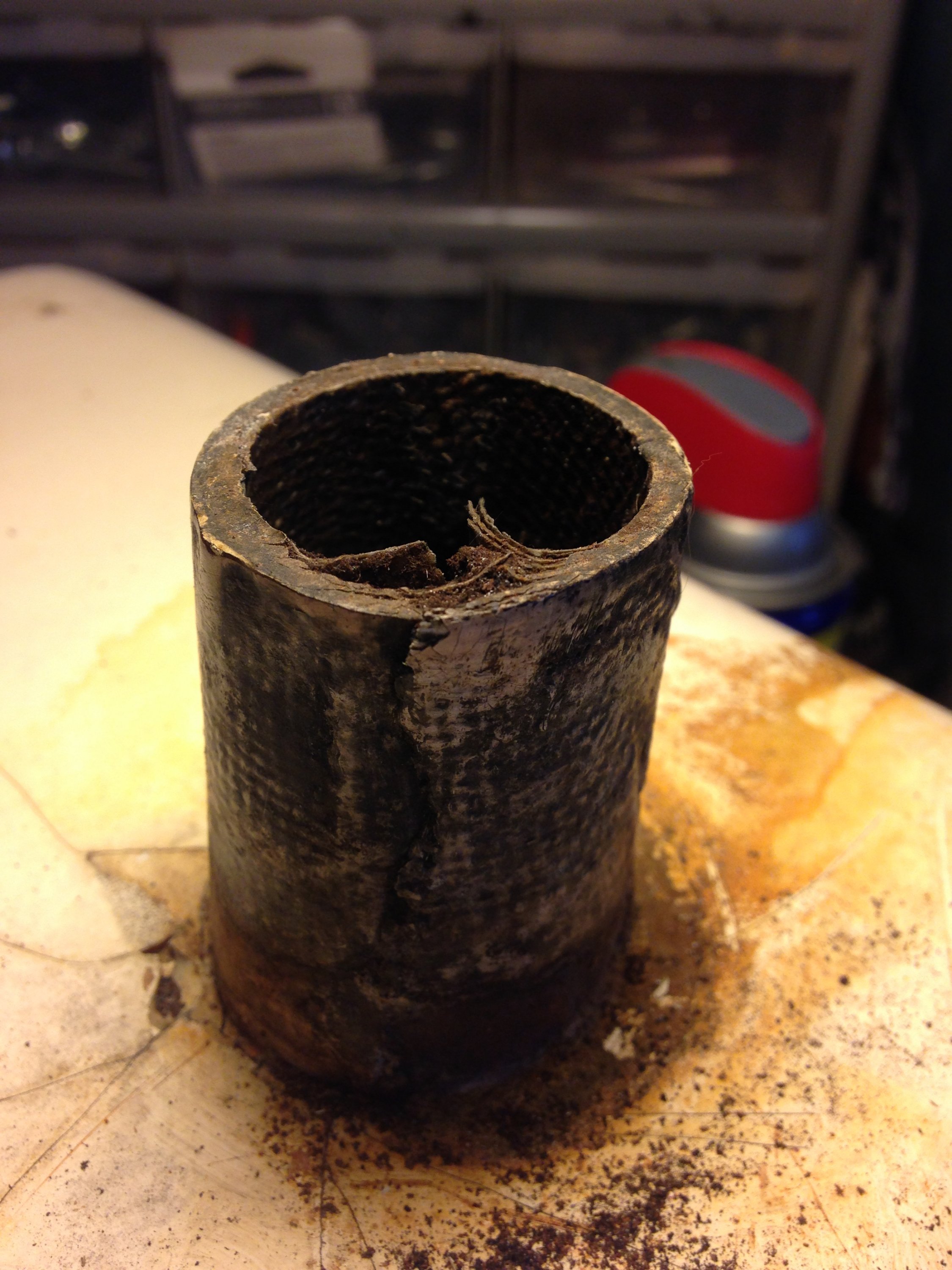

Update; a month later ("life" does seem to get in the way sometimes, my mom was diagnosed with lung cancer shortly after I removed the muffler) anyway, here are photos of my rebuild. It's a little ugly but I'm planning on sanding and paint tomorrow.
All in all I am very pleased with this repair and along with the "hump hose" I think it will be a long term repair.
