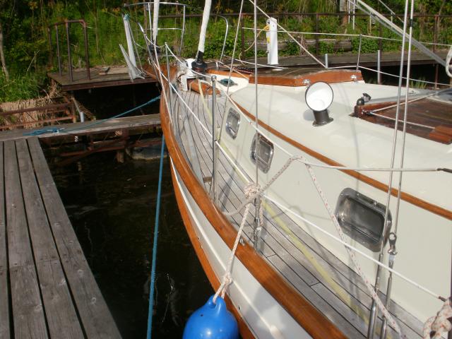

i did some asking around and found sikkens cetol cheaper at a local lumber yard. $31.00 gt. as apposed to $37.95 at the local marine sales store. they have different flavors too. your trim looks great. like the tone. can we get more input on your prep work?
I used 3 coats of Natural Teak followed by 2 coats of Marine Gloss. I sanded the wood down to 220 grit. wiped it down with acetone and used a tack cloth just prior to the first coat. I didn't keep track of how many hours I put in, but we had a beautiful April here and it was nice to be outside.
