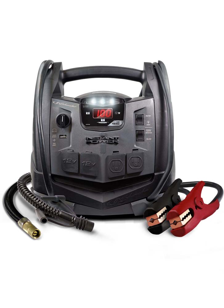

Hi I have a portable jump starter (Schumacher SJ1332 Rechargeable AGM Jump Starter for Gas Diesel Vehicles - 1200 Amps). I’d like to test it if will start my Yanmar diesel 2YM15 in case my batteries ever died. To test this can I disconnect the cables from my battery and connect them to the cables of this jump starter? Thank you !

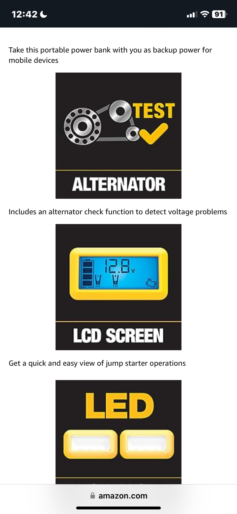

I have the Jeep JumpBooster and use it on the H285 and on my Sea Ray. When I start the engine it stays on till I remove the booster several minutes later with no ill effects to the ignition system or to the jump booster. Not sure what many are saying regarding doing damage to the system/booster. The jump booster I have also has the alternator test indicator that monitors the system for problems and it’s never highlighted any issues. The screen grab is for the Dewalt unit but the Jeep is the rebranded version I have.
