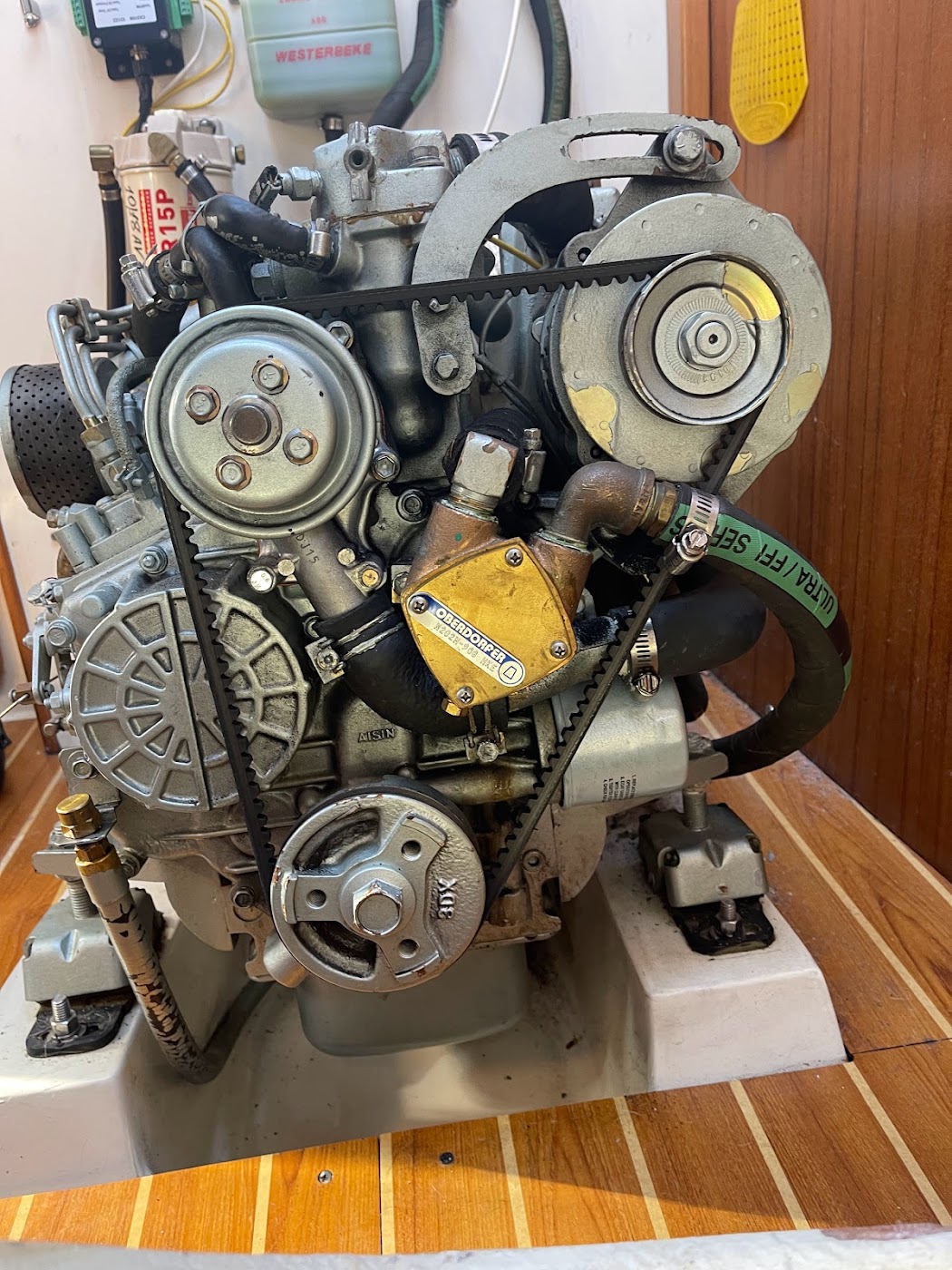

How do you go about confirming that the coolant pump on the Universal MX25 engine is working correctly? To be clear, I'm referring to the 50/50 mixture coolant and not the raw water pump.

That is a reasonable question. I have not seen any surfire way of confirmation. There is some anecdotal evidence.
  1. The engine is not showing signs of over heating. Temp gauge reads normal. No steam in engine compartment.
  2. There is no noise from the pump
  3. The belt is turning the pump pully. No drips coming from the weep hole.
  4. If you circulate coolant through the water heater, the water should get hot. If not then there is no circulation.
Are you unsure of events that have been happening? What triggers the question?

You might also want to shoot the engine with an IR gun looking for hot spots if there's no water heater installed.
If there's a water heater and the potable water gets hot, as @jssailem says, there's your answer.

I've seen intermittent brief surges in coolant temperature. I've replaced the impeller on the raw water pump and can even observe the flow momentarily on the output of the water pump to confirm its pumping. For the coolant pump, I've bypassed the hot water heater connections when I replaced it last year, so I can't confirm, but maybe I should reconnect that as it would make this easier to confirm. I don't believe there's air in the system as I bled it briefly. What I've observed is that the water temp comes up to around 170 and surges to around 180. It didn't use to do that. Possibly related, I've seen a handful of times when the tach drops to 0 when the engine is running. I'm thinking it may be a ground issue as well. Any tips on how best to connect the hot water heater coolant lines up and bleed the system?

Thanks all for the advice and tips. I replaced the raw water impeller again and ensured that both washers were in place on either side of it when installed. I had cleaned and replaced the zinc in the heat exchanger as well (not much in there to remove). Here's a video of what I observe with the temp gauge at low rpm. No the engine does not stall. Universal M-25XP - Overheating
Mar 6, 2008
1,516
The way that the needle is vibrating, it appears that the wire that is connected to the engine Temperature sensor is loose.

I don't think a faulty thermostat would cause the needle to jump around like it does in your video. As JoeWhite suggested probably wiring or a faulty sender. Maybe a bad gauge?

You can pull the thermostat. put water on the stove in a pan. Heat it up. Use a thermometer to test the temp of the water. At 150º the thermostat should open (depending on the unit). By 180º it should be fully open (again depending on the unit).
If it fails to open or opens too early, you can replace it.
