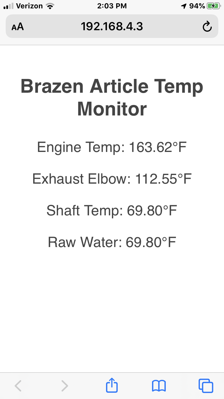

Pretty easy to build one with an ESP 8266 board and a couple temperature probes. That will show up on your phone, tablet or computer screen via WiFi. Cost is less than $30 and it can do more and grow unlike most commercial solutions. I have it on a small boat network that isn’t connected to the internet.
Attached is a screen shot from my phone.51AC1ED0-798E-43F3-92E9-EB27578C3F83.png

I have exhaust, engine, and cabin, but shaft temperature seems like a good addition. Did you just mount the sensor for that one on the stuffing box area?

"Pretty easy to build" = How about parts list and plans. What did you use to house the module, what model(s) of probes, where attached etc. I's like to learn from your obvious experience with this. I think I could build one but could use some guidance. Enlighten us please. PM would be fine if no one else is interested in details.

I put together bits and pieces from various websites to build my temp sensor. Most of the Arduinocode is cut and paste, and there is just a little soldering and assembly involved. The website lastminutengineers.com has a good tutorial for a four sensor web server off a little ESP8266. Their updated info is for an ESP32 but it is the same for an ESP8266.
There is good info on the signalk.org blog too. Signal k server is more complex than needed for a simple temperature sensor so don't let the tech stuff scare you away. Other p!aces to look are Internet of Things and Internet of Boats searches.
The Esp boards are two or three dollars each, temp proves are available in 5 packs for less than twenty bucks. You'll need a resistor and a power cord or power board for the ESP. I use micro Usb cables like these - https://www.amazon.com/HitCar-Unive...icro+usb&qid=1578946500&s=electronics&sr=1-21
