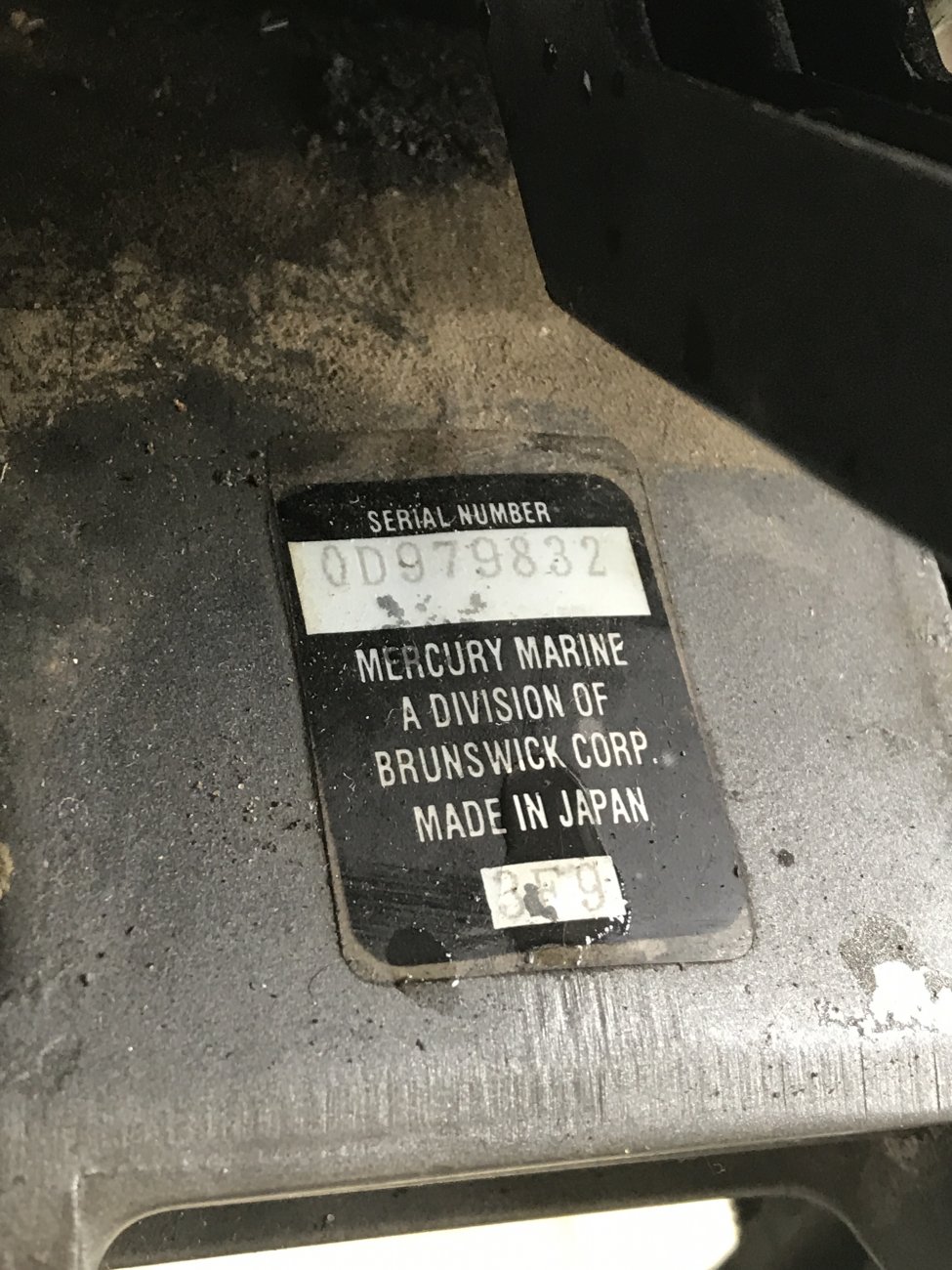

Tell tale location on 4hp mariner
Nov 21, 2018
20
Skipper 20 Skipper 20 New orleans
I don’t know, can u find out please. How would find out. I’ve been In mercury forum and registered but would not let me post.

Take the cowling off. If there are fins on the cylinders, it is air cooled. If the cylinder/cylinders have smooth metal sides, it is water cooled. Most small outboards have a small hose hanging through the cowling as the tell tale. This hose often gets blocked by salt. If it is clear, and no water coming out, the impeller needs to be changed.
23,103
Google it. There are many manuals online. Use the 3 digit number on the bottom of your label image. I think that is the model number.
