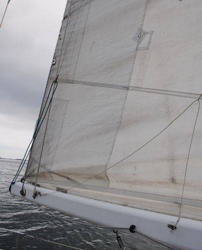

Sublime: The big question is what do you think about your sail trim when you took the picture? I already know the answer-- you're happy with the results. The sail looks to be at full hoist. I'm not sure about parts of the back edge as it might be the picture or the leech line is a bit too tight but overall the shape of the sail looks fine.
Now for the $64 question - what did you do to obtain the pictured result? Also, what is your first name? I hate calling you sublime!!!
Aug 10, 2010
178
Catalina 25 The mountains
I'm okay with going by Sublime :redface:
I wasn't sure how to correct the leech of the sail so I'll fiddle with the leech line. I cranked pretty good on the halyard and pulled the outhaul to the black line on the boom. But I'm not sure if the black line is sort of a "middle ground" for where the outhaul is or the limit. It seemed difficult to get it to that black line though the sail will slide along the boom easily.
I wasn't able to get what was happening near the boom pictured, but there was a "pucker" similar to this sample picture all the way across the sail closer to the boom. I imagine if there was a cunningham, it would do something similar, but I don't have one. I'm not sure if this is normal or how to tell if the sail is getting overstretched by the outhaul.

Sublime ---
From the pic, the SHAPE of the sail seems to be improved but still has problems. Its only a single pic and it may be the 'camera angle' but you still seem to have MAJOR *shape* problems; you cant adequately TRIM with an ill-shaped sail.
The 'scallops' along the luff and leech are removed (by increased halyard tension?) but.....
1. the leech section at the top of the sail seem 'hooked up to weather' which induces extreme draft ('depth' of the thick red line).
Three possibilities cause this.
A. the mast is 'too straight' with not enough mast pre-bend (did you set the mast bend according to the B&R instructions?) OR
B. the mainsheet is probably waaaaay too tight.
Since your boat is a fractional rig, Id suspect its the lack of adequate 'prebend'
C. Still not enough mainsail halyard tension !!!!! (if the mast has adequate 'prebend').
The shape of the leech section should be relatively flat (blue dashed line) and 'relaxed' not deeply 'curved up towards the weather side' ... follow the panel seem lines in the pic (very and deeply 'curved') to see what Im seeing/suggesting, .... the dashed blue lines are what it looks like with a flat or 'open' leech.
When you 'stretch' one side of a sail, the 'opposite side' relaxes or 'opens'; over-tensioning the luff causes the leech to flatten or 'open'.
2. The location (fore/aft) of draft (green stripe) is seemingly AFT, not at about in the position of 40-50% 'back' from the luff.
A. 'more' halyard tension is suggested to get that point of max draft 'more forward'. With the current shape, I'll betcha you have a LOT of weather helm.
B. Flattening or 'opening' (pointing more towards the leeside) the leech (with/by more mast prebend and/or less mainsheet tension will probably help.
3. Waaaaaay too much draft .... probably from a 'too straight mast'. Consult the instructions on proper set up & 'prebend' of the B&R mast.
Of course these are only my 'interpretations' from a pic .... but If I were racing you, Id 'stretch out' all the tacks because the pic. shows a very slow / too 'full draft' & draft aft, with a 'hooked up leech' sail ... and Id expect your boat to heel over and really SLOW-down when on a long 'beat'. With lots of tacks (tacking duel), youd be able to accelerate out of each tack like a 'scalded cat' (because of the radically 'powered-up' shape) but would never be able to get to 'full speed'.
FWIW for those who 'race' .... you scrutinize the competitors 'faults' in sail shape, and then force/encourage your opponent to sail in a mode that 'maximizes' these faults .... and 'stretch-out' your 'lead'! ;-)

Thank you for your time explaining and illustrations!
As for mainsheet tension, could it be that I had the vang too tight? I pulled down on the boom and tightened the vang that way.
I will look at the adjustments for the rigging. Per the owner's manual, when I hang something from the main halyard near the deck, it should hang 4-6" back from the mast. So I will check that.

an over-tight vang can also cause this leech shape AND can cause the position of max draft to go slightly aft; .... but not the amount of excess draft as shown.

Noted, thanks! Today is a very calm day so I will work with the rigging.

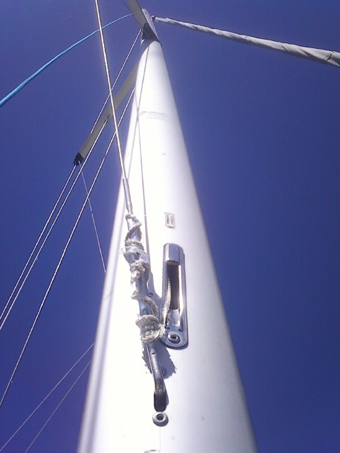

regarding your very first picture concernig flutter at the very top.......... did anyone ask you to check the top batten to make sure it was not broken and that it was properly seated in the pocket? If the batten is okay, that's cool... it's just something that crossed my mind that may not have been mentioned.
Aug 10, 2010
178
I believe it is okay, but I will double check tomorrow.
Okay, I checked the mast bend. My weight hung within the range of where it is supposed to per the manual. The upper and lower shrouds had the same amount of tension on them but with my info regarding this rig, the uppers should have an additional 100 lbs.
I have a loos gauge so it's not a big deal. So I put another 100lbs on the uppers only.
The first pic is before, with all of the shrouds equal tension. The second is after I increased the tension on the uppers. Not sure if they provide you with any useful info. I plan to go sailing tomorrow so I guess that's the ultimate test.
One question though-the upper shrouds don't go to the very top of the mast. Does that change the amount of prebend I'd be able to put in it? I guesstimate about 5 feet of mast is above the upper shrouds.

If you dont have it, Here's some info on tuning a B&R on a 260: http://kobernus.com/hunter260/rigging/rigging.html
If you dont have the instructions of proper pre-bend to match the 'cut' of the luff shape on your MAINSAIL ... here's an article that would apply to your mainsail / mast and how to determine the correct 'prebend' vs. sail leading edge shape. .... When reading that article. in your mind change all the 'wire stuff' as applied to jibs, etc. to the mast prebend shape - a sailmaker will usually 'add' a convex shape to the luff to match a mast profile ... and so that the mainsail will take on its DESIGNED amount of draft, 'subtract' a concave shape to match a jib's luff profile.
The importance is that the mast should be bowed to approximately 'match' the curve that sailmaker cut into the luff; .... a bit more bow to flatten the sail for sailing 'fast' in flat water, less mast bowing for 'powered-up' sailing in waves ----- the amount of prebend/bowing helps control the AMOUNT of draft in the mainsail, especially in the mid to upper sections where the 'outhaul' tension is ineffective. Most sails are not cut 'straight' along their leading edges but rather curved to 'match' the expected sag/bow of the wire/mast.
http://www.ftp.tognews.com/GoogleFiles/Matching Luff Hollow.pdf
The 'prebend' is typical for ALL masts ... it artificially makes the mast 'stiffer', and a good sailmaker includes the EXPECTED prebend when calculating/designing a sail.
I hope this is too confusing, if it is lemme know.

Okay, went for a sail. The winds were incredibly light such as 3 kts and less. Most of the time the windex wouldn't register and the sails just hung. This picture is when I had the sail as full as I could get it today. But hopefully it can show some improvement?
I put more tension on the upper shrouds, loosened the leech line, and just had a little tension on the vang.
I can't tell you how much I appreciate everyone's help. Today marks the second anniversary of my late father's passing. He willed the boat to me which is why, despite the light winds, I went sailing as a celebration of his life. He was a very good sailor and I wish I had been more interested in sailing at the time he was able to teach me.
