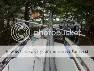

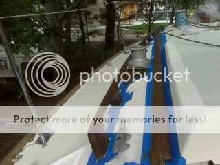

I recently re-finished the teak on my deck. I used Cetol "Marine" because the Teak finish was not available yet, the teak finish is lighter than the marine. Lots of sanding and 5 coats of Cetol. Here are some pictures:
