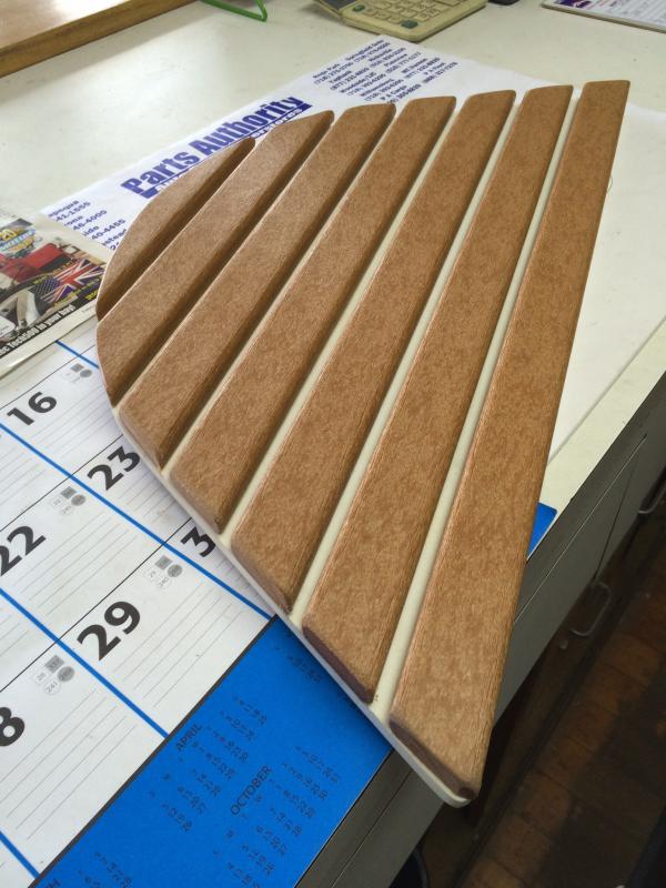

For years I've been bothered with how to maintain the exterior teak trim on my boat. I hate the annual remove and sand, reseal and reinstall process.
This year I came up with a 'new' idea :dance:
Instead of installing the resealed teak I bought recycled plastic 'teak' look alike lumber and made replacement teak. The finished product is now ZERO maintenance and looks terrific.
Just thought I'd pass this idea along to anyone interested.

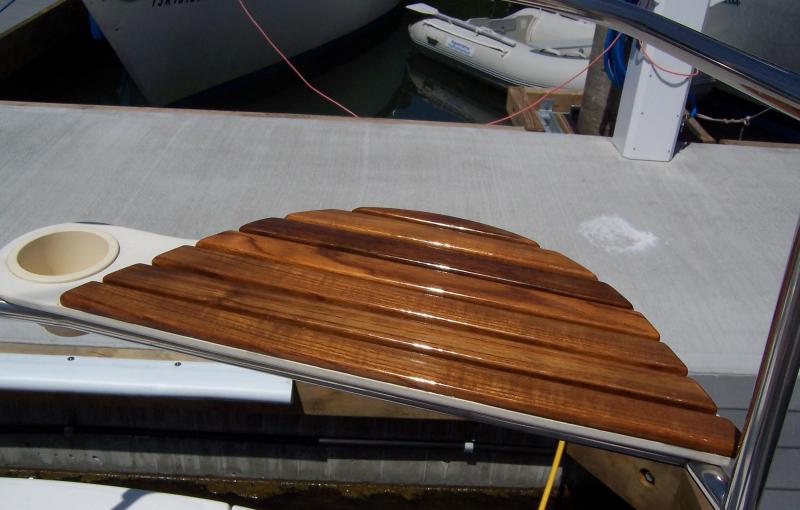

........................... a fantastic, 100% permanent (for all time), replacement for the teak strips on the transom seats.
Kills me to say so, but this may even beat out my epoxy treatment of the real teak strips on mine. The one problem with the epoxy finish is that you're always on the lookout for small dings as once water gets under the epoxy, things get nasty if they're not quickly sealed.

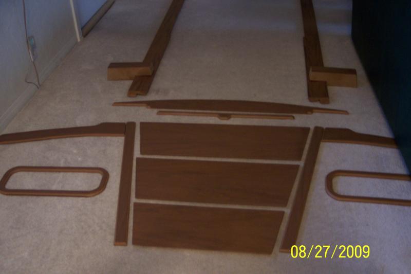

I went with synthetic teak a few years back, then it was called Sensibuilt. I was able to order 1x5 1/2 x 12' long strips & fascia board 12" w x 5/8" thk. x 12' lg. I was painting my deck & removed all my teak.
I matched-cut all the wood & the look was close to teak. Here is what mine looked like pal.........Luckily, Catalina's don't have alot of deck teak.

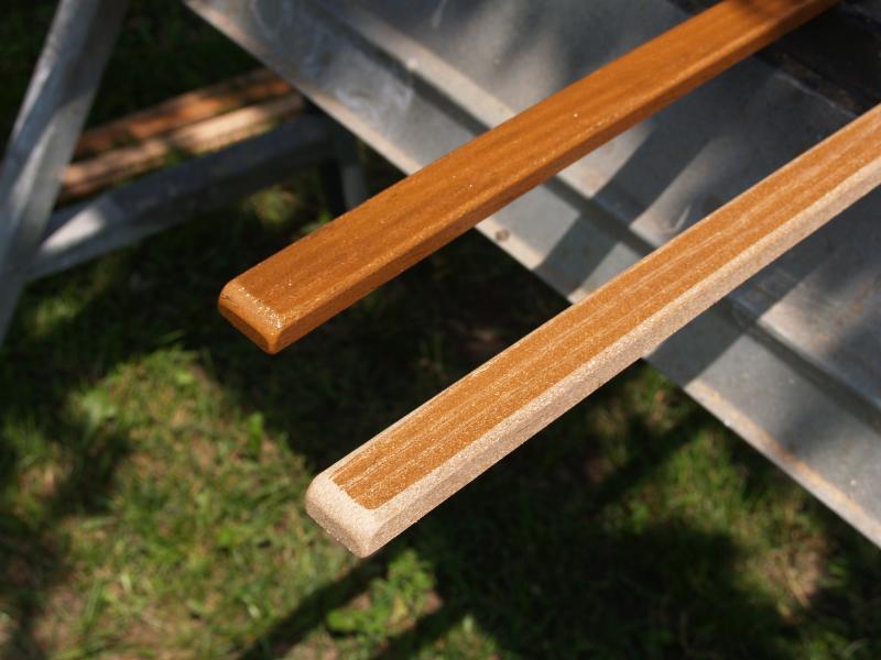

I did the same thing 5 or 6 years ago. Our boat has teak strips on the toerails and I replaced them with synthetic. After that much time, they still look new. Great upgrade! I used a product called Timbertech. The sides of the material are not the same color as the top surface after machining them to proper size so I experimented and wiped a little teak oil on them to unify the color. I haven't had to touch them since.
I like the idea of wiping with teak oil. The piece in the upper part of your picture looks great. How well does the material accept the oil and how frequently do you redo it?
