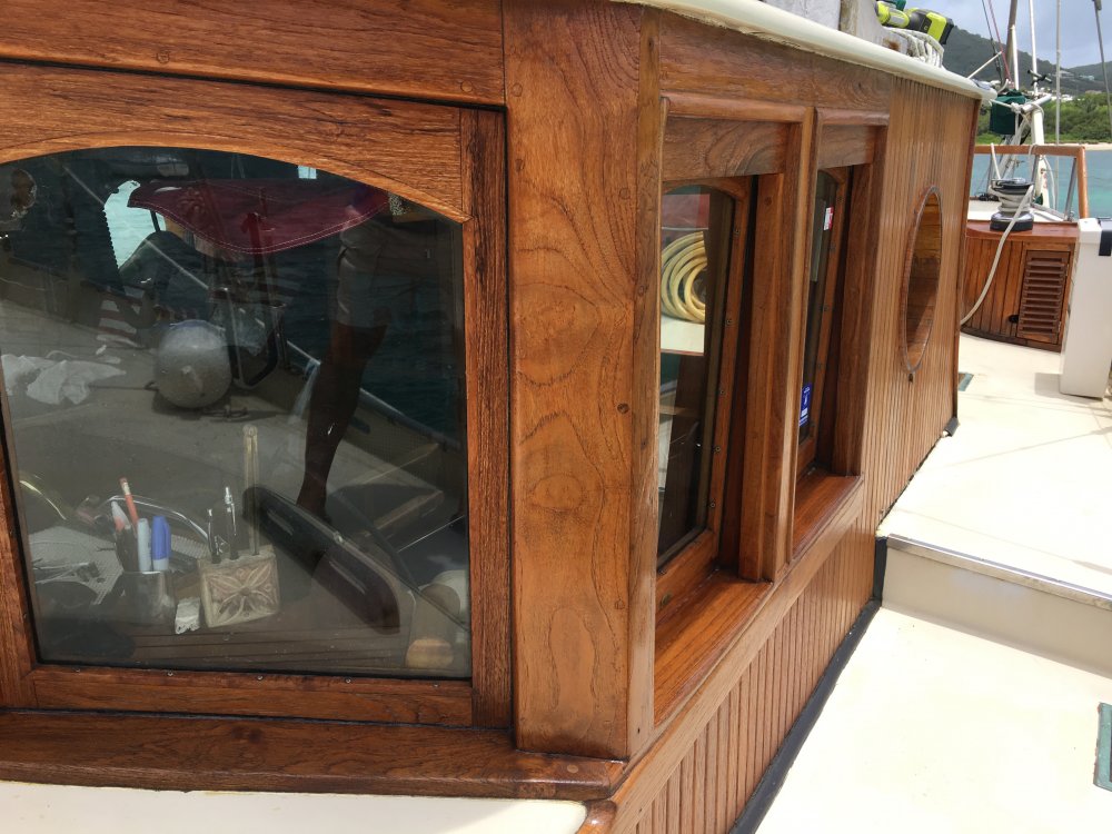

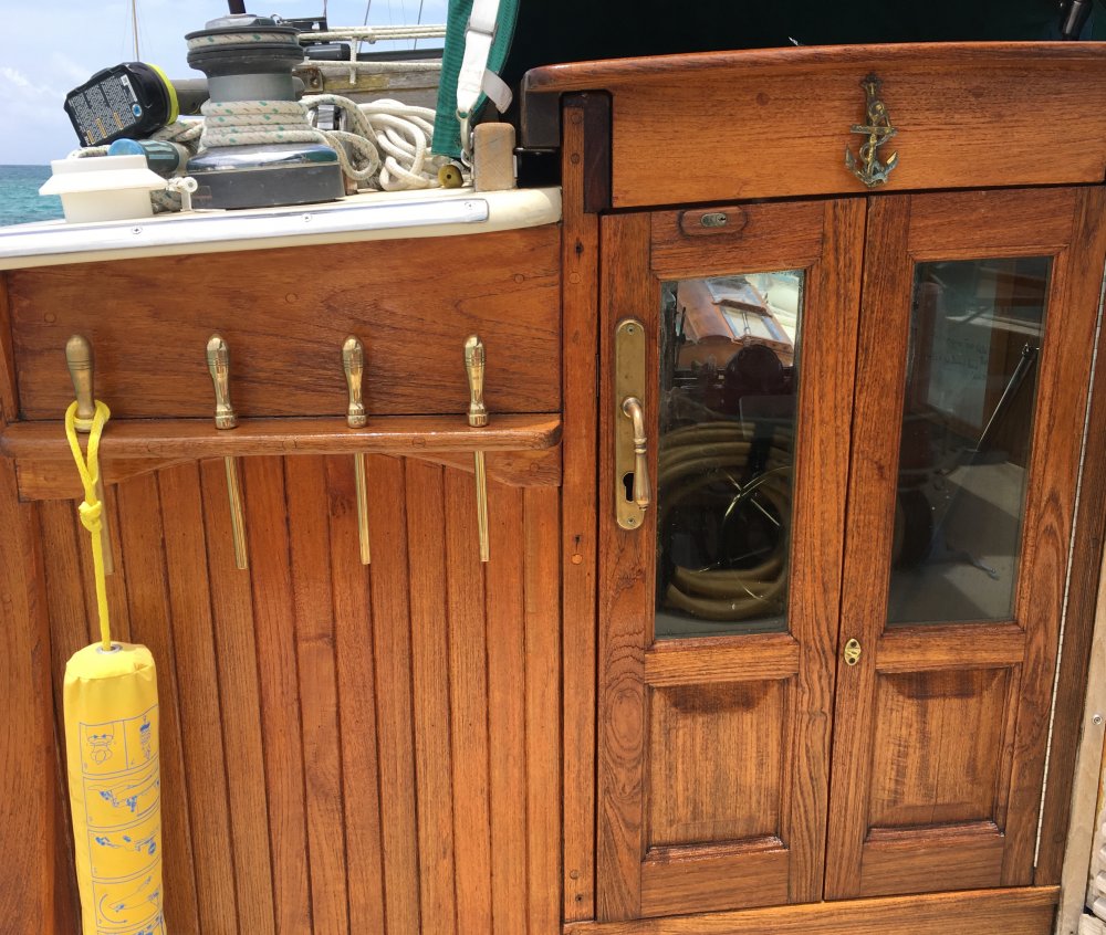

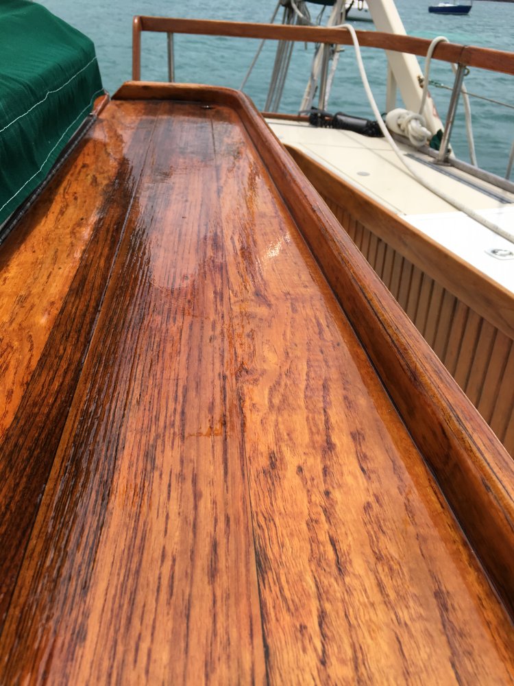

If you are looking for a deep shine, to me that sounds like varnish. These forums are full of proponents for a lot of various products, like teak oil, Cetol, traditional varnish, etc. Personally, we use Epifanes High Gloss varnish. If you go varnish, you want to get the wood down to clean, smooth dry teak. then basically follow the instructions on the can. First coat is diluted 50% with mineral spirits. On that first application it will soak right in and you will see the rich color. Subsequent coats you will see the shine develop. lightly sand between coats to take off the fur and bumps. Each coat gets a deeper shine. You'll want at least 6 coats, probably 8+, depending on the look you are going for.
* Wipe clean with mineral spirits after the initial sanding, to remove dust. This will also show you the color you can expect
* Carefully follow the thinning instructions
* Lightly sand between coats
* Opt for the cooler temps - like low 80's
* Avoid direct sunlight so it doesn't dry the varnish too fast. If necessary, just apply what you can each early morning
Here's what you can expect from this method:

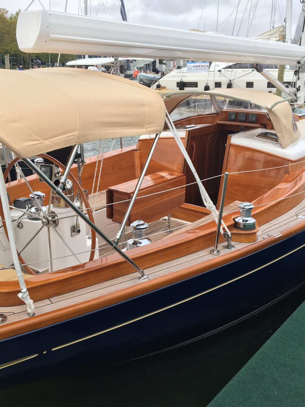

I was impressed with the bright work on the Morris I inspected at the Boat Show
I know the photo does not do justice to the depth of shine in this job. It was a big :wow3: presentation. Epifanes High Gloss Was the product used to protect this bright work.
@CherylZZ maintaining pristine teak between the bow and a windlass on the bow is a lost cause. The boats I saw in Annapolis all had stainless steel sheets over the high cost decks to absorb the chain damage that just happens. It might be a consideration for your boat.
Then you can focus your attention over the rest of the boat that is not exposed to repetitive damage opportunities.

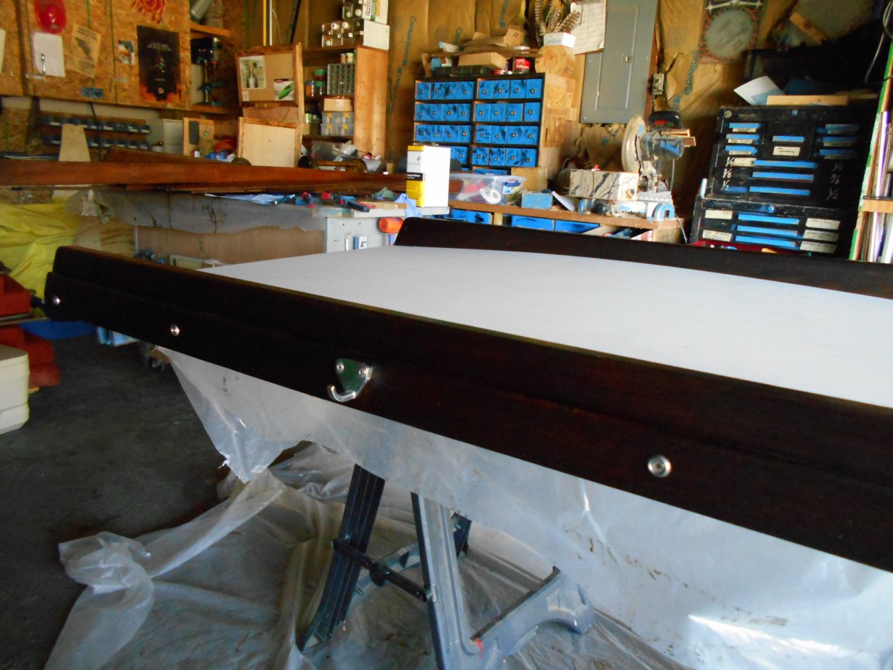

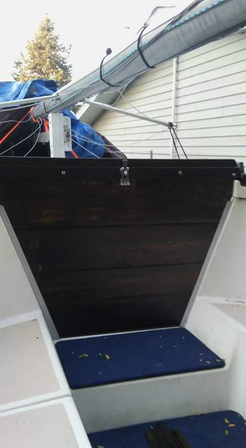

I just restored the wood on my Chrysler. All I did is sand it down, apply a coat of Minwax (just happened to have it in the garage from another project), and then a couple coats of polyurethane. I love the look of a fresh coat of polyurethane. The only draw back is, I believe it it gets too much sun it will start to dry out and flake off. But my boat isnt in the direct sun all that much as it sits on its trailer in the side yard covered, unless we are actually sailing.
I am definitely a huge fan of nice looking wood work on boats! I prefer it to these ultra fancy boats with little to no wood. I guess I am a sucker for the older stuff. As you can probably tell, my wife and I like the real dark wood on our boat.
