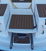

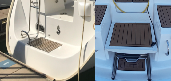

Photos of what you are trying to replace would be helpful. Is this what you are trying to replace (photo on the left)? If so, replace it with a synthetic like Marine Boat Decking - Synthetic Teak Decking | PlasDECK Inc. , SeaDek, which is what I have in my swim platform (photo on the right), etc.

With regards to the missing teak on the swim platform, your options are to fabricate a teak replacement or order a replacement from Benteteau. Some of the new synthetic products mentioned by Sail SF would certainly be a long term (hopefully maintenance free) option also.

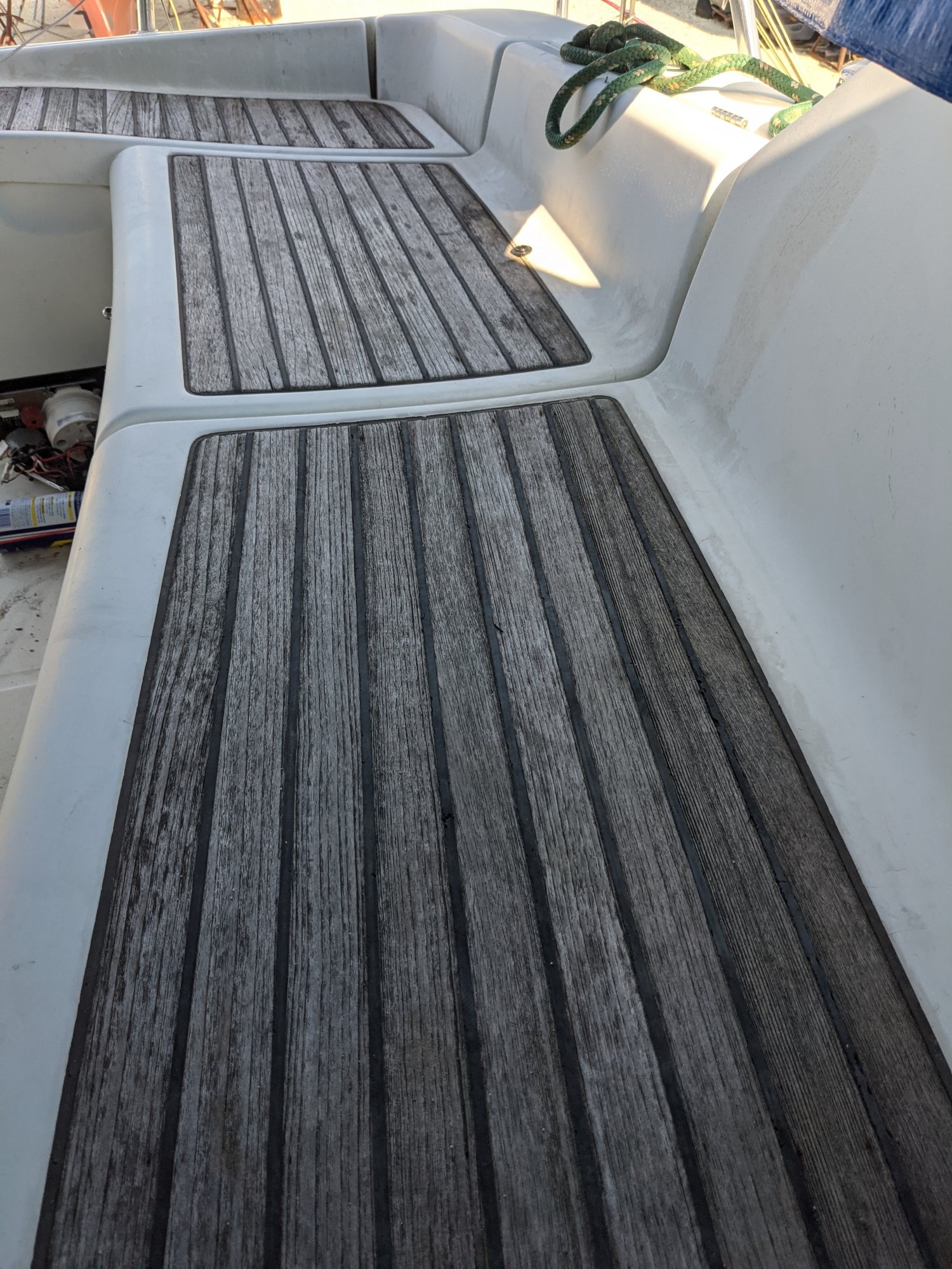

. Here are the photos of what I want to refinish.
I'll probably probably do the synthetic on the swim deck as you suggested.

Mine looked not quite bad as yours, but close! I refinished it without removing the caulking.
I power washed it first ( yes I know that you're not supposed to) at a safe distance just to remove the crud & decomposed teak. Then scrubbed it across the grain with a 3M pad, treated it with teak cleaner & let it dry out for a day or two. Then used 150 & 220 grit paper on a random orbital sander & sanded lightly. I could not get it completely smooth to my satisfaction; however, I did not want to expose the staples nor damage the caulking. Wiped it down thoroughly with acetone and coated with 3 coats of Semco. Would also recommend synthetic on the swim platform. Takes me approximately 45 minutes for each application of Semco & you can reapply immediately after each coat.

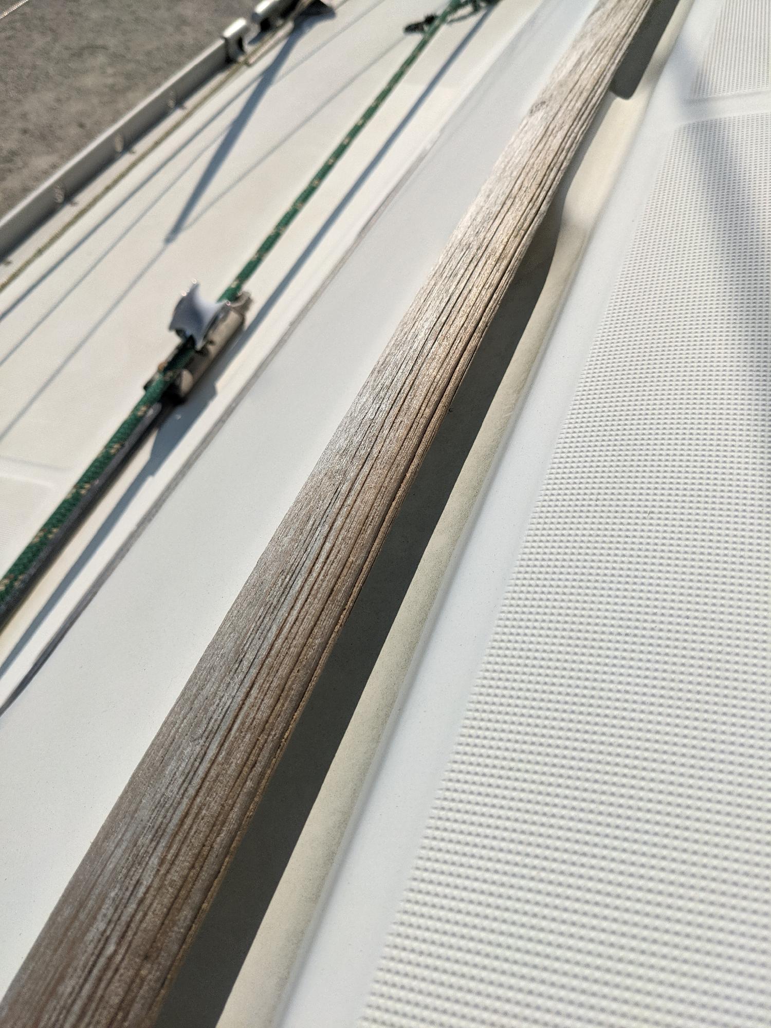

And, for the win, here's my trim.
I'm having the worst time uploading this image. I had to email from phone to computer, reduce the size, and finally, finally, it uploaded.

Did the handrails & grab rail on the companionway slider differently as those pieces are solid teak. Removed them from boat and sanded them until grooves were eliminated and surface smooth. Coated with one coat of cetol natural and approximately 3 coats of cetol gloss. Lasts 3 years before light sanding & recoating with gloss.

wow those black stripes are caulk? Mine feel like hard plastic strips which extend above the wood. I was debating if I should sand them down to be even with the wood so not to leave unsightly lines on the bare rumps of women inclined to wear thong swimsuits. (Visual intended).

Black stripes are definitely caulk. When I refinished mine I just wanted it to look better & preserve the teak. Your tush dilemma presents a whole different issue. You’re on your own; may have to refurbish both teak & caulk or buy some cushions !!!

I think I'm going to ignore everyone's advice and start with linseed oil. That wood looks awfully dry to me so I'll see what I can do to rehabilitate it before I clean, sand, and seal.
Still going to have those deep grooves remaining, resulting in more crud accumulating. Cleaning & sanding is the only way to eliminate that problem.

I'll get to it. I just don't want to remove wood that could be reclaimed.
I mostly wanted to get these sealed before any deck paint as I'll never get the paint out of the wood.
