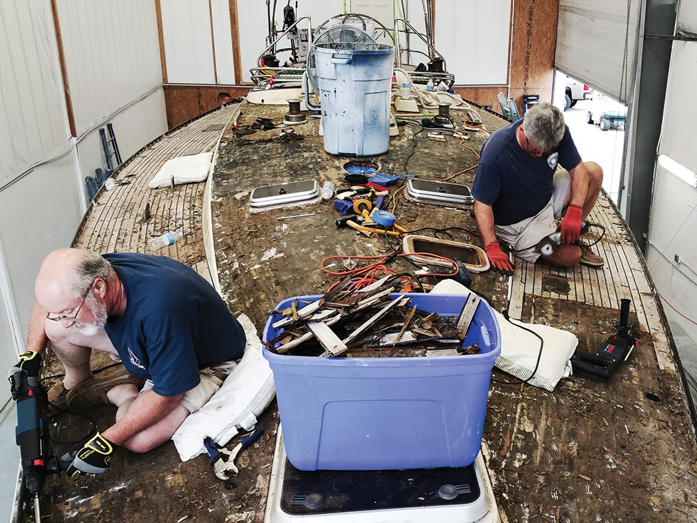

Does anyone have experience removing a teak deck and replacing with non-skid fiberglass? There are a couple slightly older boats that I may consider that have teak decks. I'm just curious how brutal of a job this is to do yourself and/or how much it would cost to have it done professionally for a ~30 ft boat.
May 27, 2004
2,059
Assuming the teak is screwed to the deck, how much would someone charge to remove a thousand old screws? Don't forget to include time to drill out or wrestle out the broken headed screws (perhaps 30% of them). There are several You Tube Vloggers who have undertaken this chore.
"Learning the Lines" did two episodes on that very topic last year. "Sail Life" is another.
I think he did at least two episodes as well a year and a half ago.
Their work will give you a sense of how big the job would be doing it yourself.
Have Fun!

Yeah..it's a huge job that I would probably not undertake myself. I've been doing some digging. For a 30ft boat it appears that the typical price to have it professionally done is ~$30K.
You have done the research, Phil. 30K sounds like a solid figure to me, to apply to any potentials with aged teak veneer deck over a cored fiberglass deck.
It would be a laborious job and likely include re-coring and tons of very detailed work. You're building a new fiberglass deck essentially. If it turns out to be less of a task, that's a win for you.
With your budget, I'd keep looking.

This guy does an excellent job of documenting his teak deck replacement starting here
Of course the big secret in removing teak deck is the often need to replace the deck core next.

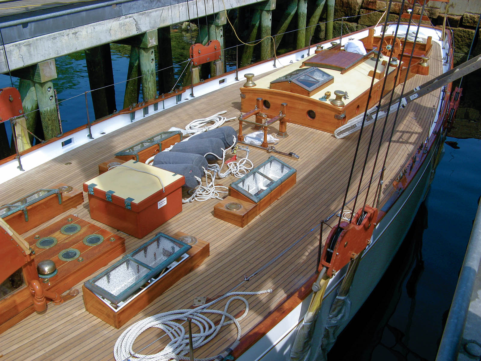

Wow, you have a real teak deck, Jon. I was thinking you might when you mentioned the condition. That makes total sense and for Molich, that was just the industry standard at the time. Your deck may well last another 50 years before it needs replacement.

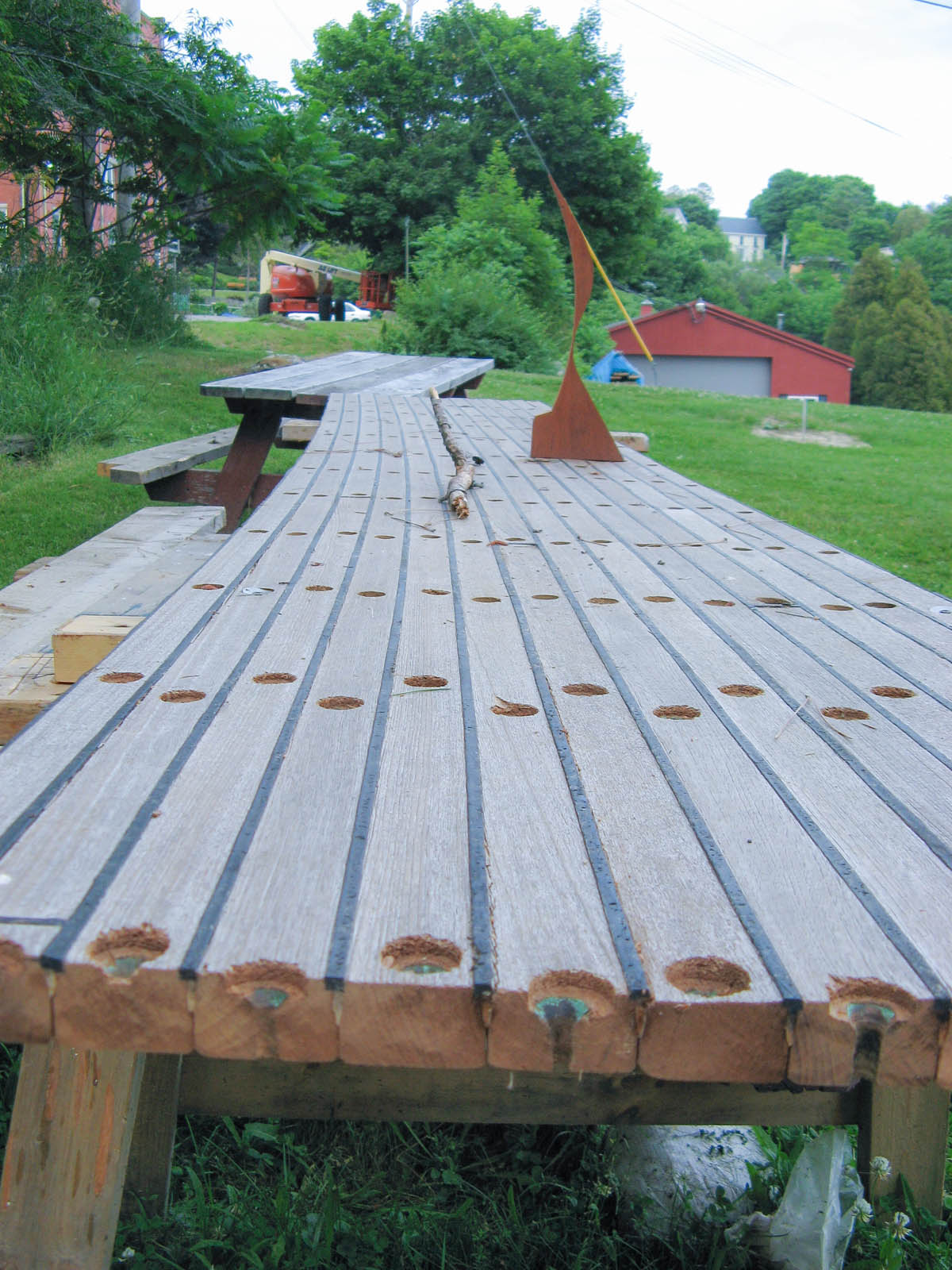

This is a section, just removed, of the real teak decking on the schooner BRILLIANT several years ago. She saw 10 times the use our boats will ever see sailing year round all over the world with daily foot traffic of a big crew. At this point, these decks were 75 years old. The decks have finally worn down enough that the wood plugs are loosing their holding depth and the caulking recess is getting a little shallow.

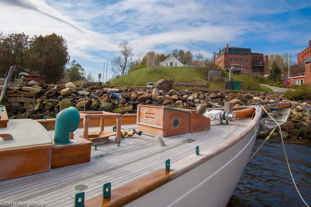

They use other woods today for decking. This old sardine carrier was rebuilt including new decks and launched this season in our harbor. She has pine decks. The owner and master builder was telling me the decks are 2 1/2" thick and pine was often used for ship decking on rough and tumble work boats in the past.
The pine he used is not what we think of when we reach for a piece at the lumber yard. It was hard to find old growth that only a few boat builders can get a hold of. It'll last more than a century I'm sure.

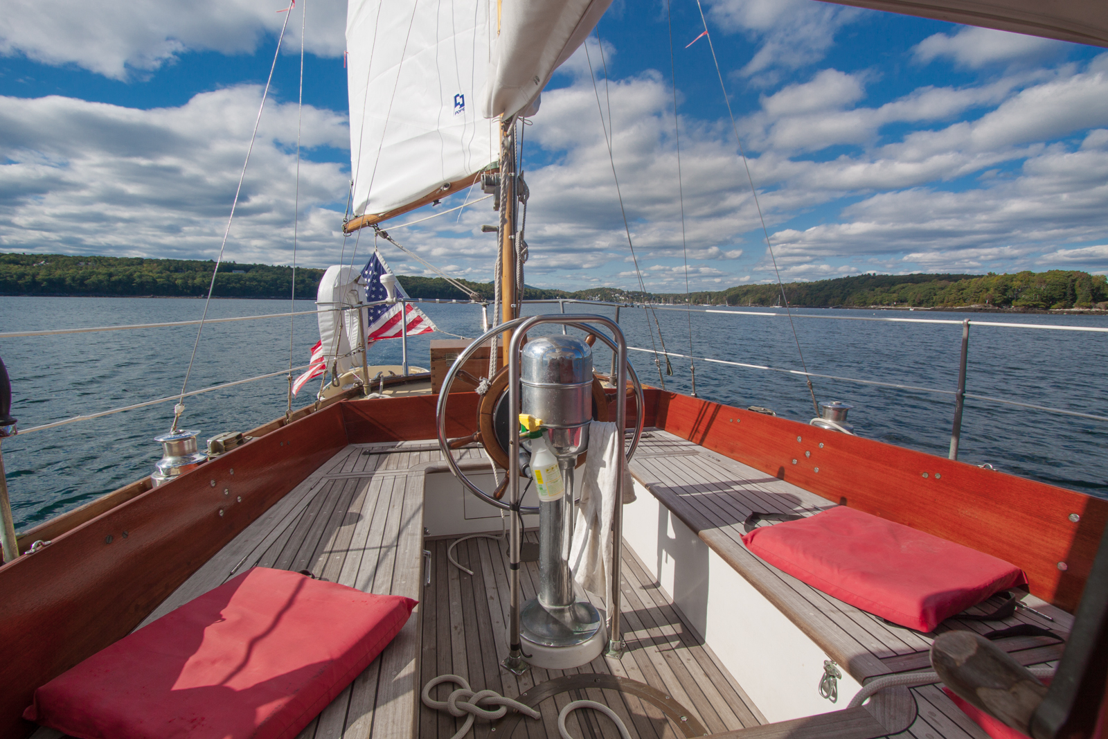

When I built my cockpit a few years ago, I used Ipe for the veneer decking. It was 1/3 rd the cost of Teak. It seems to be holding up fine. We dropped an entire small bowl of olive oil on the sole. Jon's right, I suspect it will take 10 years to bleach out. Oh well, we love olive oil,...
