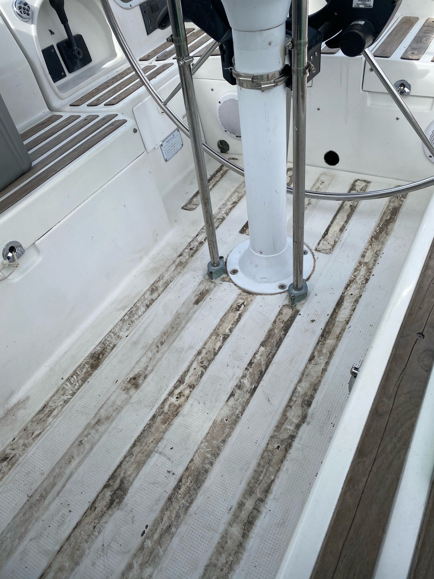

Last year my wife and I purchased a 2000 Oceanis 461 and have done a number of upgrades. One of the last that she needs is either replacing or repairing the Cockpit teak panels as they have started to lift and desperately need some TLC. I have removed the transome scoop teak panel and have brought it home to see what I can do to repair. Before I dig in, I was wondering if anyone has experience in either replacing or removing and refinishing these teak panels? Any help would be greatly appreciated.

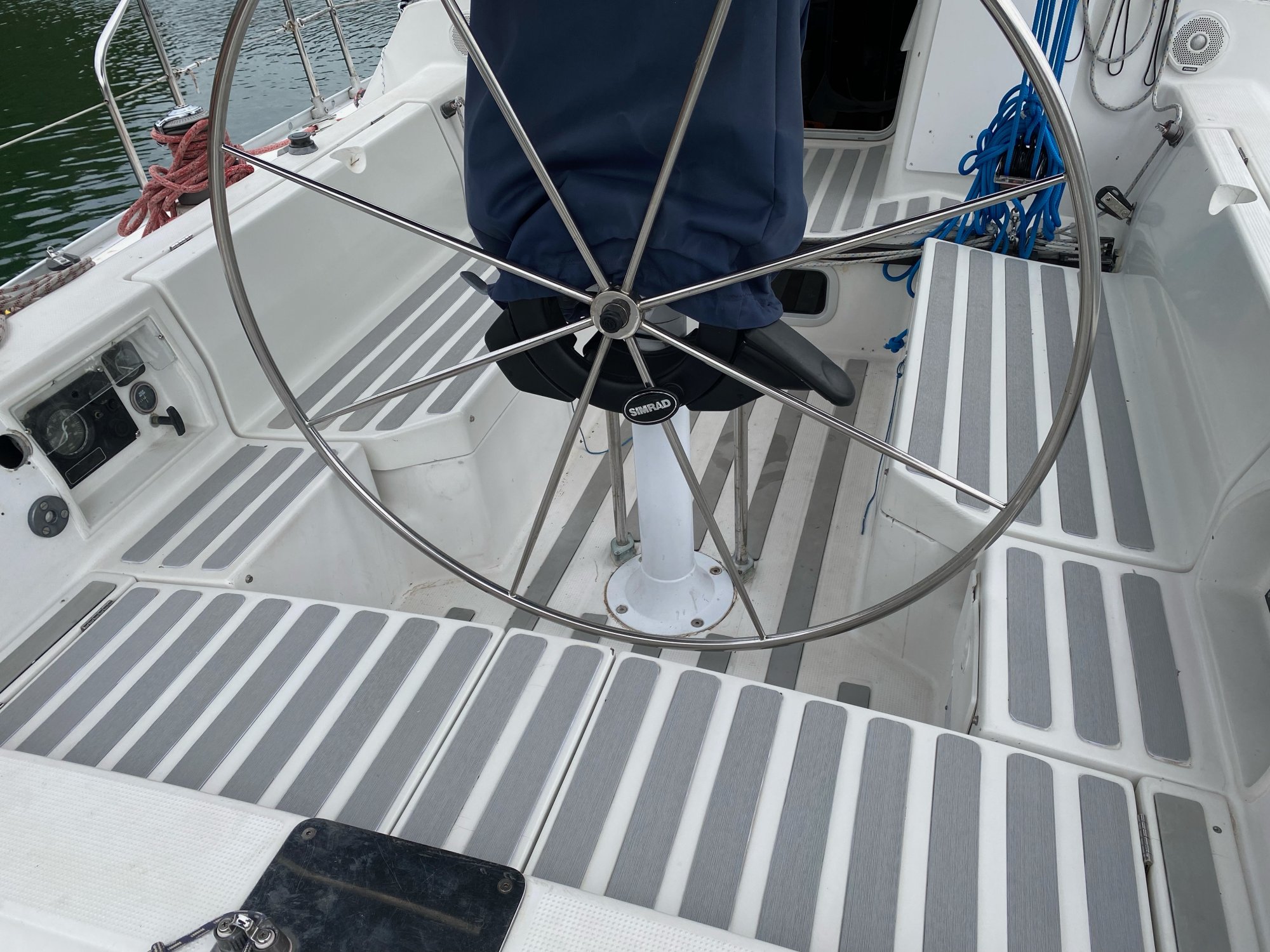

Our Bene 35s5 had the teak slats in the cockpit, many of which were cracked/broken/missing. Since the molding had recesses for the slats we chose to replace the 'slats' with a peel & stick rubber material. This same material is available in 20" wide in a "plank and groove' format.
Been a couple of seasons and still looking good...
Available in a wide variety of colours including 'teak'..
