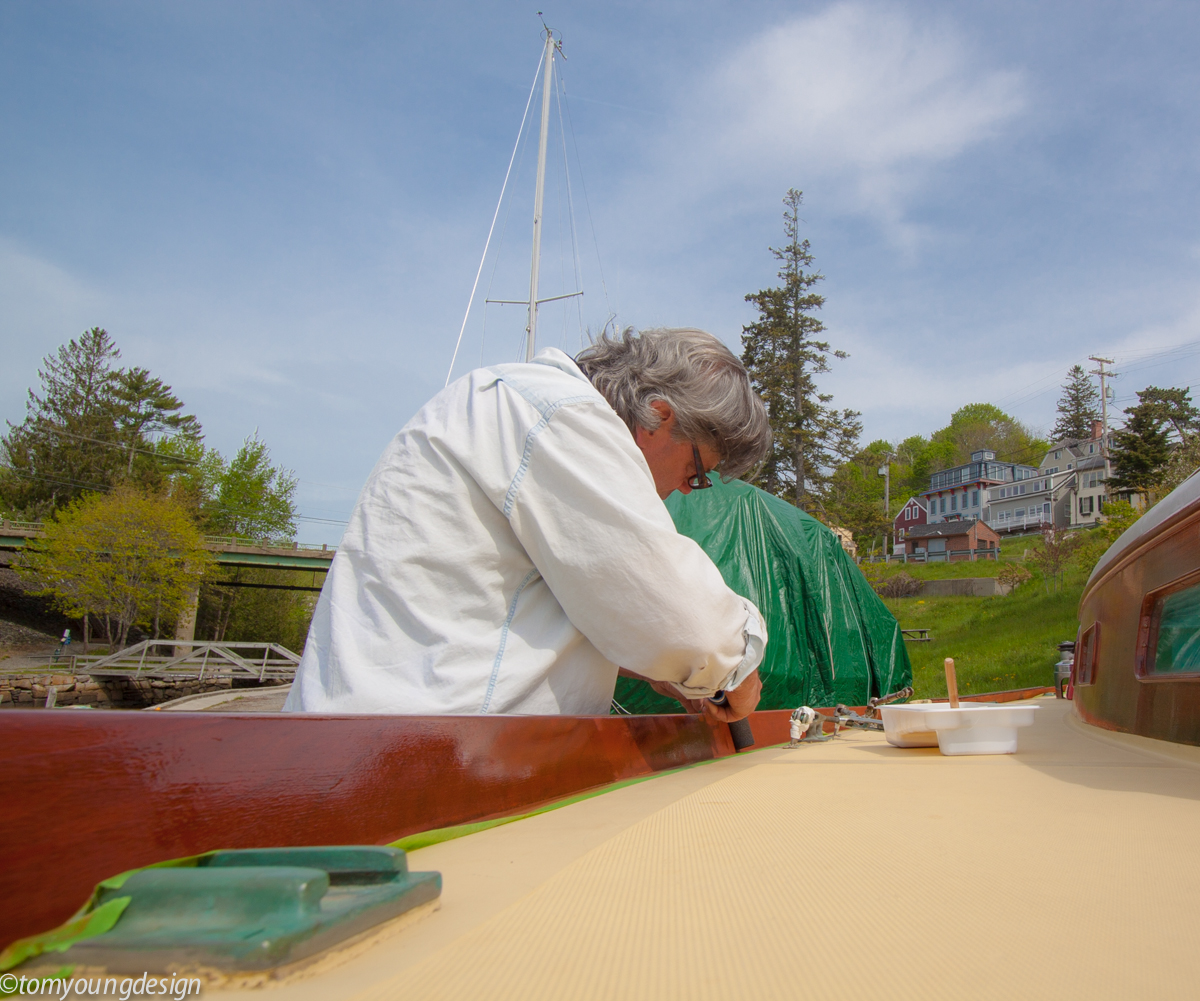

Most important thing I would do is put several coats on the cap rail, all sides, before installing in bedding. If it's well sealed (any coating), the bedding and the coating system will last a long time. If this is done, you should never have to remove those caprails again.
Whether you use epoxy or not, if you varnish, Al has the best advice: Use a foam roller.
Roll and tipping will lay on a more uniform coat of varnish than you'll ever do with a brush alone. And it's those uniform coats of spar varnish, plus a maintenance coat or two each spring, that will give you the longest life of the system. Your base needs to be thick enough to last and protect (from UV), the wood.
Cetol will protect the wood just as well and doesn't require as many coats. But you'll want to maintain that coating same as any coating, the get the longest life out of it.

D'Arcy's cap rails, like the boat I posted (not mine and no epoxy under those, I'm sure), are challenging to protect because they are flat to the sun.
I'd recommend just what you said: Do the maintenance of an annual coat, no matter varnish or cetol. Make that task easy with a good staging plan that puts your hands at a comfortable working height.
The spar varnish system has protected these toe rails for 60 years.
