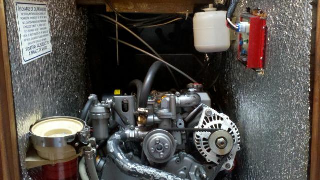

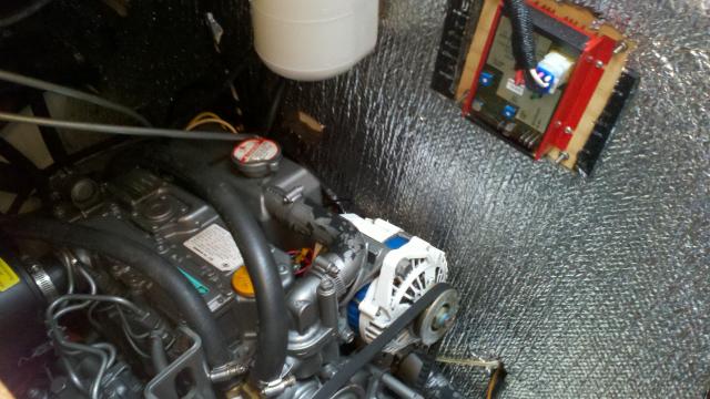

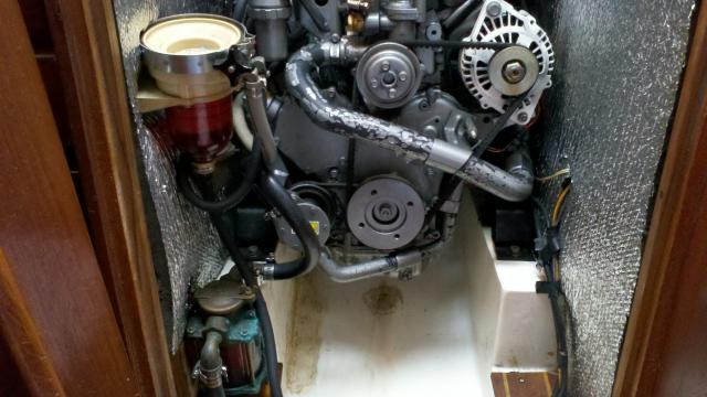

Not sure I ever posted pictures of my "engine room" so have added them here. My 80 amp Balmar and the 3-stage regulator are the only changes from original. Well the 3YM30 too of course.

Ed: Very clean and attractive engine space. Is it just the photo angle or are you space challenged horizontally in there? On my H36, with the 2QM20, I've got a reasonable amount of clearance between the engine and the port side bulkhead. And the starboard side is quickly removable. Are any of your engine room walls removable?

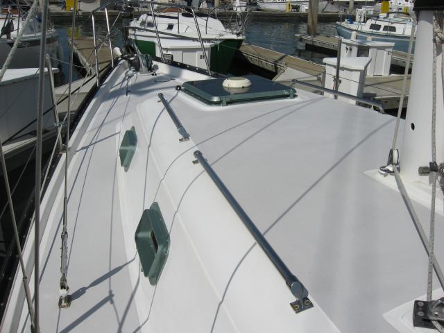

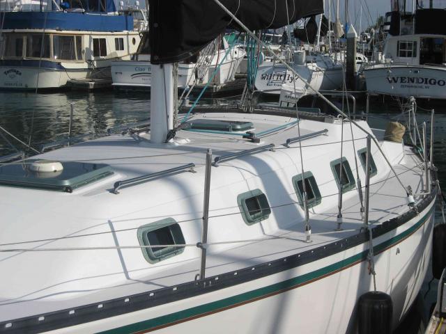

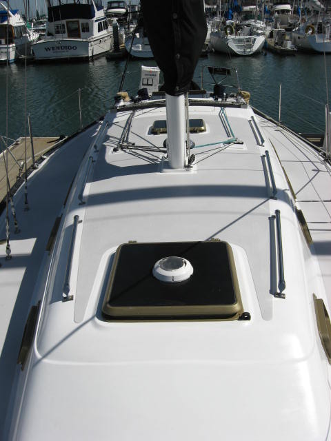

I originally removed the teak handrails because the cabin top gelcoat needed painting (I used Interlux Perfection by brush). Also the purchase surveyor suspected core rot at the most forward area under the hand rails. Turned out this area is hollow by design. With the teak already removed, and that I knew I wouldn't be too enthusiastic about doing bright work every couple of years, I decided to go the SS route. The teak rails were just wood-screwed into the FRP and into the wood core (which I now know is plywood squares). So I just repeated the same to fasten the replacement stainless steel handrail fittings. I did fill each hole with epoxy penetrating solution to provide some moisture ingress protection.
With two screws for each of the end fittings, I would expect that this installation would be comparable to the teak handrails.
As to where I got them. It's just off-the-shelf stuff. The rails themselves are 1" SS tubing which I cut to size with a hacksaw. The end fittings are 60 degree angles types. I got them at Svenson's Marine in Alameda, CA for about $8 each. (West Marine this year is charging $28 each!) The only difficulty (and not much of one other than time) is that since the cabin top surface is curved, the bottom of the fittings needed to be ground concave to match.

Recall that one of the reasons I made the switch to SS rails was because I needed to repaint the cabin top. So with the teak rails removed, it was relatively convenient at the time to fill the (teak rail ) holes with epoxy, fair smooth and then paint over along with the rest of the cabin top.
In your case, you aren't painting your gelcoat. So you would need to fill the existing holes, fair (without damaging the adjacent gelcoat), prime, and then try to match the final color.
Considering these extra steps, and that you are well along with your teak refinishing project, and that newly finished teak really does look good on a boat --- don't get diverted by my SS rantings.
As part of my cabin top repainting, I also removed the teak eyebrow trim which was split in a few places and who's mounting screws probably needed removal and rebedding anyway. Consider that if the eyebrows remain on your boat, this traditional feature might visually clash with SS hand rails right above them.
Re your website link. The fittings I used have a 60 degree angle (from the horizontal). The is important so lines (such as the jib sheet) ride up over and don't get snagged. The 90 degree end fitting illustrated on your linked site I think would not be suitable. Also consider that the site's SS grade may not stay rust stain free in a salt water environment.
Re the length of each sub rail. On my boat, the forward most of the three (on each side) is shorter, the next one aft a bit longer and the aft one longer yet. This is to provide visual balance to match the fact that the cabin top curves from narrow to wider from bow towards aft. Much like the forward ports are smaller than the aft ones -- gives balance to the cabin top shape.

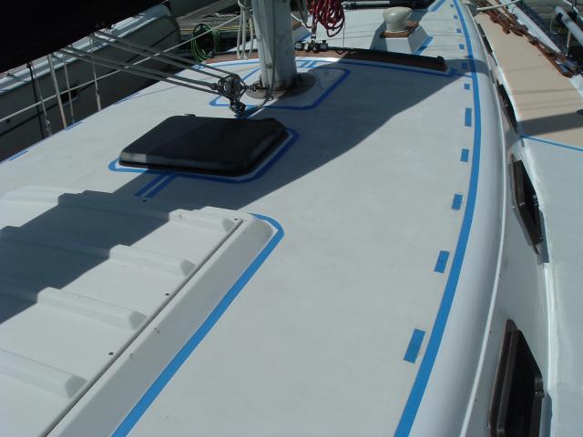

Our boats are different in that my rails mount on the non-skid. You can see the blue tape covering the mounting holes in the picture. Simple matter to fill the holes and paint over with my Interlux Interdeck. But I will continue to see how much progress I make with the teak before I abandon. Thanks for warning me about the 90 degrees, that would be a problem.
Ed:
Our different models share much the same. But I keep forgetting that much also is different.
Yes, making disappear the teak hand rail holes will be much easier on the non-skid. Also, it looks from you picture that you would have little if any surface curvature to deal with, regarding the need to grind concave the bottom of the fittings to match.

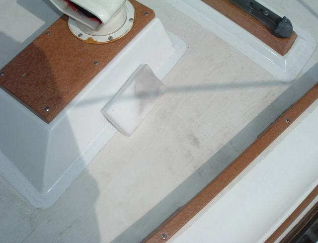

The problem with the PlasTeak is contraction/expansion with temperature changes. The longest I could buy was 12 foot so there had to be a miter joint. When it got cold the ends at the miter actually split because I had the screws too close to the ends. Then there was the color issue. Since then PlasTeak makes a darker and more teak-like color. I love how it turned out as dorade lids and forward traveler base(pictured above). I wish I had time to do the same for the aft traveler and winch pads.

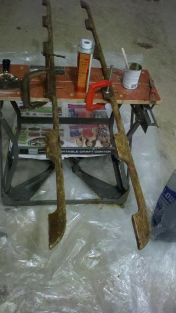

As for handrails I just did my last bit of scraping on the short ones. They are drying in the driveway before I tackle with the sander. Rardi, your second from the front handrail is right where my traveler is located. I have to have one forward of that and then two behind. Currently the front one is 5' 8" feet and the long one is 10'. But I think that I can get away with three four-footers per side. When I study what is available I see that 304 stainless is strongest but 316 is less prone to staining. The 316 is almost twice the cost so I guess I answered my own question. :)
