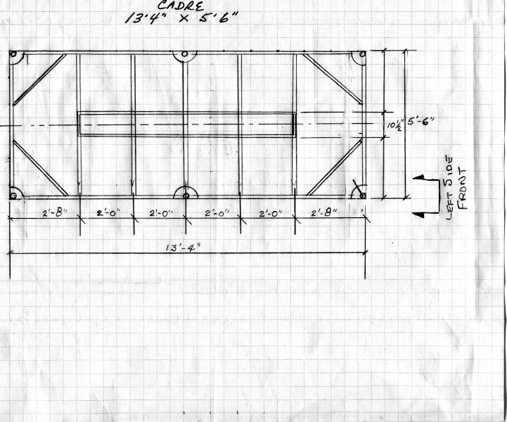

Hunter 34 cradle
Not sure if this will help but here's a plan for a Hunter 34 cradle. It's built out of 6" channel.

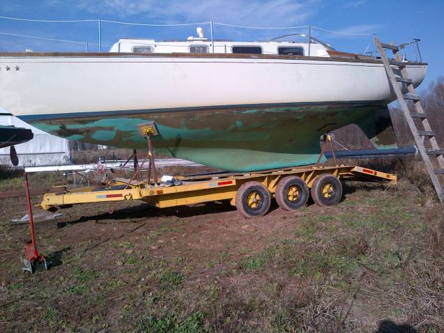

A little clarification
Thank you for the helpful suggestions, I forgot to mention in my initial post that the boat is in the water at the moment, and the next time it will be out, I am hoping it will be on this trailer.
I am wondering how high I should make the posts, and how far apart for width. I am planning to land on the bulkheads. Cheers

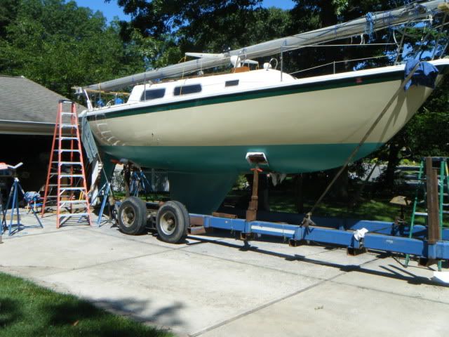

I expect you already know this but you want as little weight as possible on the side supports. The keel carries the weight. The side supports are just to keep her from tipping over. When you park your trailer try to get it level so the boat isn't leaning hard one way or the other.
Carl
Oct 2, 2006
1,517
Jboat J24 commack
Jack-stand builders like Brownell know EXACTLY which stand will fit under pretty much every boat ever made with PLENTY of adjustment
And all the older sailboat moving trailers also use them to fine tune
The BIGGEST issue is the keel has to be about 8" to 10 " off the ground MAX as even with 4'5" draft i knock way more tree branches then i would like
