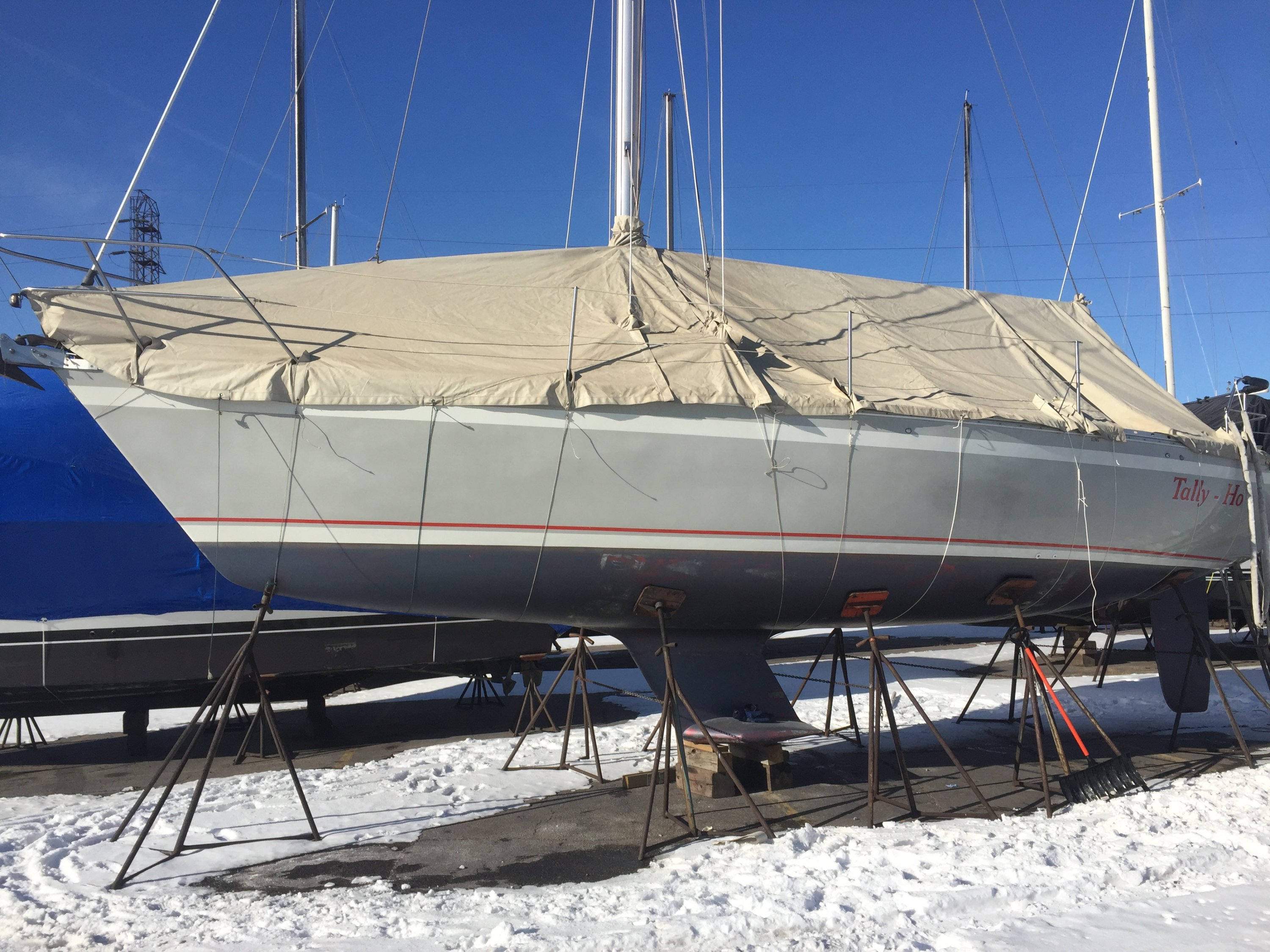

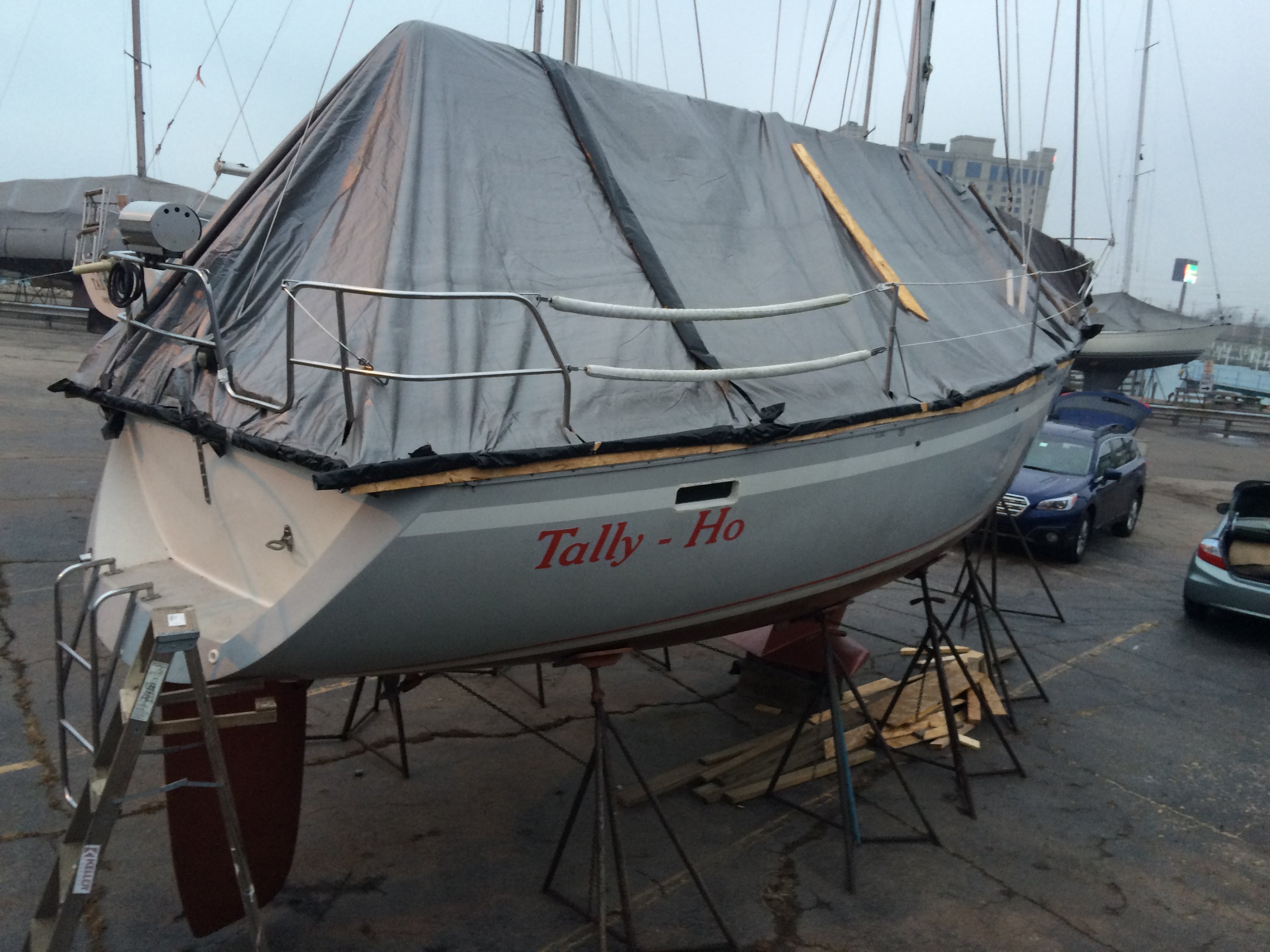

I did the tarp thing the first year I had my O'Day 322. Bought a custom-made tarp the second season.
Getting a frame or something to attach the tarp to took a lot of work (I used wood all around the perimeter and screwed the tarp,down with some battens. Also had to make an A-frame to support it.
It was UGLY and took a lot of work to put it on and take it off. See videos. The tarp was pretty much trashed after 1 season.
The new tarp is easier to install and remove, and seems to be holding up pretty well. Costly to purchase (about $1,200 IIRC).

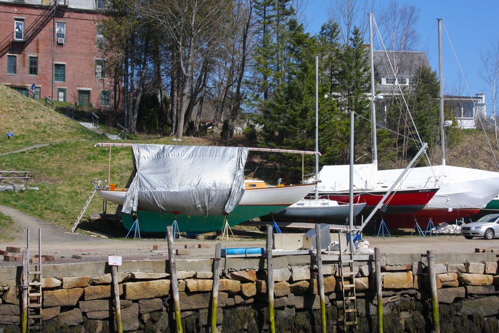

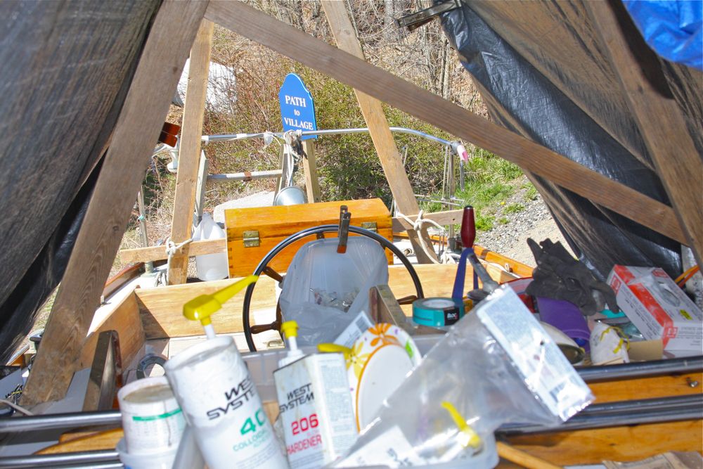

This has worked well enough for a decade +. It's simple, just a 3 piece ridge pole and 4 A frame supports. This system works because my bronze stanchions slip in and out of bases for easy removal.
Goes on fast! I do it alone in about a half a day. Unconventional - I buy 30x50 tarps to run down over the topsides well below the waterline. As well as tying under the keel, the tarp is held by the jack stands. The main reason it holds up is the ends are rolled up between 2 2x's scraps that are screwed together. That captures the hull like a net. It's quite rugged.
The tarp is loose enough to allow air to move over the topsides(I once had awl-grip bubble from shrink wrap incorrectly covering the topsides tightly-don't let anyone do that!), but there is no chafe as grommets etc, are below the waterline.
On the harbor edge the boats are exposed to 50 -60 knots(the most I've seen in winter). Wet snow will stick to it and catch at the toe rail so it's not 'maintenance free', but close to it. I live very close to keep an eye on it.

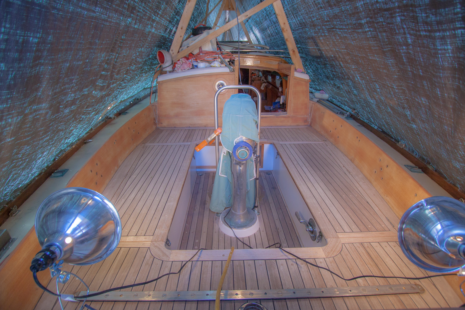

This cover is a good compromise for doing some off season work. In the early spring the solar gain below can make it quite pleasant to get a jump on something that needs doing(like this: restoring cockpit coamings).
Cons: if the wind is blowing you will go insane after a short time inside. The tarps don't last that long if you want to stay dry below(2 years avg). But as a builder I recycle the tarps for multi purposes before they are disposed of.
Pros: In spring you can easily un-roll the bow or stern to allow working below in warm(not blistering hot) dry conditions. Then easily roll the cover back out to allow coatings to dry in the cool moist spring conditions we deal with here in Maine.
