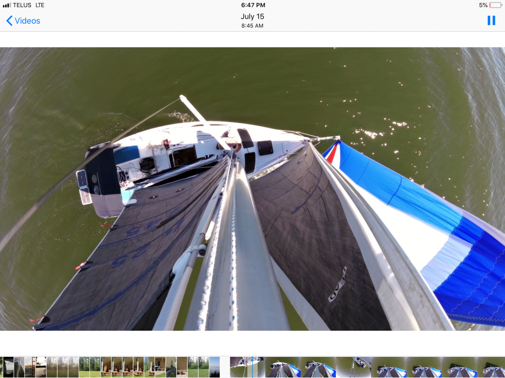

Wondering if there are any performance benefits with tapered vs. non-tapered battens on a full battened main? My new laminate (full battened) main has non-tapered battens which work well to hold an effective foil shape at moderate and heavy winds. However, during light wind conditions, I would like to see more draft forward by slackening the outhaul, but the stiff battens prevent that. Just wondering if tapered battens would allow more draft forward during light winds and provide some additional power?
