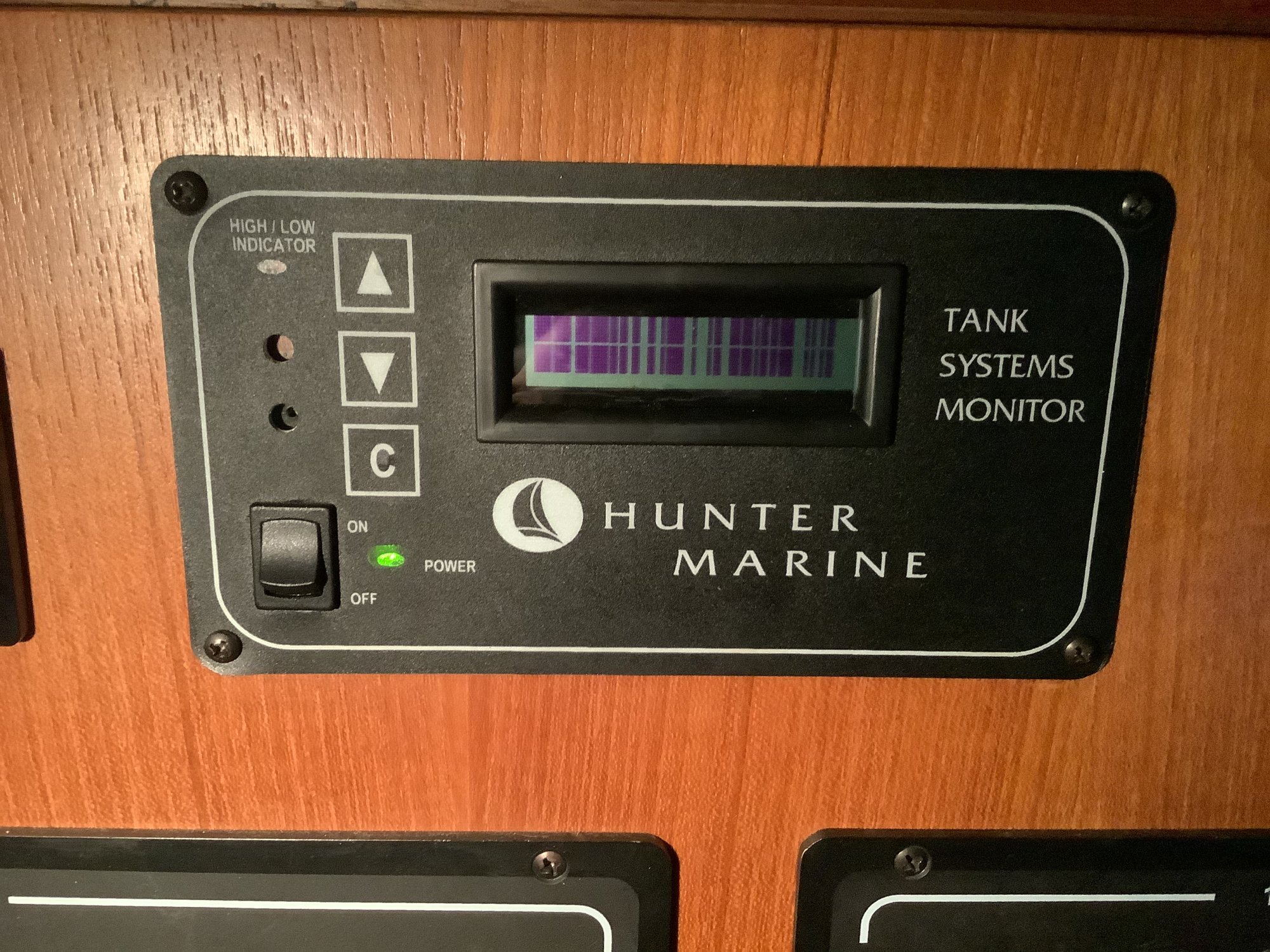

That unit looks like it's toast. Maybe some nearby lighting?

Probably only the LCD panel is ruined, not the sensor. If you're particularly handy, patient, and can find it, you could substitute another display panel. Alternatively, replace the system. I found the SCAD system with paste-on sensors on plastic tanks to be reliable and fairly accurate.

New Providence Marine create a Snake River compatible tank monitor. I haven't bought one yet, but they said that you can simply replace the panel and use the same senders that you have been using.

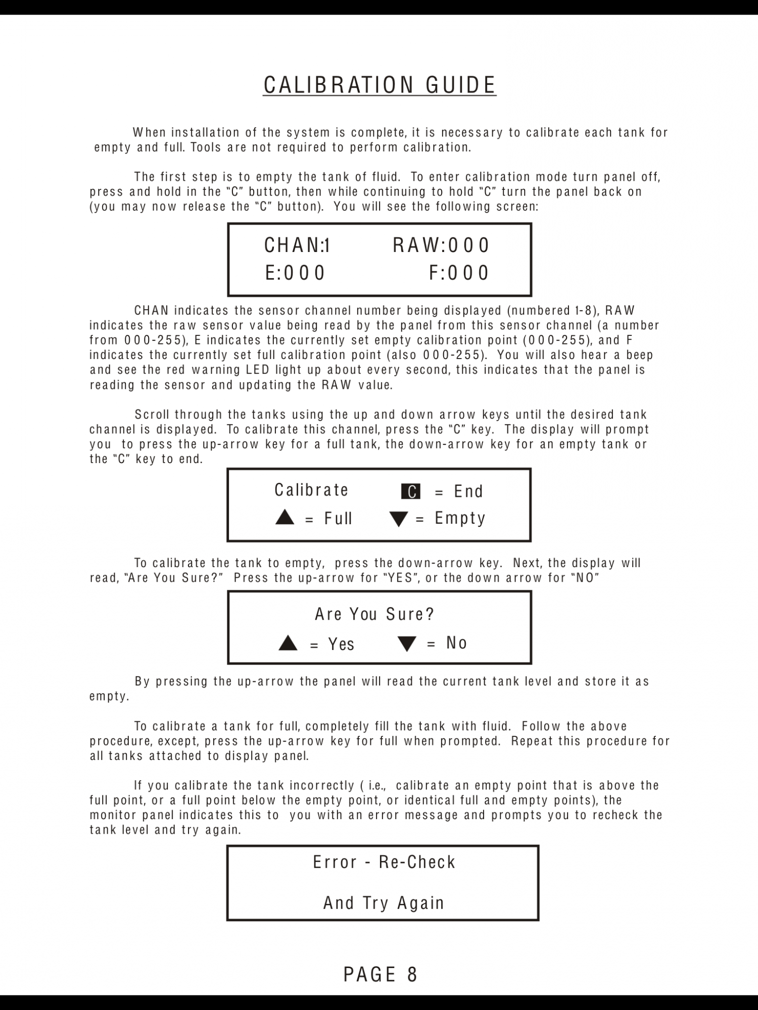

We had the same Tank Monitor as you. After purchasing the boat, I noticed that the buttons and LCD were shot. I replaced with,
After installing, I still had problems. Our sensors/tape had rotted off. I ended up ordering in the sensors from Tech Edge, all good.
Sep 11, 2019
168
Hunter 386 Lake St. Clair
Yes. You just have to have the tank empty then fill with water or vice versa. Easy peasy.
