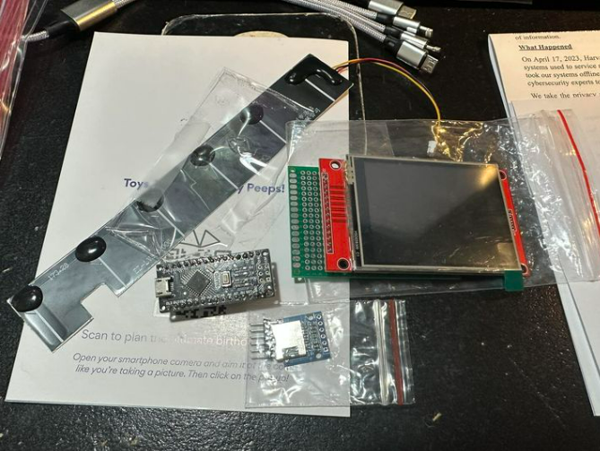

I'm working on my own because I don't like the RV style systems that are out there for $400.
I found a source for stick-on-outside liquid level sensors, and I've been working on my display... When I'm finished, (it might take a while to fully test, tweak, and package) I may make some more and sell them to whoever wants them.

Hi Peggie,
Yes, I've looked at them all. None of them are really perfect. I need three tank monitors, and I'm not crazy about the display panels they all make. They are very RV-like or antiquated.
I plan on making a 4x3 square panel (surface mountable) with a 2.5" graphical display, and an HTML WiFi interface as well to go to your phone. I might even put a noise buzzer in there for a warning indicator.
I am using these 7" flexible 6 segment liquid sensors for the tanks. Simlar to the SCAD and SEELevel.
