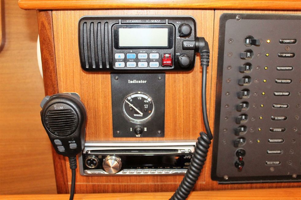

1...Turn breaker on ...no reading from either tank position
2...Both
3...Not sure on brand but is Standard issue from factory seen on other Hunters

But all that aside, we're off to the races. The Brand of indicator is a WEMA which is a UK company. The most likely level sensor (located in the tank) is a float mechanism which changes the resistance of the sender as the position of the float rises and falls. See attached.
Before you proceed with removing the sender from the tank, I would suggest checking the meter (what you read) for a 12V power supply. From what you have described, this may be your problem. Let us know and we'll go from there.

Thank you....running the boat home in a few weeks.... will troubleshoot and report...I was thinking it may be a common problem....All Good Ralph...
