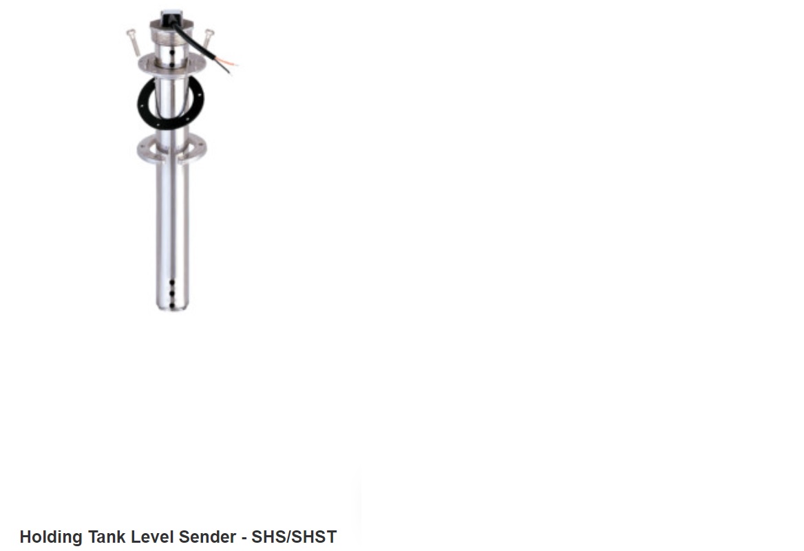

Kus Industries makes reliable reed/magnetic sensors for fuel, water, and waste tanks.

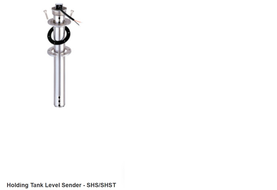

I really hate to to piss on your cornflakes after all the work you've done, but their "reliable reed/ magnetic sensor" is actually a "switch". It is NOT a sensor. It is a switch which reacts to a moving sensor (a float). It's this little float which kills all holding tanks which use a moving sensor:poop:. Think WEMA holding tank gauge. Same thing.
Notice on their holding tank sensor, the three vertical filling holes at the bottom and the three air vent holes at the top. Works on a float and it doesn't take long for the bottom holes to plug.
Only a gauge which works on an external sensor will last in a holding tank ................... unless you want to clean out the little holes every few months.
Yes your info is correct. I am aware of how the KUS/Wema sensors work. If you read the installation instructions they recommend the the sensor does not reach down below half the depth of the holding tank. Most of the solids will be below that level. Using holding tank additives like Zaal NoFlex Digestor or this product from Camco (Amazon links) reduce the amount of solids in the tank.
Unlike water tanks, when you need to know they are approaching empty, with holding tanks you need to know when they are approaching full. I don't think this will be a significant issue. And if I have to clean the tank sensors once a year, that is not a big deal when compared to the effort required to install an external sensor. If it does become a problem, I can always switch to a ultra sound sensor.
