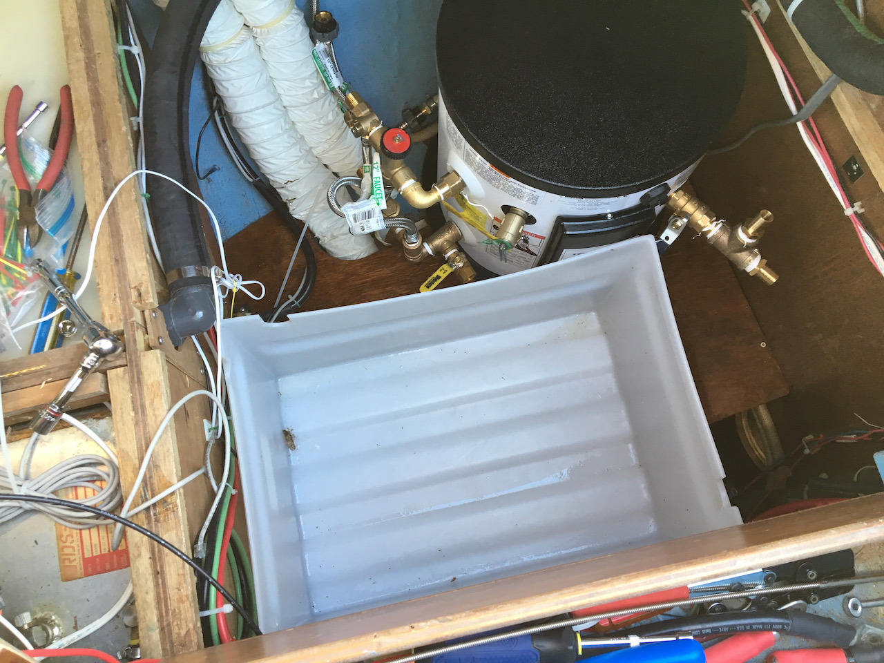

Pics of your situation might help them advise.
Found one photo that sort of shows the holding tank. It is the white tank in the upper left corner, under the wire ties. There is no clearance between the partial bulkhead and the tank and that bulkhead is tabbed into the hull. The tank extends below the floor the HW tank is sitting on.
The blue area behind the water tank is the hull.
I think Sabre started with a fuel tank and a holding tank and built a boat around them.
