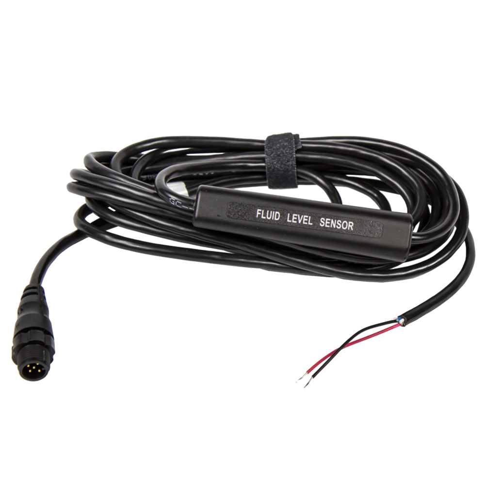

So long as the tank sensor hasn't failed there is no reason to upgrade the sensor, except perhaps to put the sensor information on the NMEA 2000 network. In which case it is not necessary to replace the sensor, a device like this one from Navico (Simrad/Lowrance/B&G). When I added tank sensors to the water tanks I used it and it works well.
