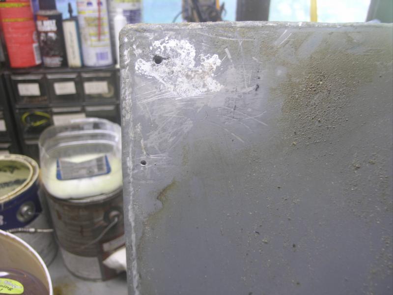

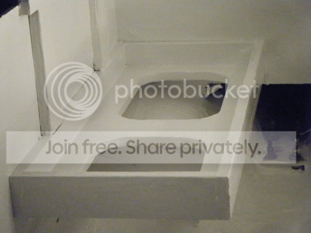

Catalina really screwed this one up, by forming the fiberglass floor around the bottom of the fuel tank and then lipping it up to create a shallow basin. This traps moisture which inhibits O2 and has caused the Aluminum to crevice corrode. So what a mess... fuel oil in the bilge. Getting the tank out was a real nightmare. I would really like to replace it with a stainless one, but $$$$. Anyone know of some sources for custom tanks?

Had not considered this option, seems a bit involved, but doable. I have a lot on my plate right now with installing a solar system on my roof and other work related projects. So this has come at a bad time. I may end up having the tank repaired (relatively clean inside and no other evidence of corrosion other than the lower corner) and then putting a drain in the basin and chocking the tank up to allow some air flow to prevent this from happening again.

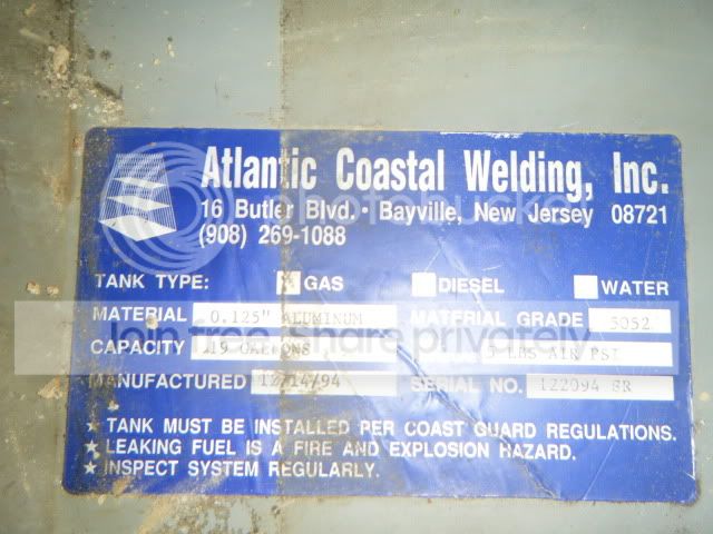

I would call it a BAD install the tank shoud be placed on plastic Or I get natural rubber with no carbon and not able to collect water
1994 tank was shot on filler neck from leaks and I needed a 90 neck to relocate the fill up to the rail outside the boat

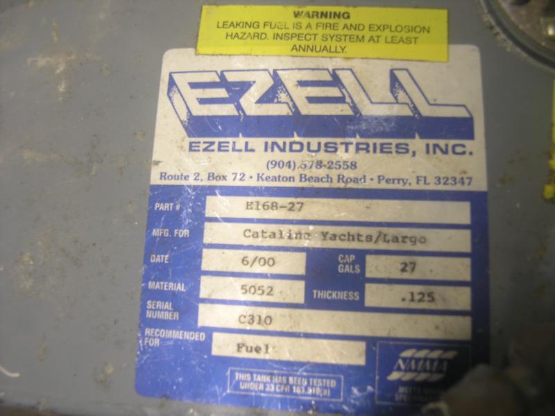

Just curious what the specs on the tag are ? Material and thickness
As I am on the third one due to the first two bad installs with the original fuel fill in the cockpit and always wet and allowing water inside the tank

Tank is made from 1/8" thick aluminum. The aluminum is grade 3052

Looks like Catalina used 5052 aluminum. 5052 will bend without cracking, probably why they use it to fabricate these tanks. I'm not a chemist and have no knowledge of how diesel reacts to different grades of aluminum. I used 6061 to make an access cover but it's gasketed with Buna N rubber.

And when you reinstall either get rid of the lip or make some rat holes so water cannot collect no matter what tank you have.

"and then putting a drain in the basin and chocking the tank up to allow some air flow to prevent this from happening again."

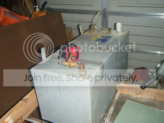

$200 to have the tank cleaned, patched and the back port corner cut off so I can get it back in.

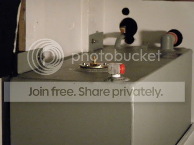

The tank was still contaminated from the re-work guy, so I washed it out again and put some paint on it.
I went to re-install and it, had rained some with the front action, low and behold there was a small amount of water in the basin where the tank goes. Looks like the hinge plates for the original swim ladder were leaking. So, I re-bead them with butyl before I put the tank back and chocked the tank up so it would not be sitting in the water if it ever happened again. C310 owners you have been warned.
