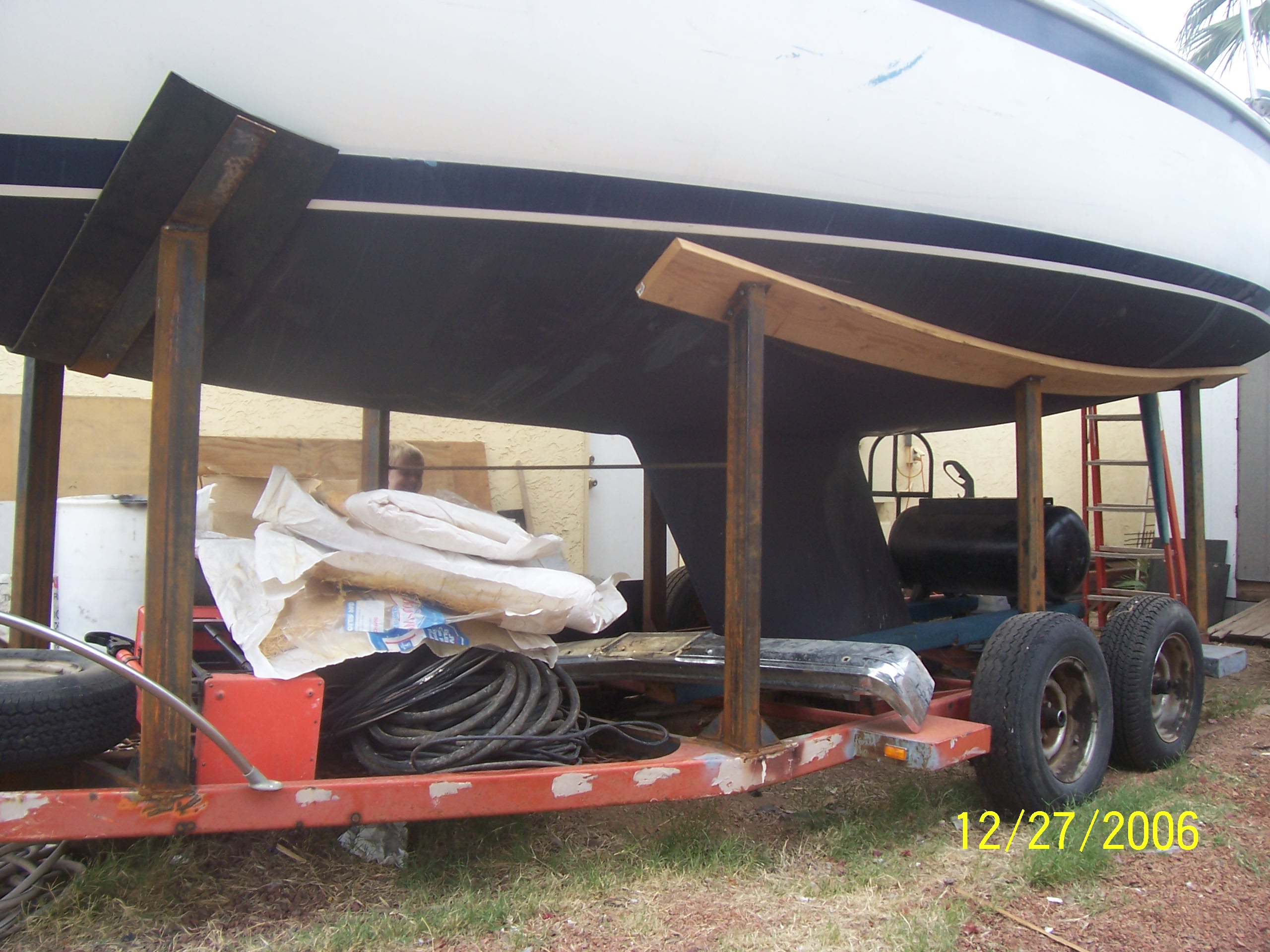

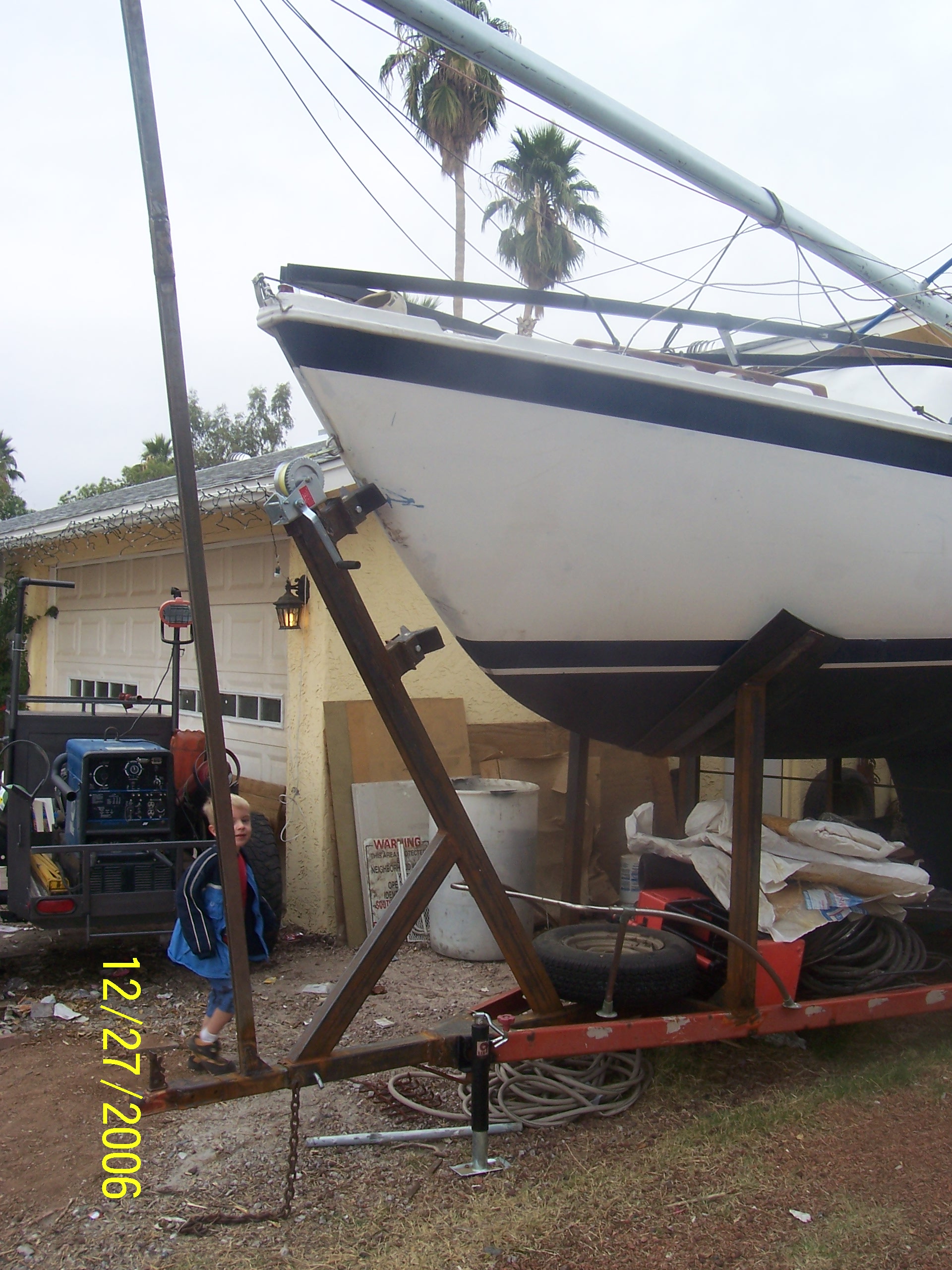

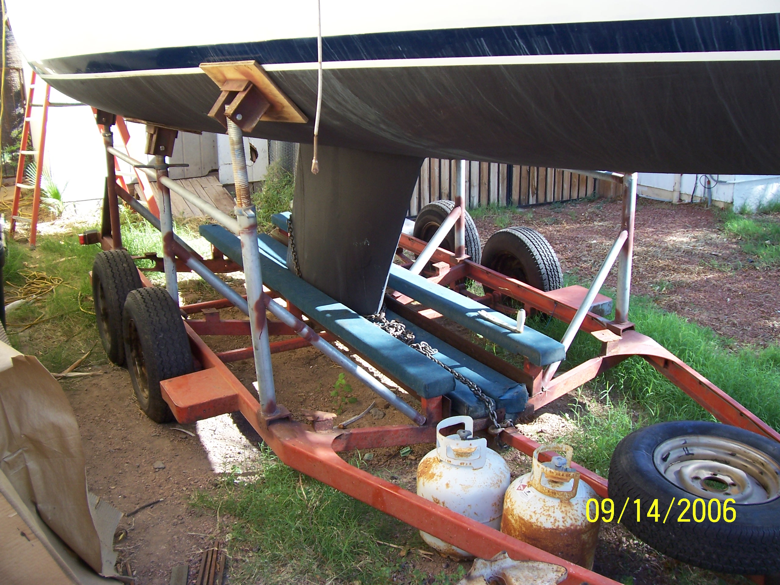

85 chevy pickup, what do I win:dance: Sand, looking at the picture it looks like you have added an extendable tongue. The only problem I have had with mine is that the inside of the outer part tends to rust and if you leave the inner part inside it can get stuck, think hydraulic jack to get it loose, paint hasn't seemed to help, grease seems to work best, but it is messy and slippery to walk on when launching. Have you had yours in the water yet, any better ideas? Tim

I just block the tires and use the truck to get my tounge loose! Then, on the way back in, I just strap a come-along to the truck and trailr and winch it back together. Had the ame experience with grease- mesy. A better answay would probably be to paint the inner tounge with a hard, slippery paint (epoxy).

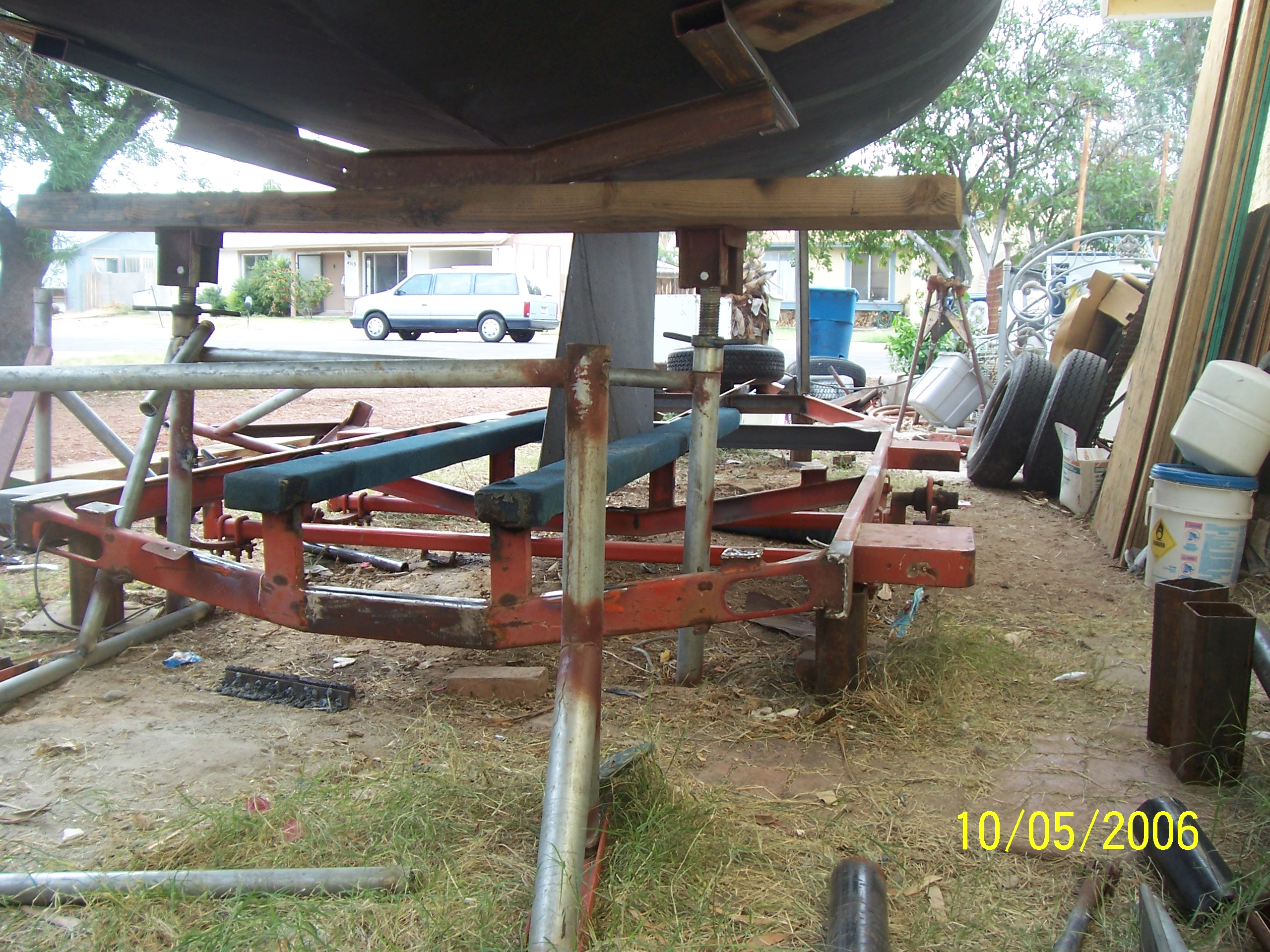

Work started today - everything is all blocked up, the old spring hangers are half cut off, and I've decided on a bolt-on susension subframe. To move it, I'll need to drill new holes in the frame, but oh well.
Hey sand sailor - what did you use as the screws for your bunk? Threaded steel pipe?
