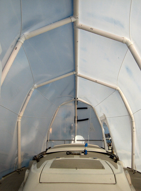

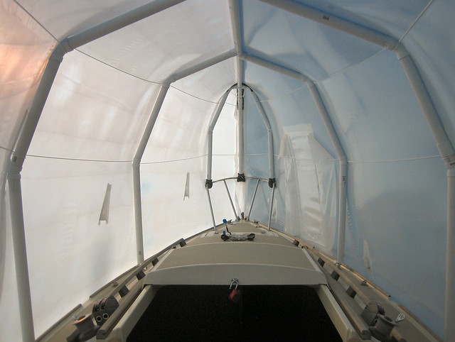

Here's my take on winter storage with an attached boat shop-
It served me well last winter. I've got two doors- rear portside and foreward starboard. Mainly to provide ventilation when working with volatiles and floating particles. Also it can get pretty warm on nice sunny winter days. This is my second year with this boat shop. I found some 2x2s with slightly rounded edges that fit perfectly into the 2" ridgepole to stiffen it. The frame knocks apart for storage. I like the shrink wrap but I'm sure something like this can be used with a large polytarp. The trouble with tarps is keeping them either held off off the topsides so they don't chafe with the wind or holding them tight to the hull. But for short term it's probably OK. And a tarp is cheaper and reusable.
Rich

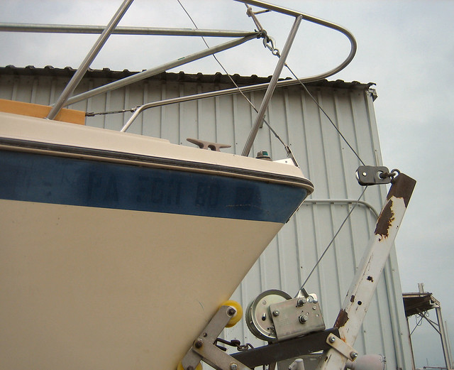

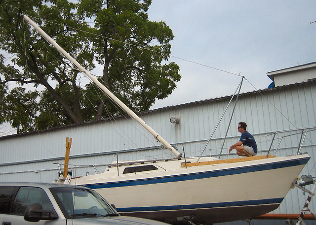

I really don't care to take the mast down forward. I know Oday thought it was a good idea and had an optional setup to do it. I feel dropping it back gives you more control and makes it easier to hook the mast base to the tabernacle.

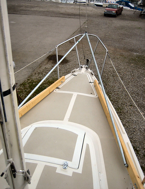

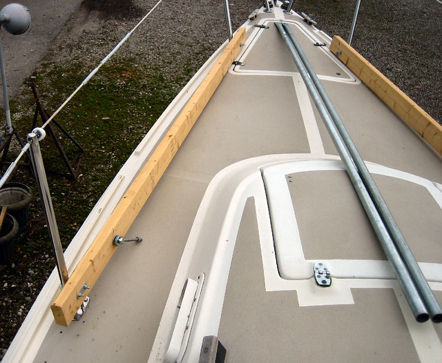

Here's the setup I used-
Using the trailer winch worked very well. But this fall I had to drop the mast at the dock so I ran a line through a block on the stem head fitting back to my primary winch. I may have to raise the mast next spring from the water also. I want to work out a way to get the mast crutch further aft because when the mast is laying in the crutch and attached to the tabernacle the spreaders are just aft of the crutch and it's unbalanced when the base is loose and you have to lift the whole mast up and over the crutch to get the spreaders forward of the crutch so you can slide the mast ahead and let it sit to rig or unrig the mast.
Using the mast to ground out a power cable can sure ruin the day for a whole lot of people.
Rich

Looks cool rich,
If I may, where did you get the mast lowering set up? if you made it, what is a good ratio for the "A frame" poles length to mase length? Or how did you decide on the lengths and location of the A frame pivots?
thanks,
keith

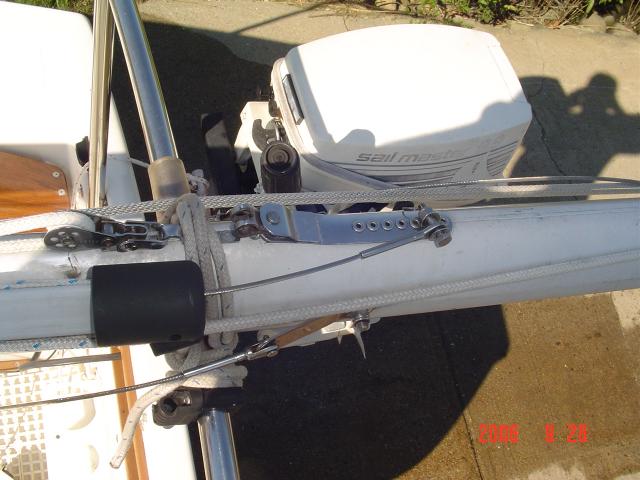

Rich

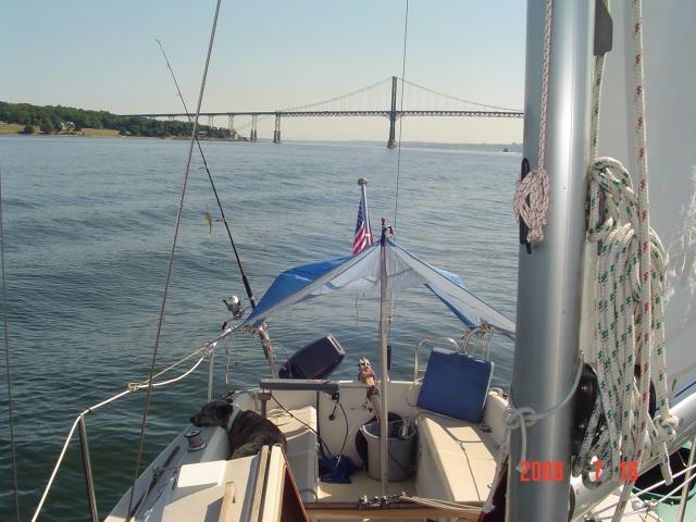

Rich, looks like Joe has his stern mast crutch with the roller on top so the spreaders don't get caught when sliding the mast fa'rd. I wish i knew half what joe knows!
How cool is his mast system?
Hey Joe, does that knot slide on the furler? Or is it stationary?
keith

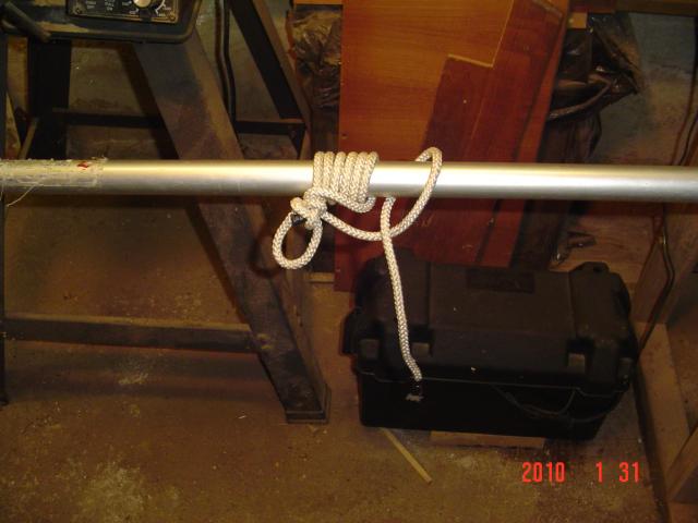

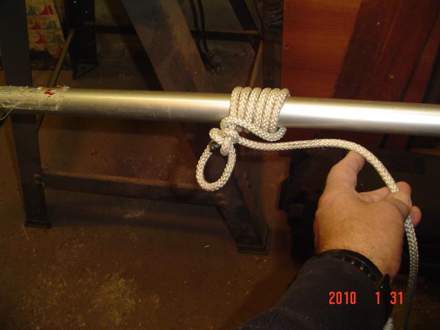

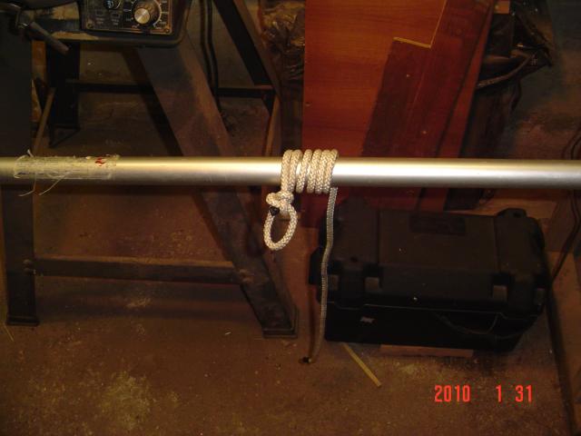

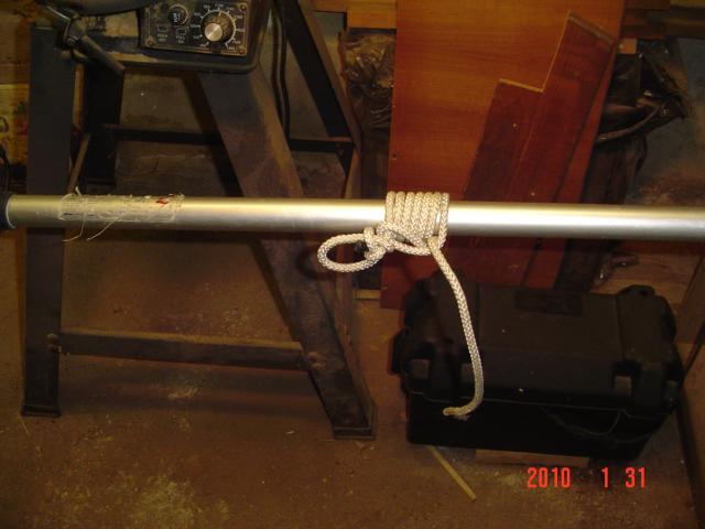

The "T" Ball fittings in my mast for the lower stays kept getting caught in the crutch roller and I was always having to walk back and try to straighten it out in order to get the mast rolled further back far enough to pin the Tabernacle. So I solved that problem by drilling another hole for the roller axle and I added a wing nut to move the roller up higher. Done! Problem solved.
Keith,
You can grab that hitch with your hands and move it up or down with ease but once you apply any pressure to that bowline, that hitch won't move. The Bowline really isn't needed in that hitch. You could tie this hitch to a round lolly column down your cellar with a Bowline on the end and use it for a foot hold and that hitch won't slide down the pole. The more weight you add to the standing part of that hitch, the tighter it gets. You can release the pressure applied to the Bowline and grab the hitch, and it will slide down easy.
You could use this hitch for wire, rope, a lifeline, or just about anything. In the summer I sometimes set up a small polytarp to my stern rail and attach the ropes from it to my lifelines with this hitch. When you tie this hitch, you need to rap the line around the object that you want to hold, away from the direction of pull and tie the two half hitches at the end of the rolling hitch. I've tried looking for this hitch on the web and it's no where to be found. With that said though, I never met a lineman who didn't know how to tie it. It's an easy hitch to learn. Give it a shot.
This pic was taken near Bristol RI harbor with the Mount Hope Bridge in the background. Didn't have much wind that day but you can see the braid lines from the tarp tied to the lifelines with these hitches.
Joe

Joe, i can't quite make out how the hitch is used to secure the furler to the gin pole.
1 Is the gin pole secured to the bowline?
2. Does the hitch slide on the furler while the mast is being lowered?
I tried to zoom in on the pic of the furler and gin pole but couldn't.
thanks for your help
keith

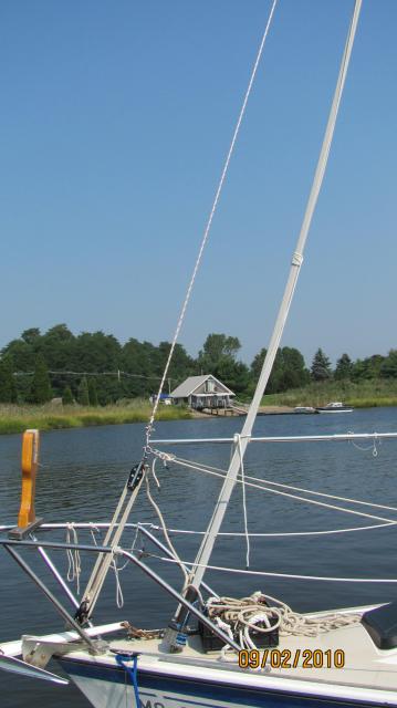

Keith,
The setup is simple and cheap. Standard Home Depot fare (except for the cable snatch block which I found on Amazon or about $20). 4- 1" u-bolts, 2- 1/2" bolts with washers for the pivot pins, 2 long i-bolts, a few clevises, 2 lengths of conduit (3/4" I think) and a couple of 2x4s. Picking the length and placement of the a-frame was easy. The pipe came in 10' lengths. I cut 2' off to make them easier to store and I mounted them forward enough to meet at the stem head.
Rich

Rich,
I like that setup a lot, but have a couple questions-
On our O'day 25, the aft side of the mast has a couple things sticking out (can't remember exactly what right now) that dig into the deck as the mast swings back. There is a nice scraped out hole through the non-skid as evidence that the previous owner liked to take the mast backward. We also installed a mast plate under the tabernacle for extra block attachments at the base of the mast, and it has a lip that bends up at the back of the plate, and I don't know if the mast would catch on that or not. Maybe not.
Probably part of it is how high the mast crutch is that you are using back at the stern, does that keep the mast from digging into the deck as it goes back?
This is all great information, hopefully we'll have a better system next year.
Wes

My mast also had that fitting at the base and I also had a hole in the deck because of it. I think it was to use the boom as a gin pole to the raise and lower the mast. I removed the sliding gooseneck setup for the boom and replaced it with that lower fitting. Much simpler setup.
Which plate did you get? The one I ordered from DRMarine wouldn't fit with the hole on the raised lip mounted to the rear so I ordered the one from RigRite. http://rigrite.com/Spars/Kenyon_Spars/Kenyon_Parts/K-1374_assm.html. The lip does not get in the way of the mast dropping.
Rich
