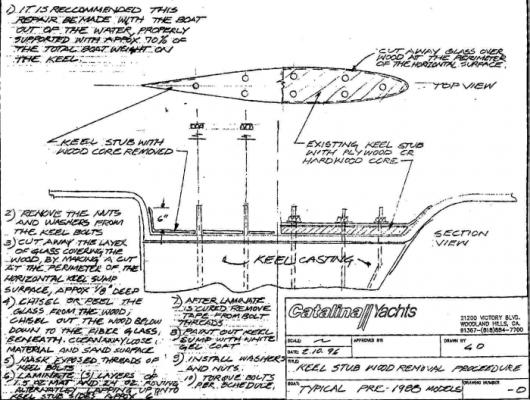

To get that keel bolt leak stopped you need to do some things. Most important are that leak area must be clean and dry.
To adequately tighten the keel bolts they all need to be re-torqued - not just one. To re-torque the keel bolts, the weight of the keel must be taken off the hull - by putting the boat on land. You also need to reseal any break in the "keel to hull" seam.
Here's a copy of the Catalina keel stub design.
